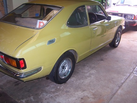

This is the KE25 i bought of Sharpie (Rob) about a week ago (pic is after i gave it a cut + polish and painted some bits).
Its got a Bigport 3K with a 2 speed toyoglide :y:
Plans are:
Firstly manual conversion, then it will be my daily for a while while i turbo the KE70
Then later on, ill give it a respray and chuck a mild 5K in it, or maybe a 7K-E with the injection :y:
Edited by Robert
Keep it original :y:
That looks stacks better since you painted it all up at the front. :y:
You missed a huge spot though. The metal guard that sits under the grille. You didnt paint it!
Edited by Raven
It seems a waste to respray it, given how shiny it is....I just don't like that colour haha
Man that car would look sick dumped on those rims and chrome dress rings... and a rear window venetian...
Would look bloody tough.. nice find man
Dan
yea i will paint that shortly, i have to take the front apron off to get it off because the nuts are rounded off and rusted :y: .
Too Quick, i would keep it original but the toyoglide is so fuking annoying.
I havent got a 7KE, but i might look at getting one later, and it is going to be resprayed when i can take it off the road for a while, i don't know what colour possibly a silvery gold. its not that shiny, your just looking at it on a good angle :y:

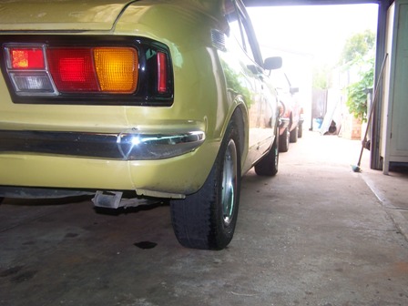

Got some 13s of an old mazda with 185s looks pretty tough.
