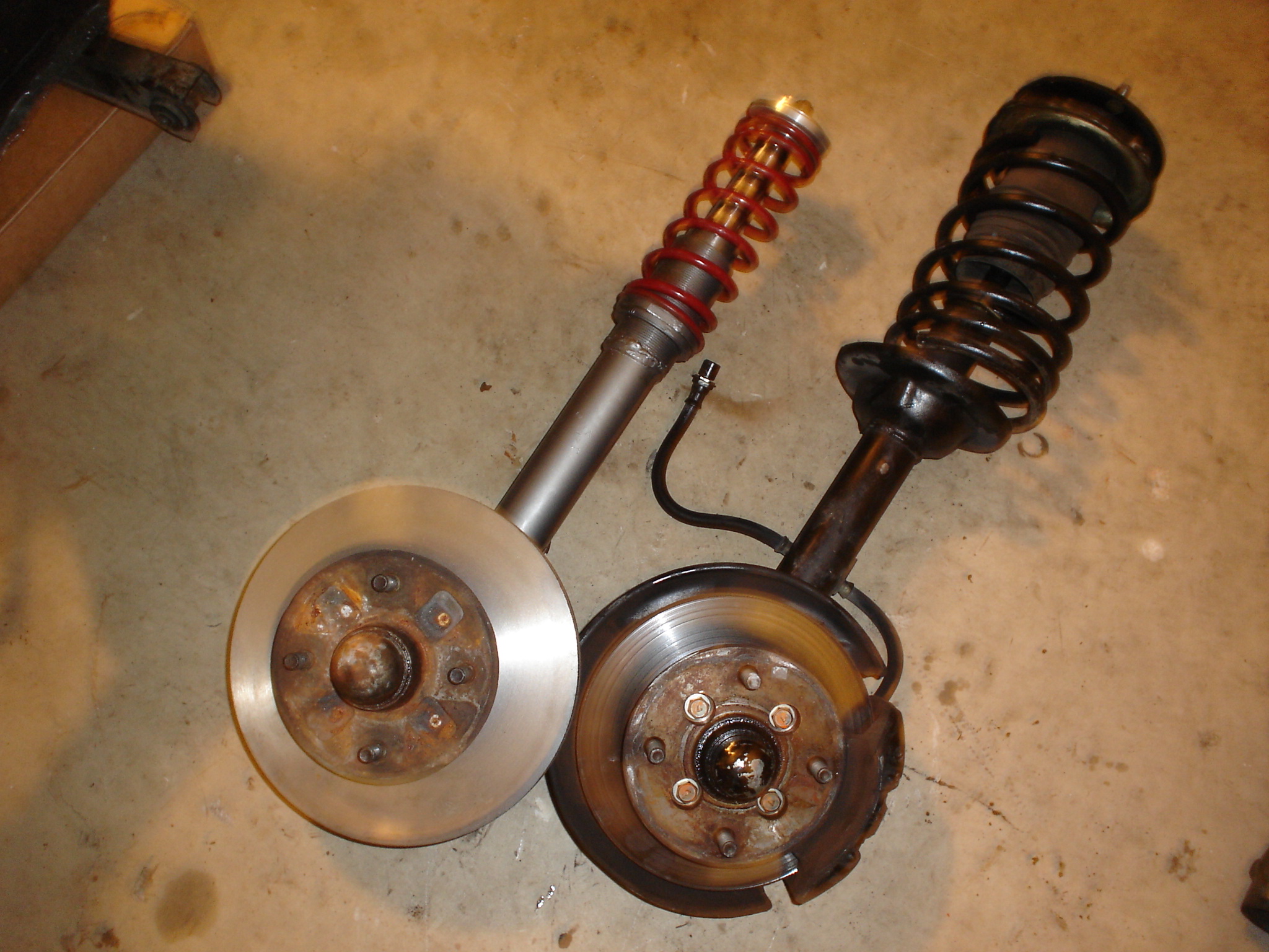

This is probably nowhere near as sophisticated as what others are talking about, but in my case I have merely used the front discs from a 72 to replace the front drums on my 69. Bolts right into place and lets you stop even in the rain, lol. Getting pretty hard to find pads for it on this side of the water though.

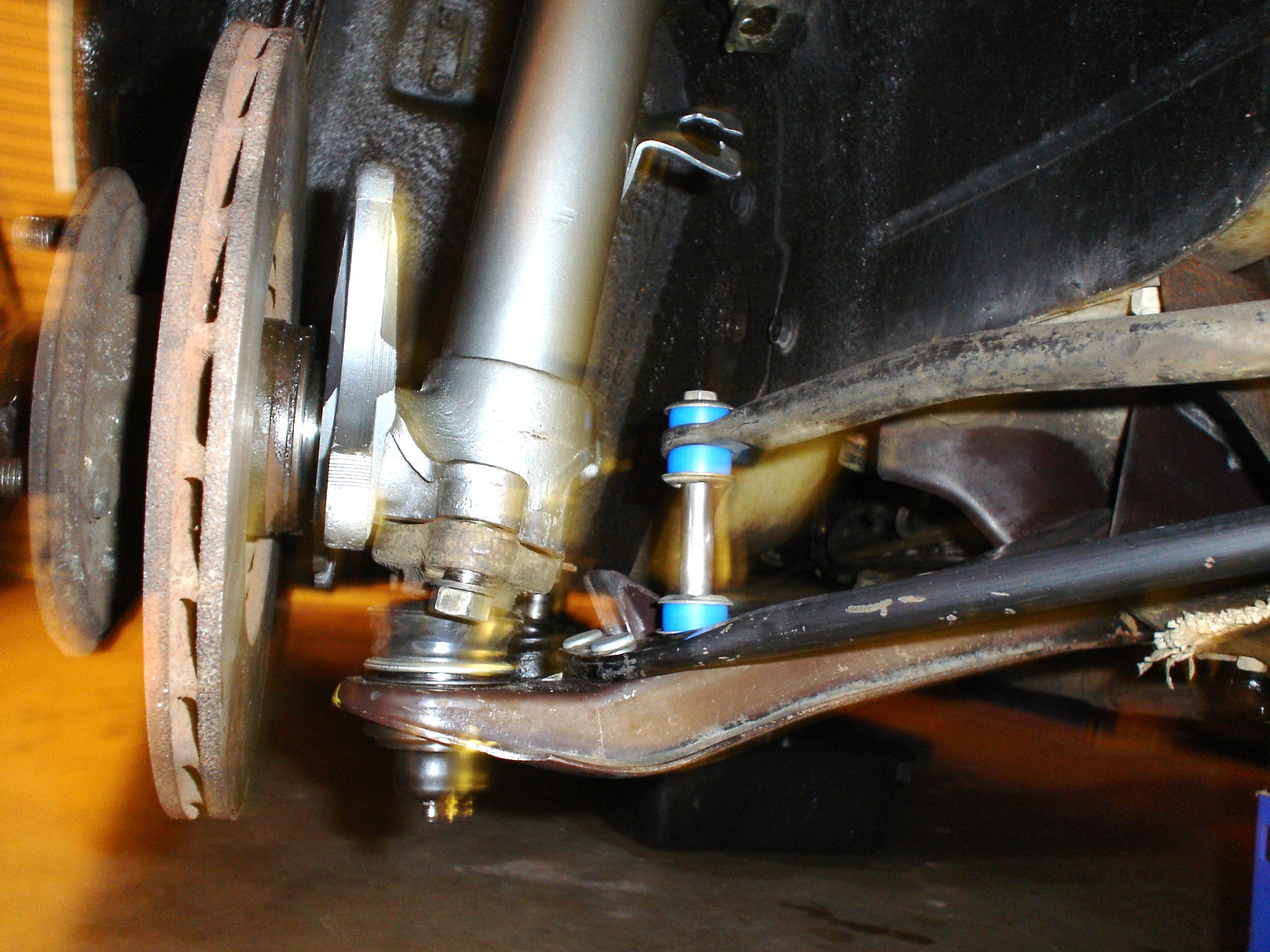

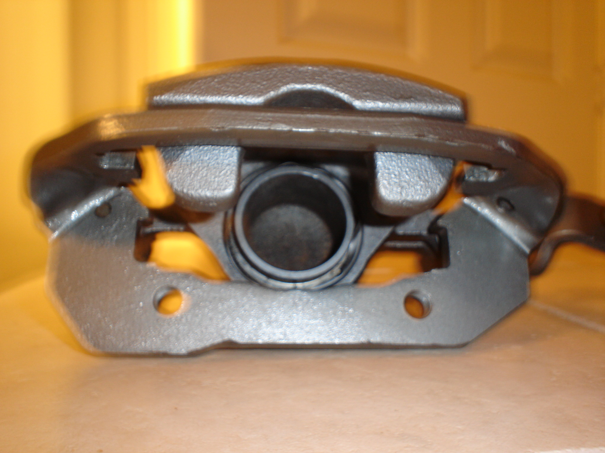

I have started to convert to magna discs on KE30 hubs for a KE2X. I have mounted the discs, just have to machine the front part of the hub and make a couple of rings for the centre of the disc and for the wheel mounting spigot. For calipers I am going to try and use VR or VS Commodore calipers.
This will give me a 266 x 24mm disc and fairly big calipers, leave the standard struts in place and change the stud pattern to 4 x 114.3.
So far so good, my only concern is clearance between the back face of the wheel and the caliper.

My brother had custom brackets made up to fit vr commodore brakes, he also had commodore disk machined to make corolla bearing fit in them(they had to insert sleaves to make the bearings fit). the machining of the disks wasnt that cheap , about 500, but there was quite abit of trial and error to make the bearings fit properly. All looks good now. The brakes are huge for the car but he does have a sr20 in his, and like someone said earlier there is now such thing as overkill on brakes

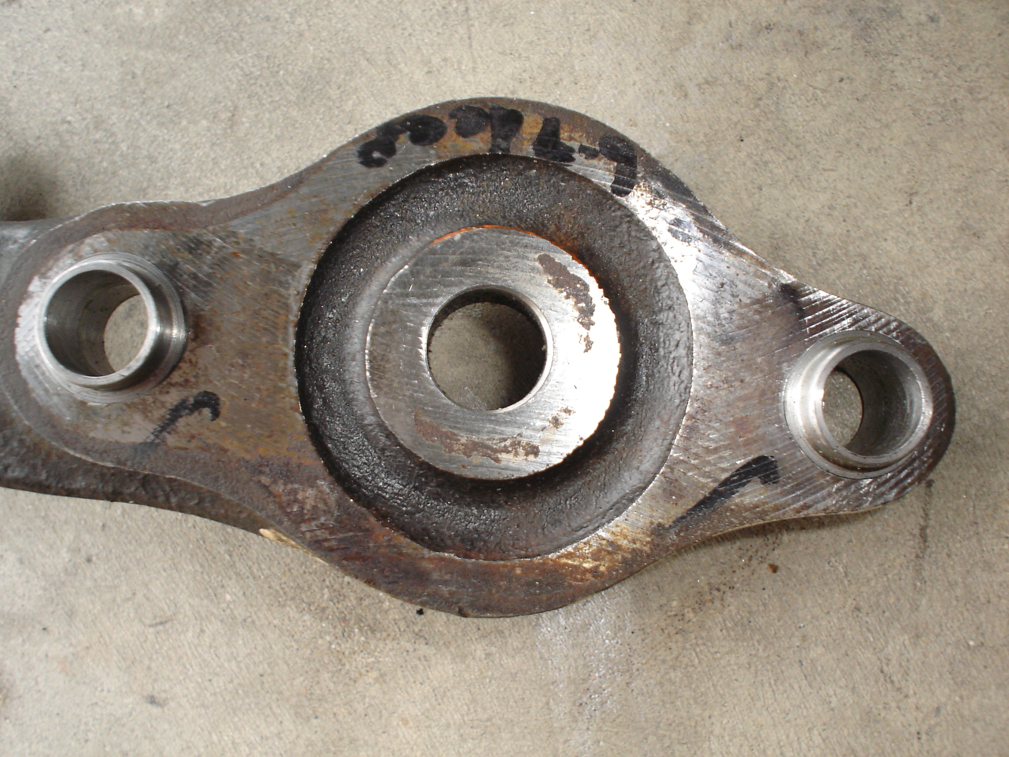

i used RA60 celica struts and brakes on my KE30, they fit easy but you have to use celica steeing arm on corolla control arm so that its a bolt on fit. The problem then is positive camber . i actually got the standard ke30 steering arms illongated 3mm by an engineer so that when all bolted up i now have negetive camber. bolt hole spacing on ke30 and RA60 steering arms are 3mm out. my ke30 stops well considering they are 255mm rotors but have large single piston caliper. ive got an fj20 turbo motor making around 300hp ( wheels ) and it stops well.

RA60 celica brakes on to KE30 . Corolla steering arm bolt holes are 3mm in compared to celica, i got an engineer to put some sleeves in 3mm out or you can use celica steering arm for bolt on fit, only problem is positive camber.
