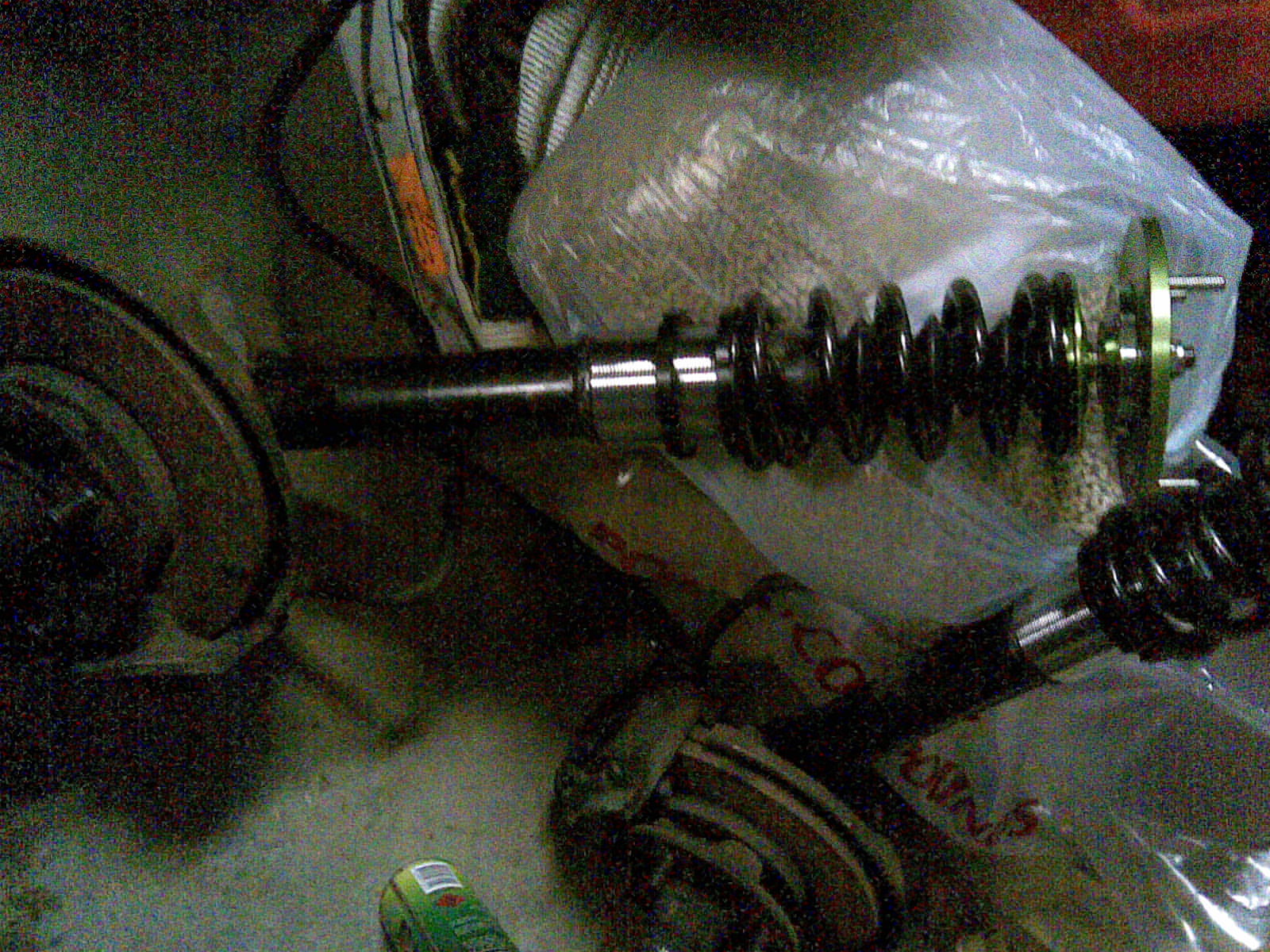

-racing logic coil overs (8 and 6 with camber tops)

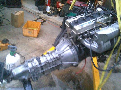

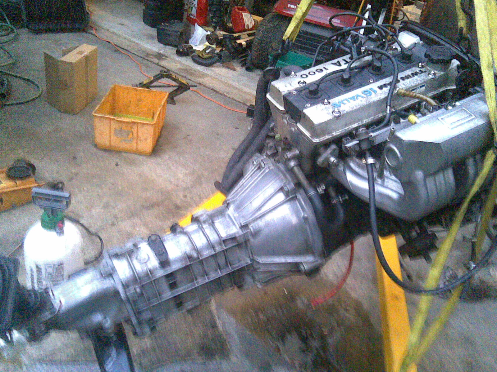

The pic of the motor and box looks sweet.
can't wait till i get mine together.
degreaser is your friend
