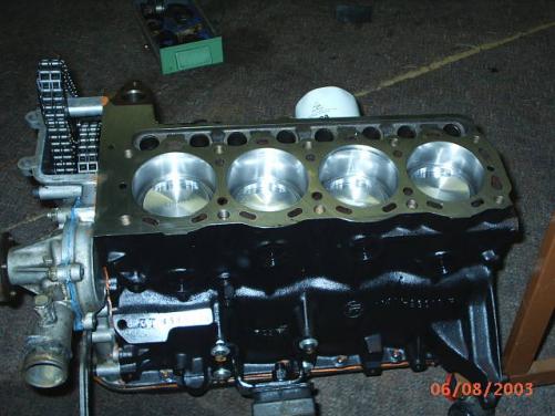

yeah i know there fairly the same power figures, but i realy just want a 3t for its crank, I'm going to boar it out to around 2 liters and put some forged pistons in it
If you use the 2tg head on a 3t block you can bore it out to around 1972 cc from memory, you just need valve reliefs machined in the pistons, get some forgies and up the comp around 10.5 to 1 with a set of carbies and cams and you will have a quick little engine. Do a search on the net for 2tg 3t hybrid and you will find your info. Just have to be patient.
Josh
Or if your feeling a little perky you could bore it out 84.5mm (think thats right, its the same size slugs as the 18R) into the coolent passages and drop in sleeves. Something like over 2litres.
Plus use the 4y crank = 2250cc
Plus side is asking people to figure out the capacity of the motor.
Negative side is that the motor, depending on treatment, will be short lived. Short rods on a long stroke crank isn't all that good.

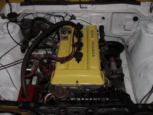

Actually you can put a 2T-G head on a 3T-C. You need to retard the exhaust cam to the last dowel hole on the camshaft, it still works well. PM Batesy TE70 about the details, as he did it to one of his motors.
or you can put 3t internals into a 2t block, need to flip some bearings and have grooves cut into the block to fit the crank. styler has the full details afaik, he posted them somewhere before
