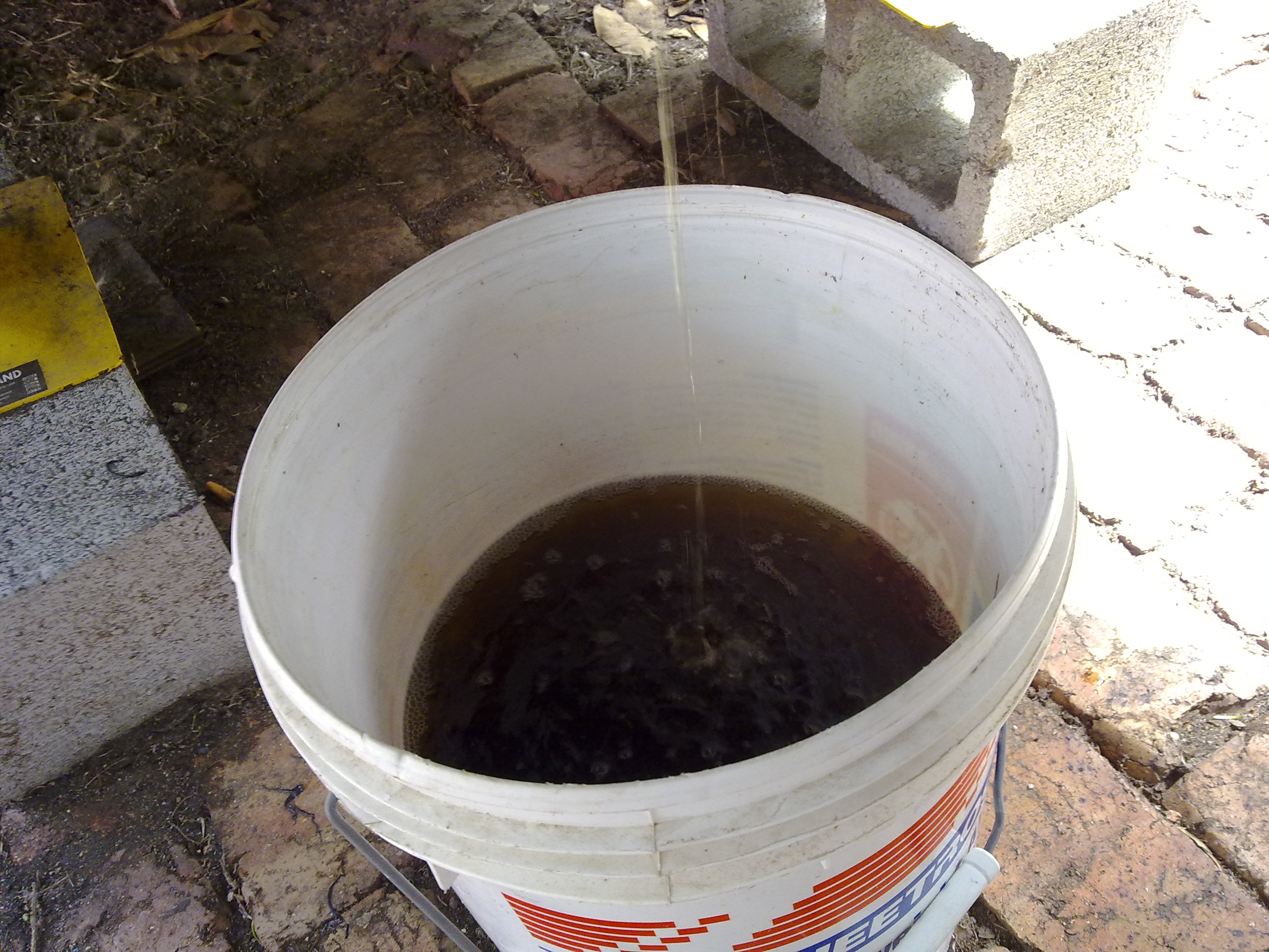

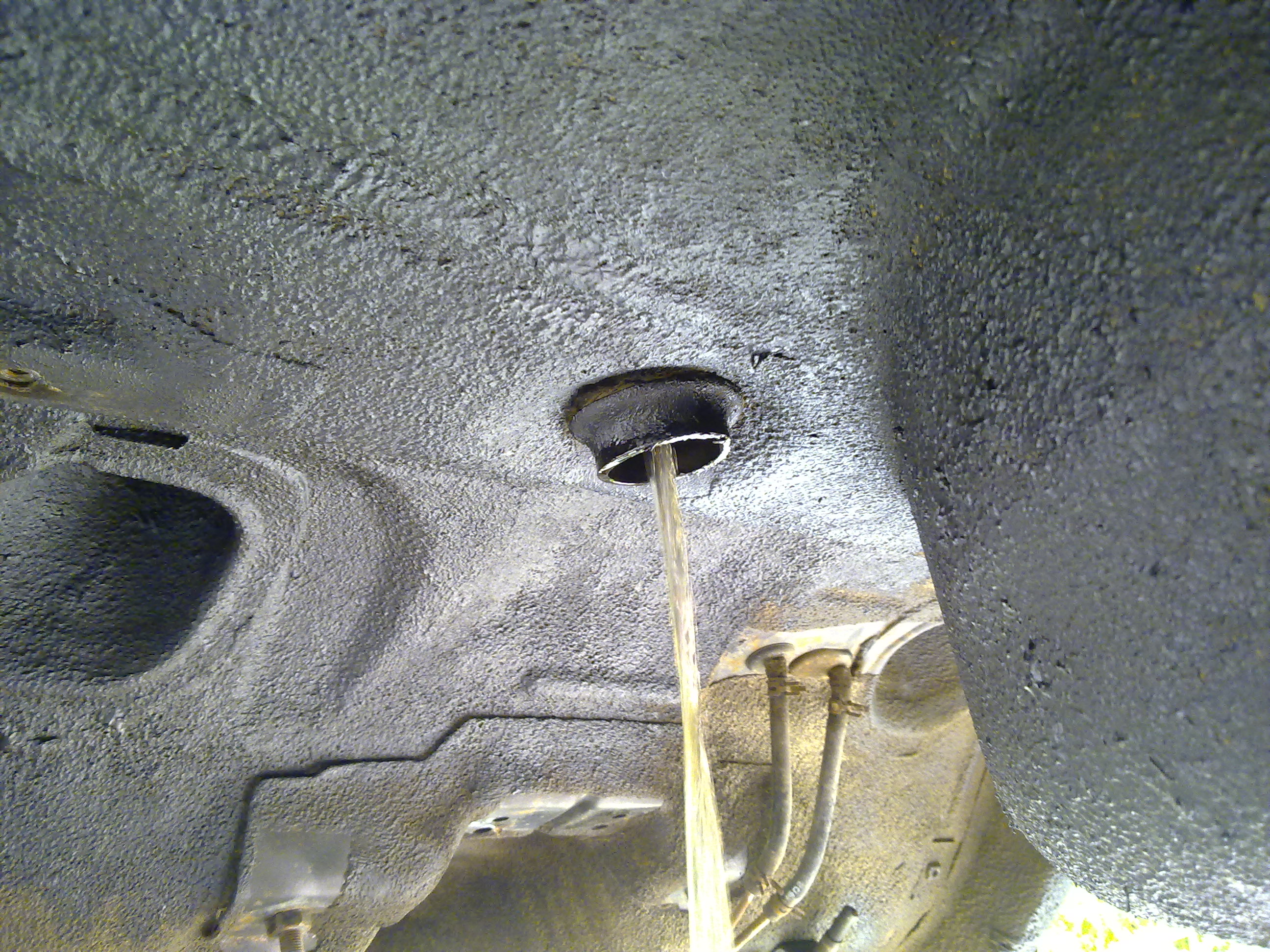

JiP Posted November 9, 2009 Author Report Posted November 9, 2009 How kinky is this. I took a photo while she was peeing... Â Â She had about 8 Litres left in her. It was pretty black. I'm not going to use the fuel elsewhere so I poured it out in the yard. Should I do anything to clean the tank out completely or just leave it at that?? If not I'm just going to plug her hole up for now. Quote
love ke70 Posted November 9, 2009 Report Posted November 9, 2009 thats what fuel filters are for, don't let the tank sit empty, rust inside will make your life a bit of a carnt... Quote
JiP Posted November 9, 2009 Author Report Posted November 9, 2009 mmm I have about 15 litres in the garage. I might just stick that in it for now. Quote
roladude Posted November 9, 2009 Report Posted November 9, 2009 If your finances will allow. You should fill the tank and empty it before you go to drive it. Quote
JiP Posted November 9, 2009 Author Report Posted November 9, 2009 mmm They wont. So the 15 litres will have to do for now. It'll be like a year away so I'll drain it again then and fill it up. Â Tomorrow, if I have the energy to do so, I'll hopefully fully remove the fuel lines and sand them down. Plus I need them off to do the sound deadening. Â I hope to have the diff in soon. Just need to finish the back section before that happens. Almost there :cool: Quote
Taz_Rx Posted November 9, 2009 Report Posted November 9, 2009 If you're already removing the fuel line then if I were you I just remove the whole tank (4x bolts) to clean it!! Just re-fit the bug, add a litre, shake the tank, drain and repeat. Thats how I found that roofing nail! :cool: Quote
