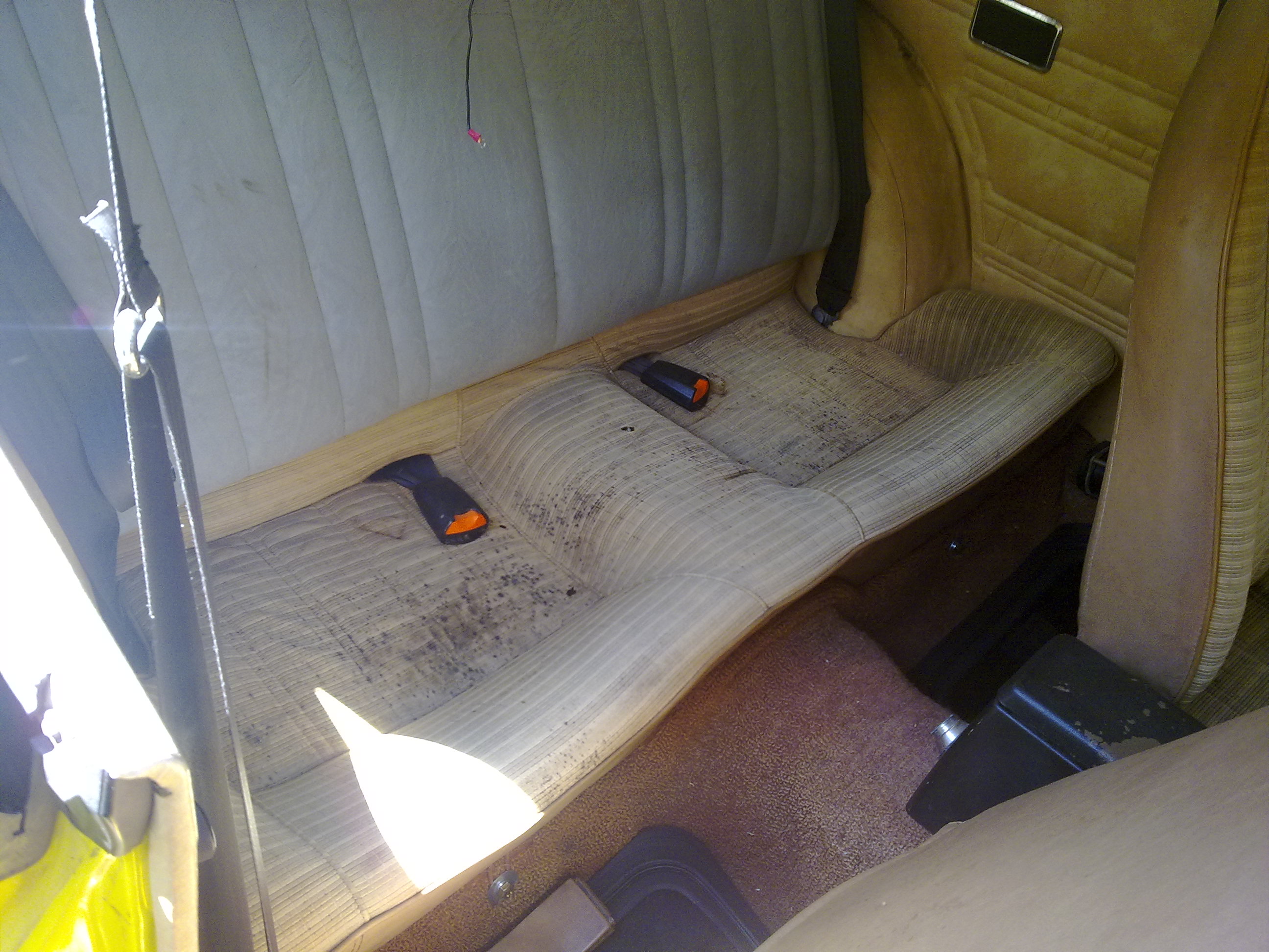

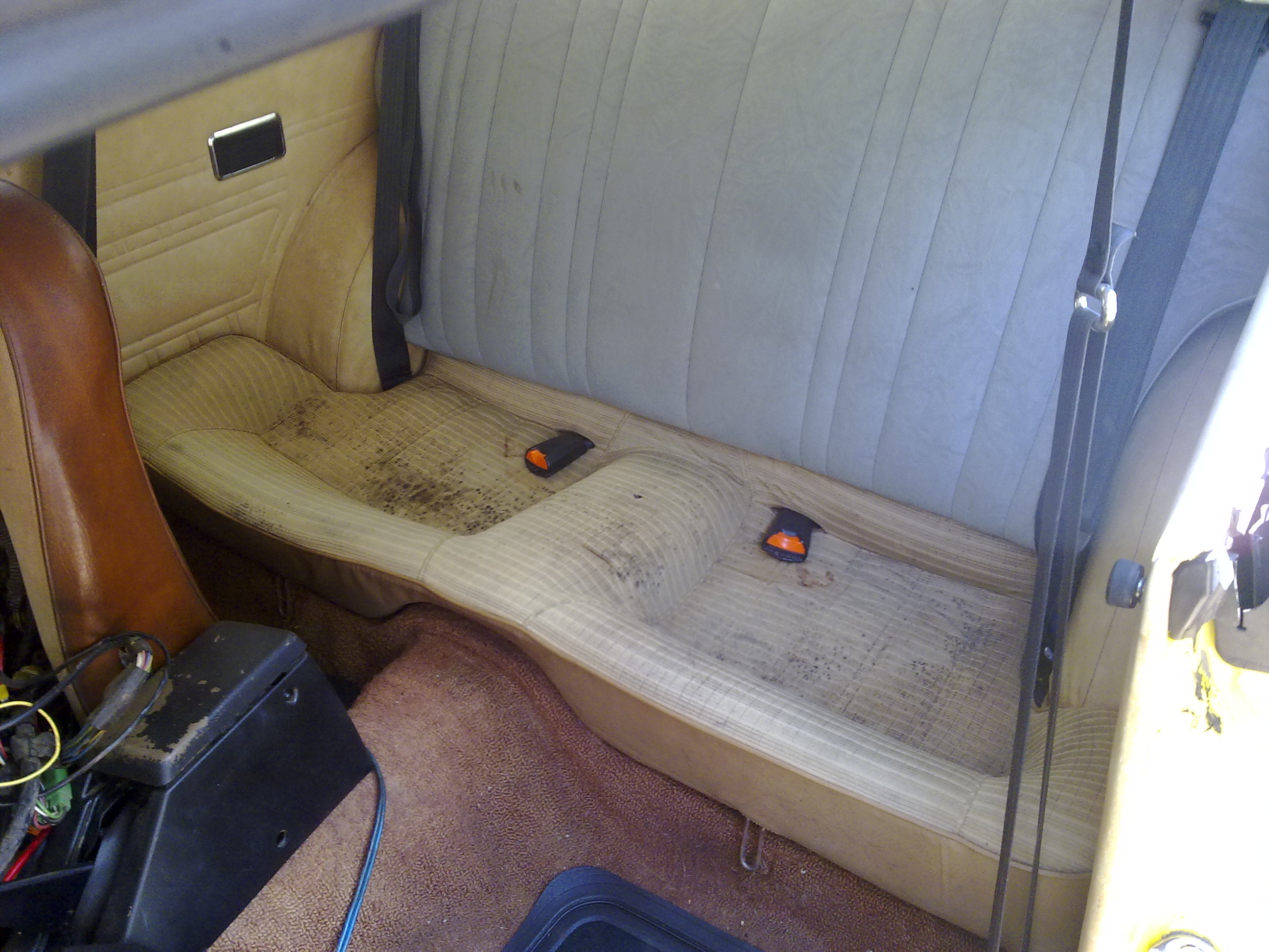

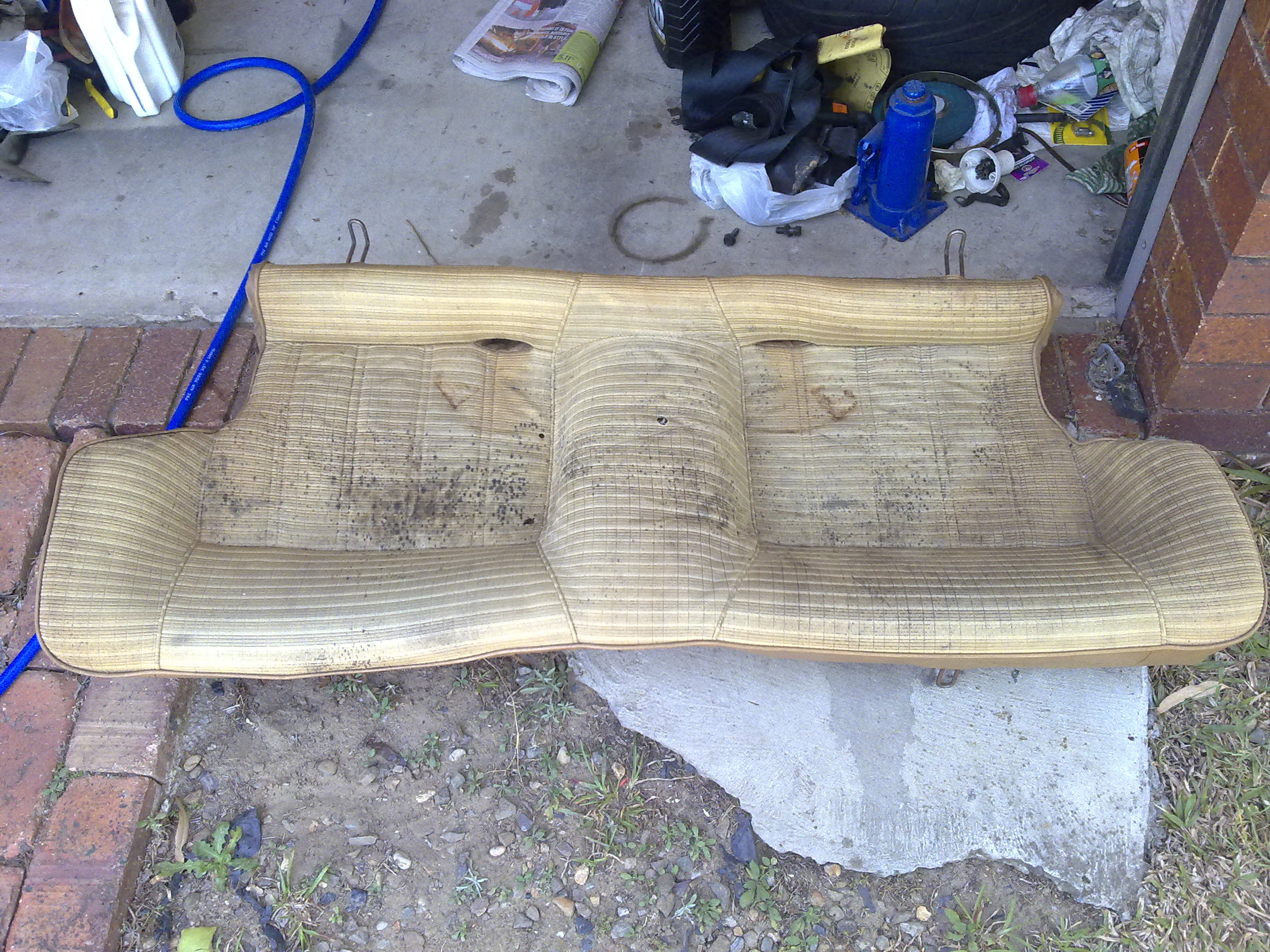

Here we have the base rear bucket seat from my old KE50 liftback...
Normally the base rear seats in sedans and hardtops bolt in at the front only. So I've had to cut the back mounts off to ensure I can bolt the top back seat in.
And in...
Now I'll have to get it all recovered in the material that I want but it doesn't look too bad. Might just get the pattern in the back rest altered to match and see if we can adjust the springs to form some back buckets. If not that just some more padding for a headrest.

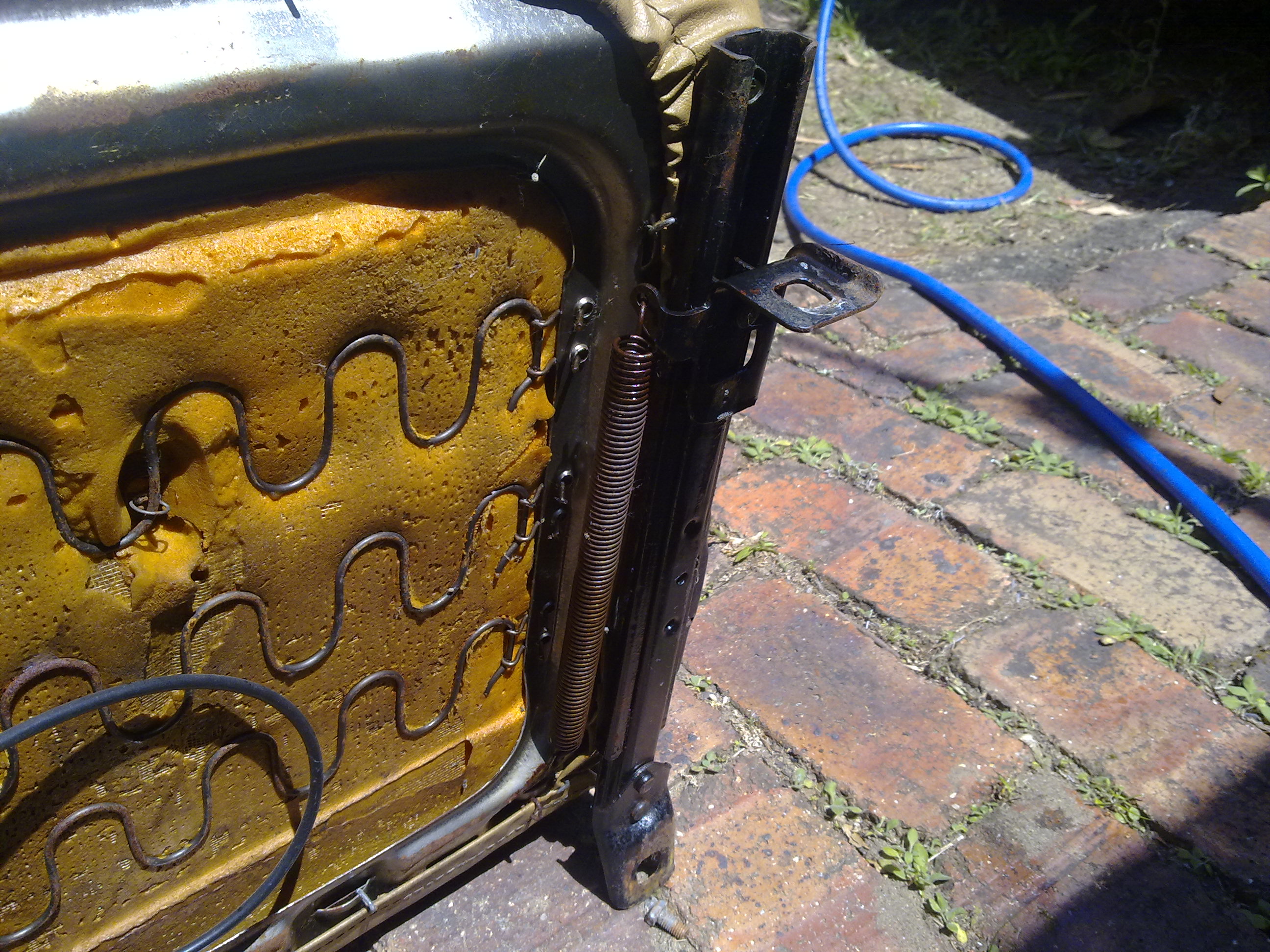

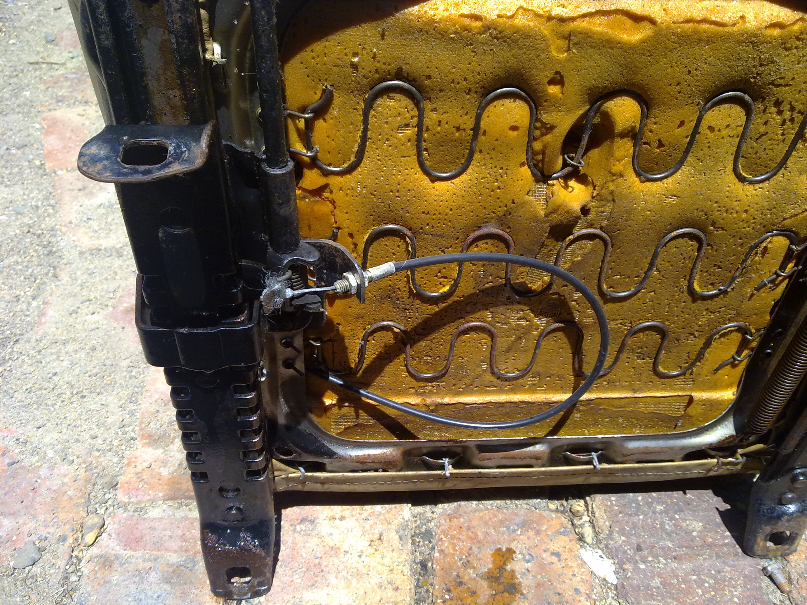

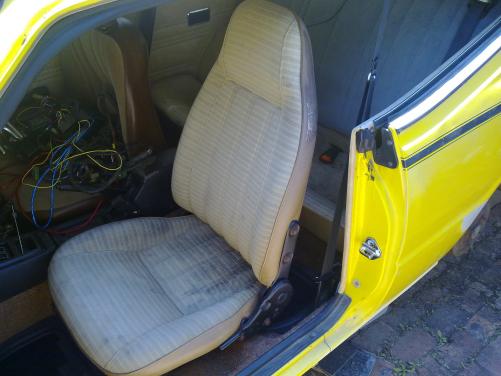

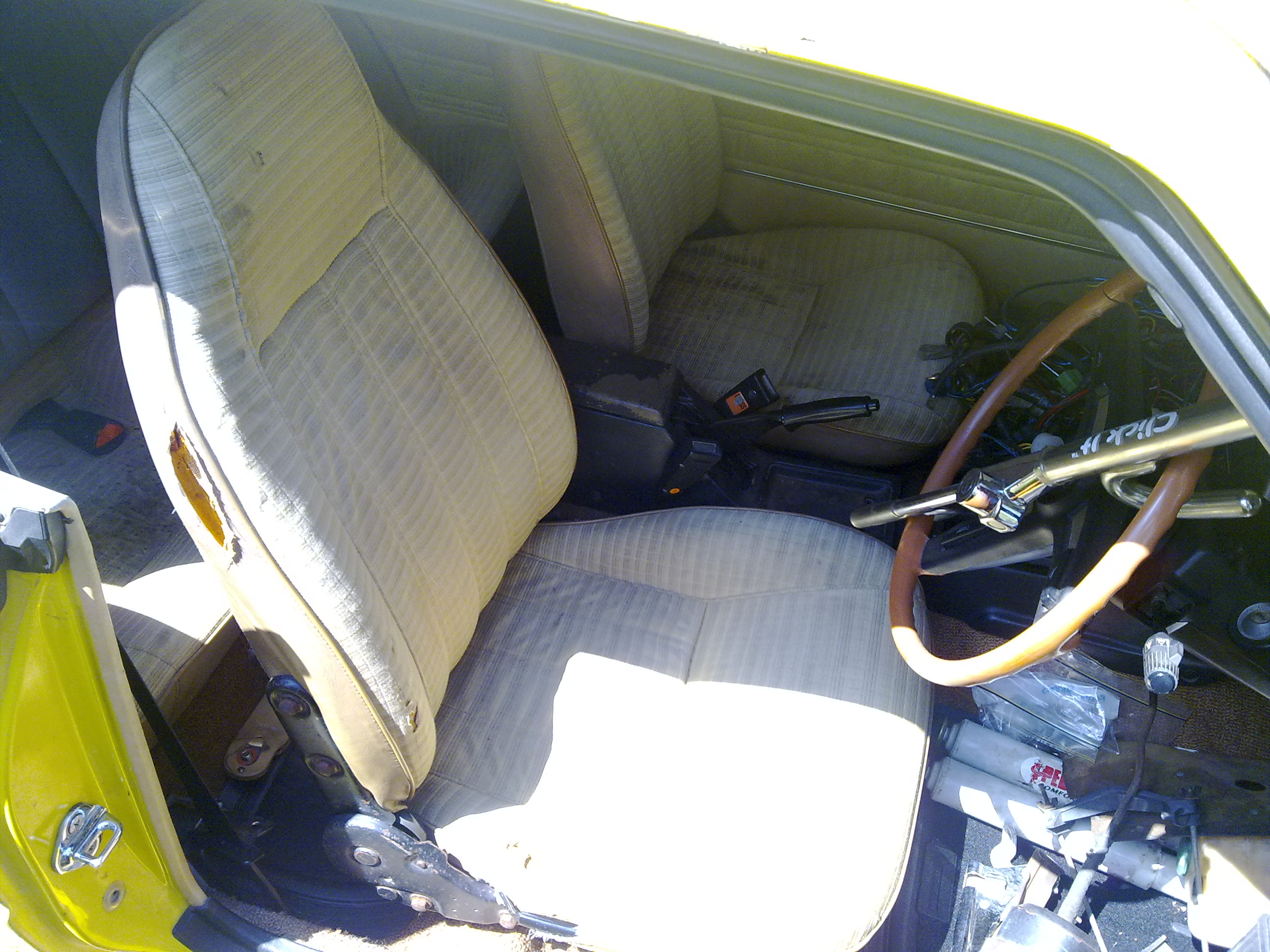

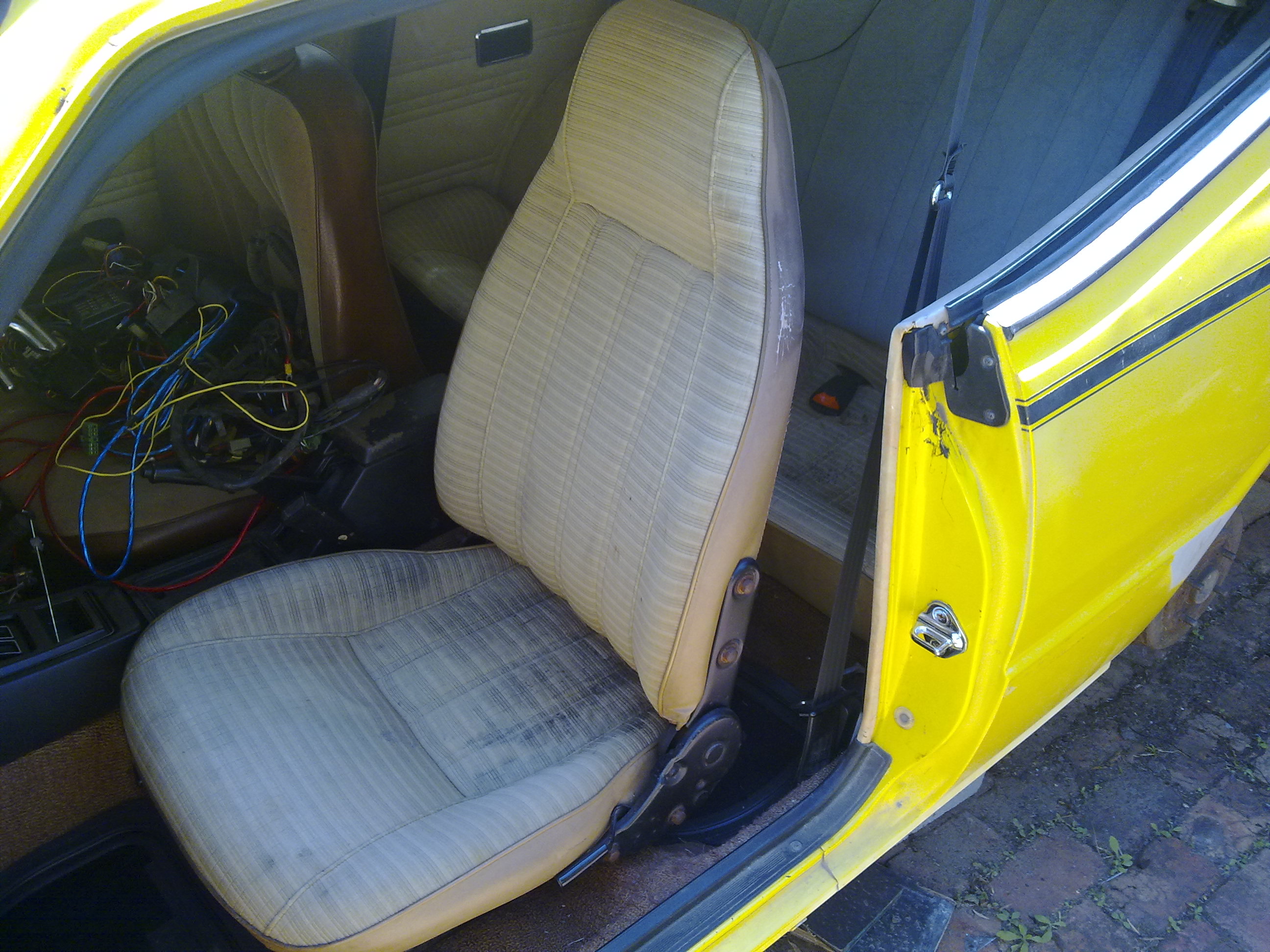

Now the fronts. They might not have a massive bucket but they are a Corolla seat that I can bolt right in and they have features.

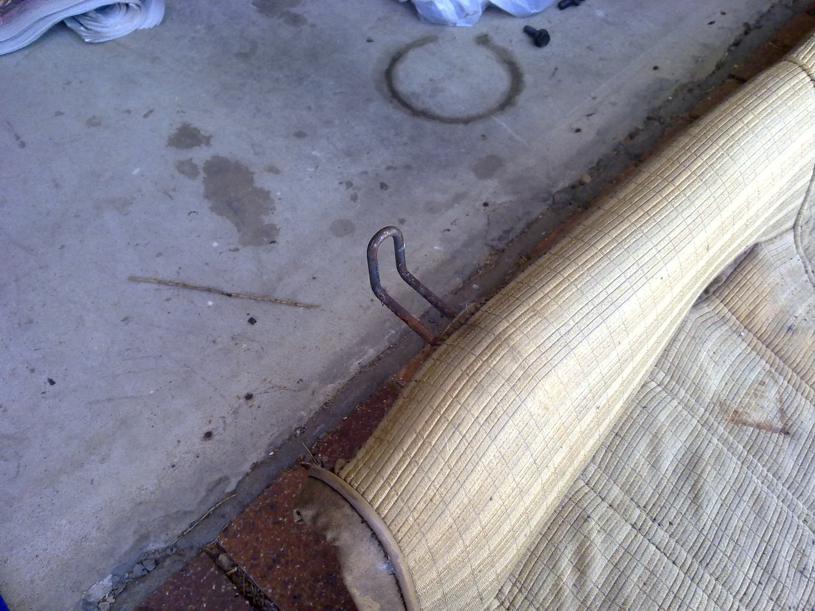

As you can see there is a spring that is attached to the seat rails that you wouldn't find on normal seats. Its so the seat springs forward to help passengers in the rear get out.
As you can see that wire that is under the seat is so that when the seat reclines forward it triggers the seat to slide forward too.
The buckets aren't real huge but I'll see if i can get them stuffed a bit higher when they get recovered.

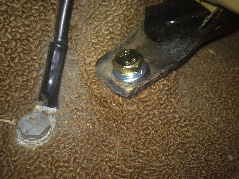

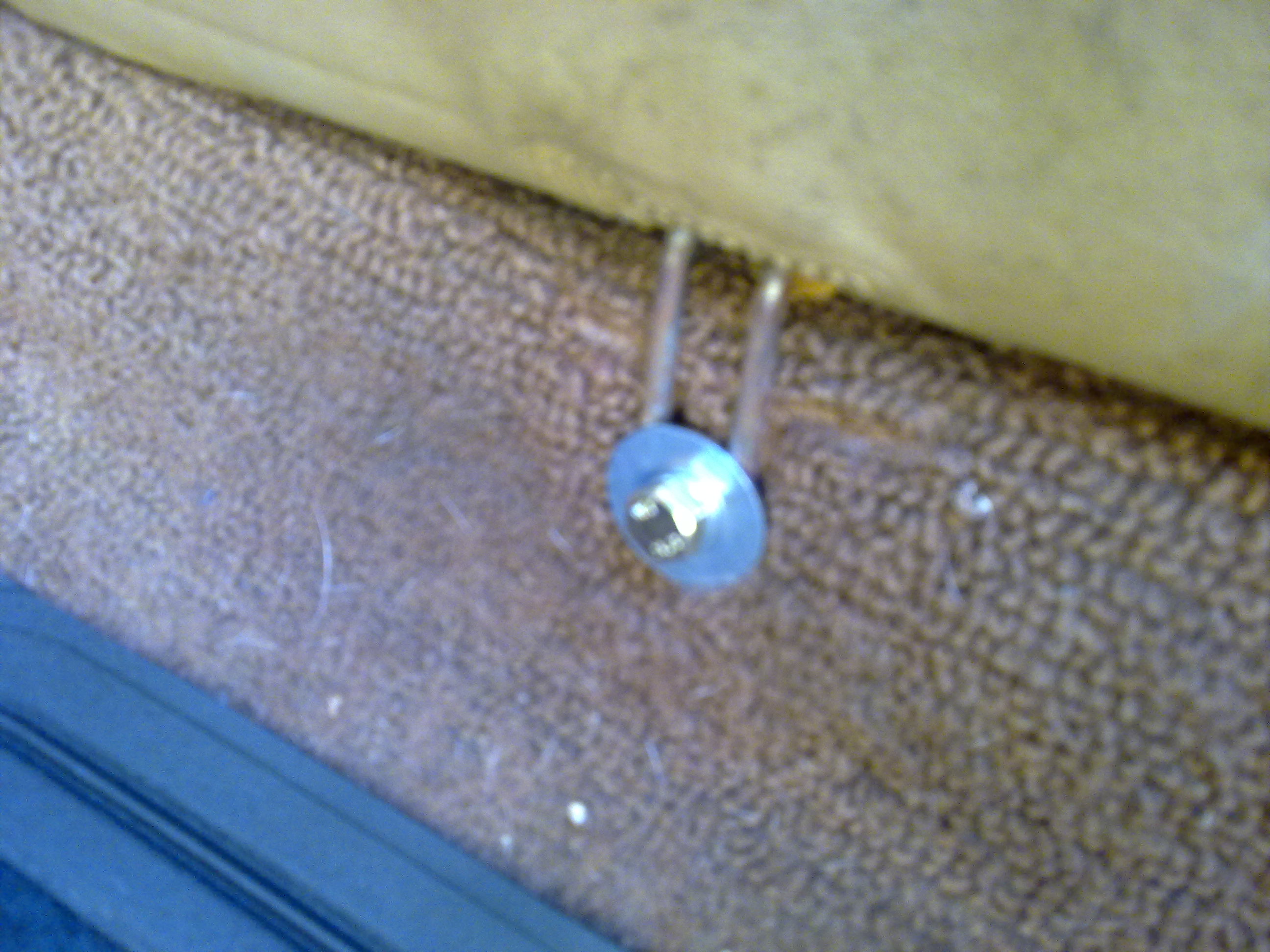

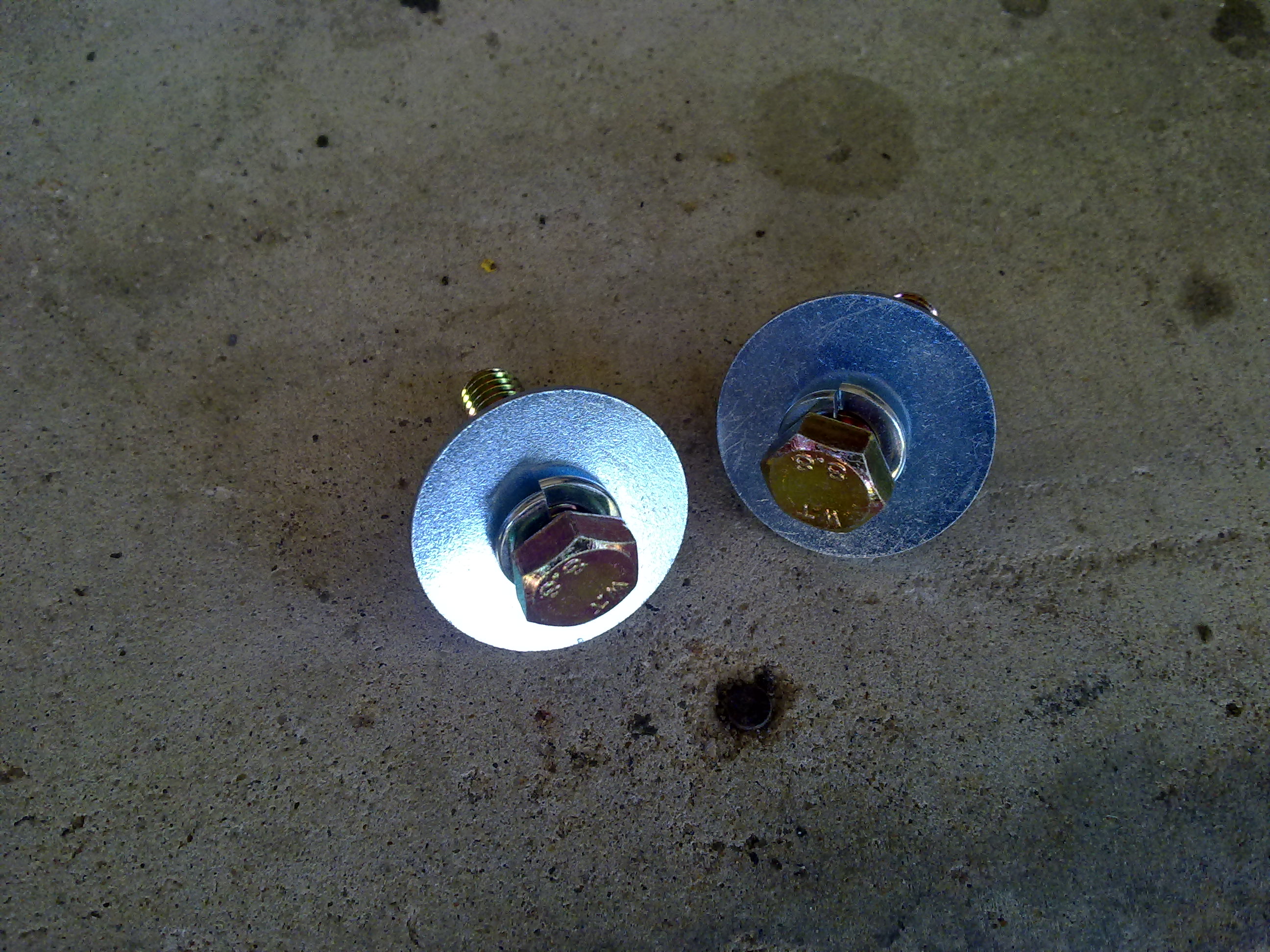

Also got my replacement seat bolts...

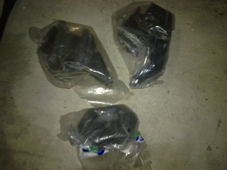

Brand new Engine mounts and gearbox mount...

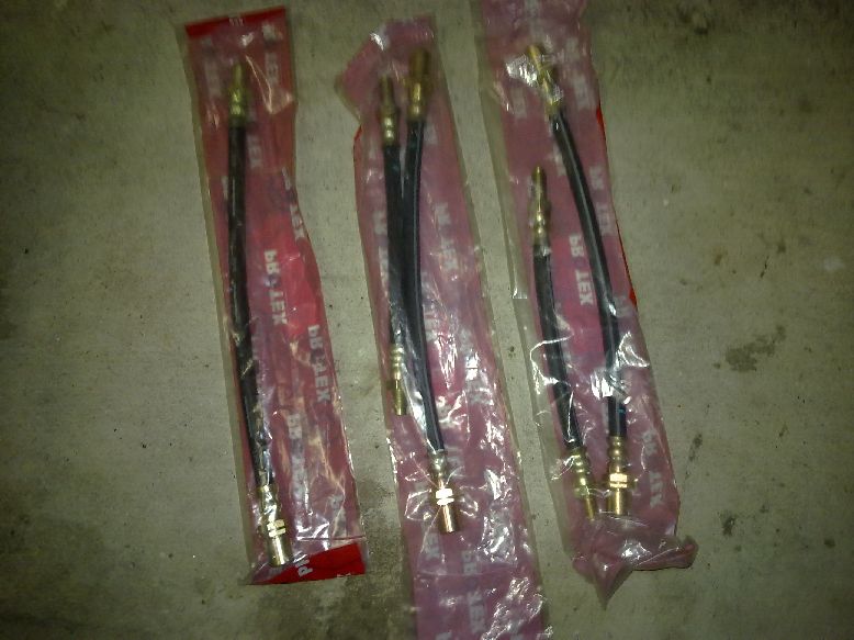

Brand new brake hoses...

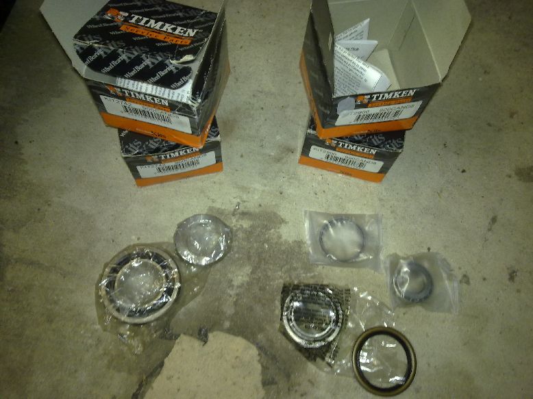

Brand new bearings for the whole car...

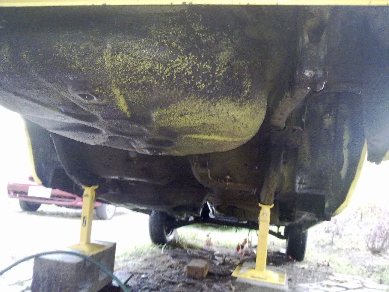

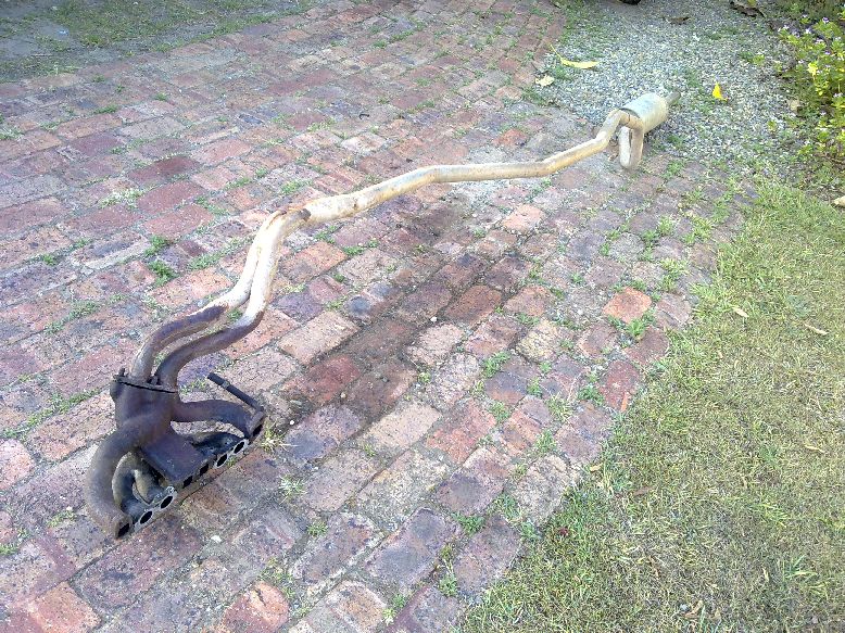

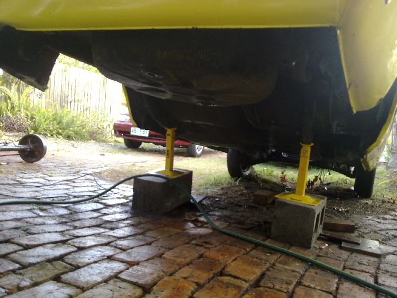

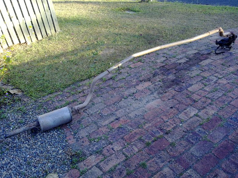

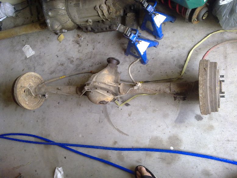

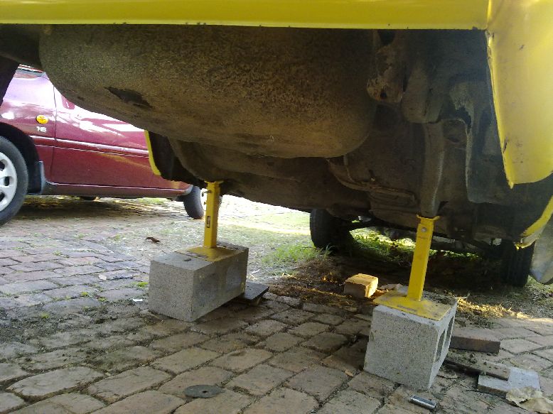

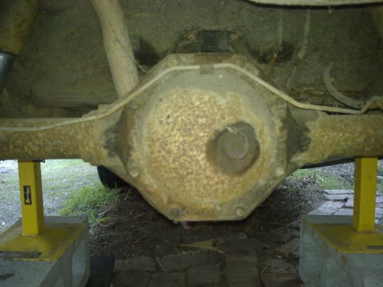

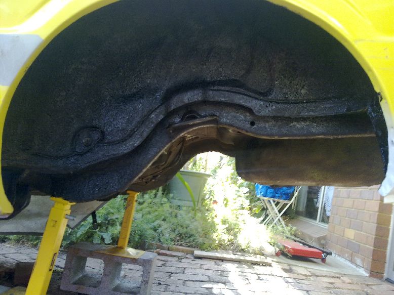

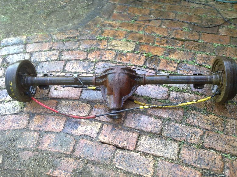

Got a bit of work done today. I dropped the diff, leafs, exhaust and all the mounts. Then high pressure cleaned everything. Man the clumps of dried up mud under this beast was amazing. I think I got everything. Tomorrow I slide on under her and start sanding away at the old sound deadening and with luck start applying the new stuff.
Diffless...
Clean!!

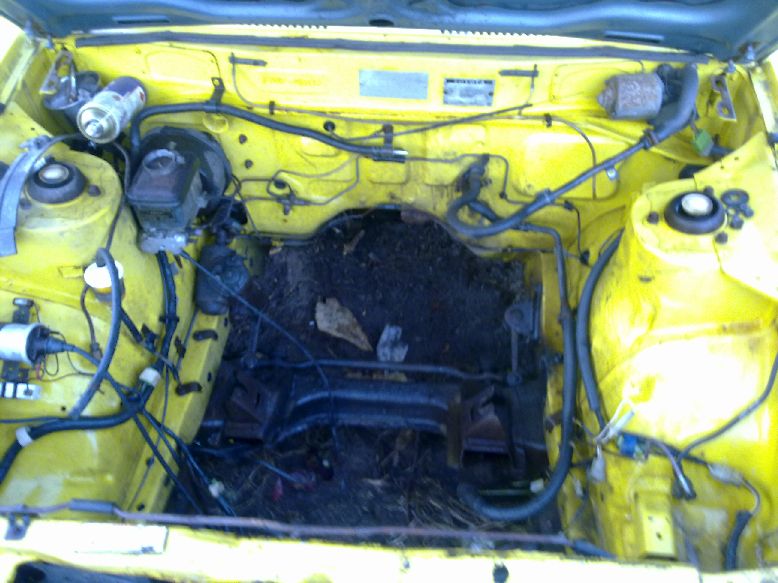

I cleaned the engine bay while I was at it too...
Anyone after a good used exhaust??
The diff...
While I had it out I decided to give it a clean too to make it easier for me later...
Doesn't she look hot :)

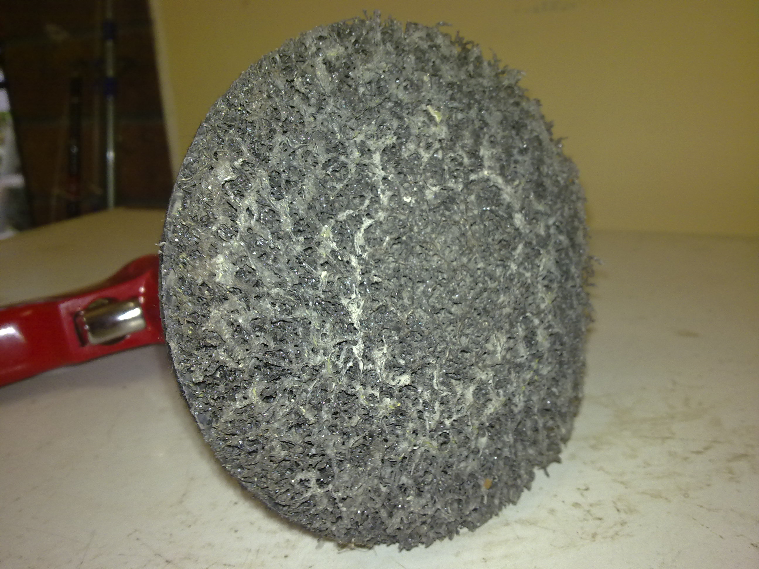

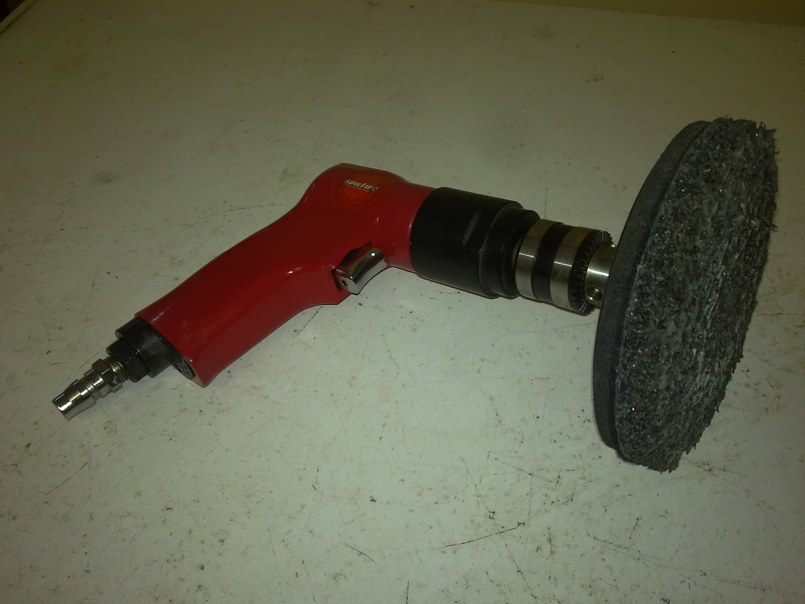

Already there. Here is my cheap air drill and my sanding pad. Man this attachment is just as good as a wire brush, takes everything off, tho I do have an actual wire brush as a back up for when I have to get into the small crevices.
Good work :) , yeah used one of those pads stripping back a shell before. They're a bit less abrasive than a wire wheel and can wear out a bit quicker too. So maybe use the wire wheel just to knock the major lumps off the deadener then start using your 3M pad. You'll wear the pad out too quick otherwise. :D

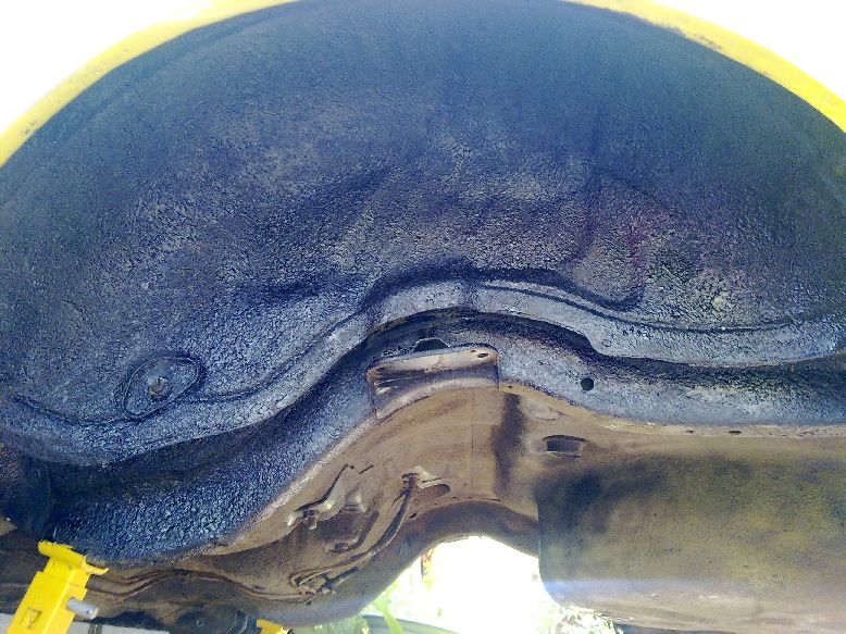

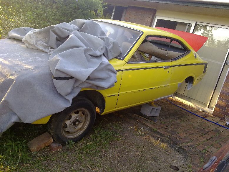

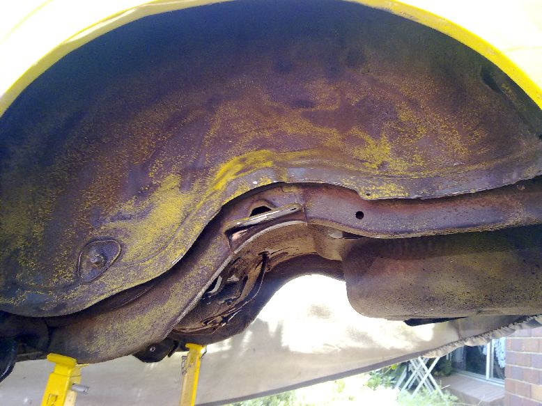

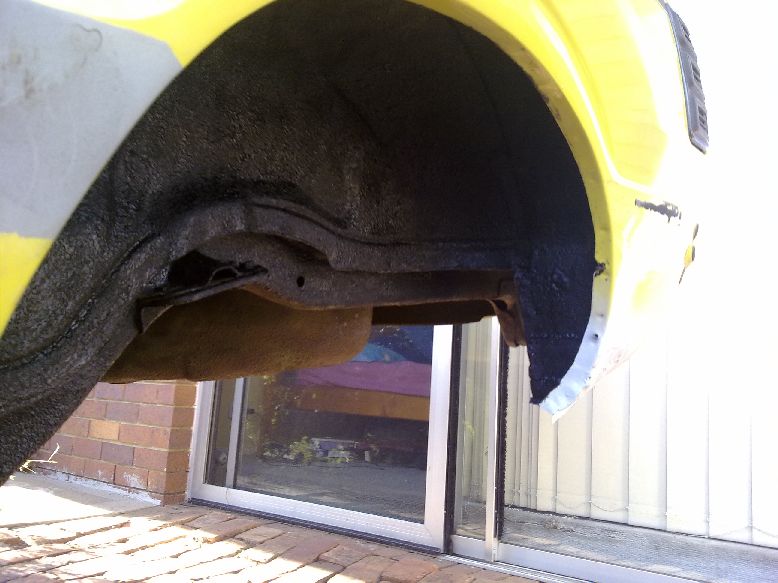

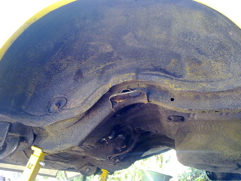

So I sanded the whole rear end.
Okay before...
After sanding...
After 1st coat. I'll put another coat on tomorrow...
I only did that side today. Tomorrow I might do the other but most likely will do the under carriage in the arvo when its not hot. The sound deadener dry's quick. I'll also buy some spray on deadener for the places I can't reach.

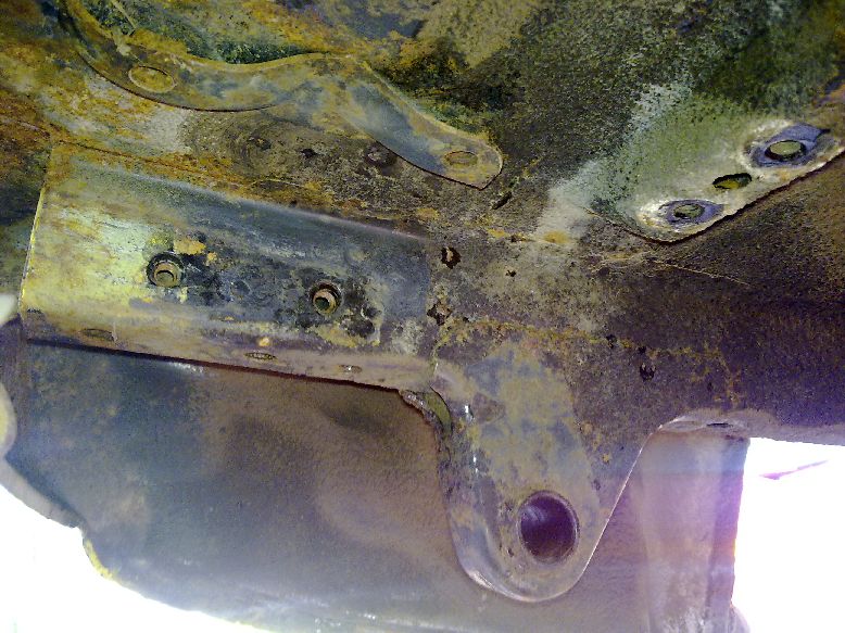

I noticed this while I was sanding. Its got mounts for a tow bar. I've never realised that...

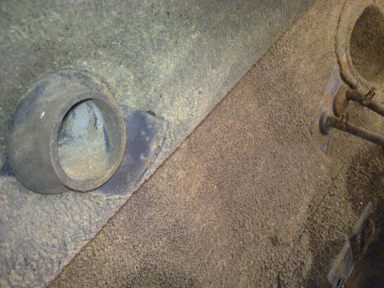

Okay lastly a question about my fuel lines and tank.
Inside the rubber part to the left there is a bolt. Is that the drainage nut to the fuel tank? Also to the right are the two fuel lines. One that goes to the fuel filter and the other that goes to the charcoal canister. I should be right to drain the tank through that right?
Also the condition of the lines aren't the best. just surface rusty. I should be right to sand them back with some wet and dry, or is it best to paint them too?
