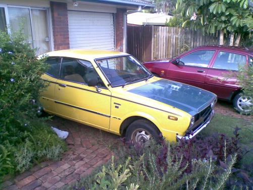

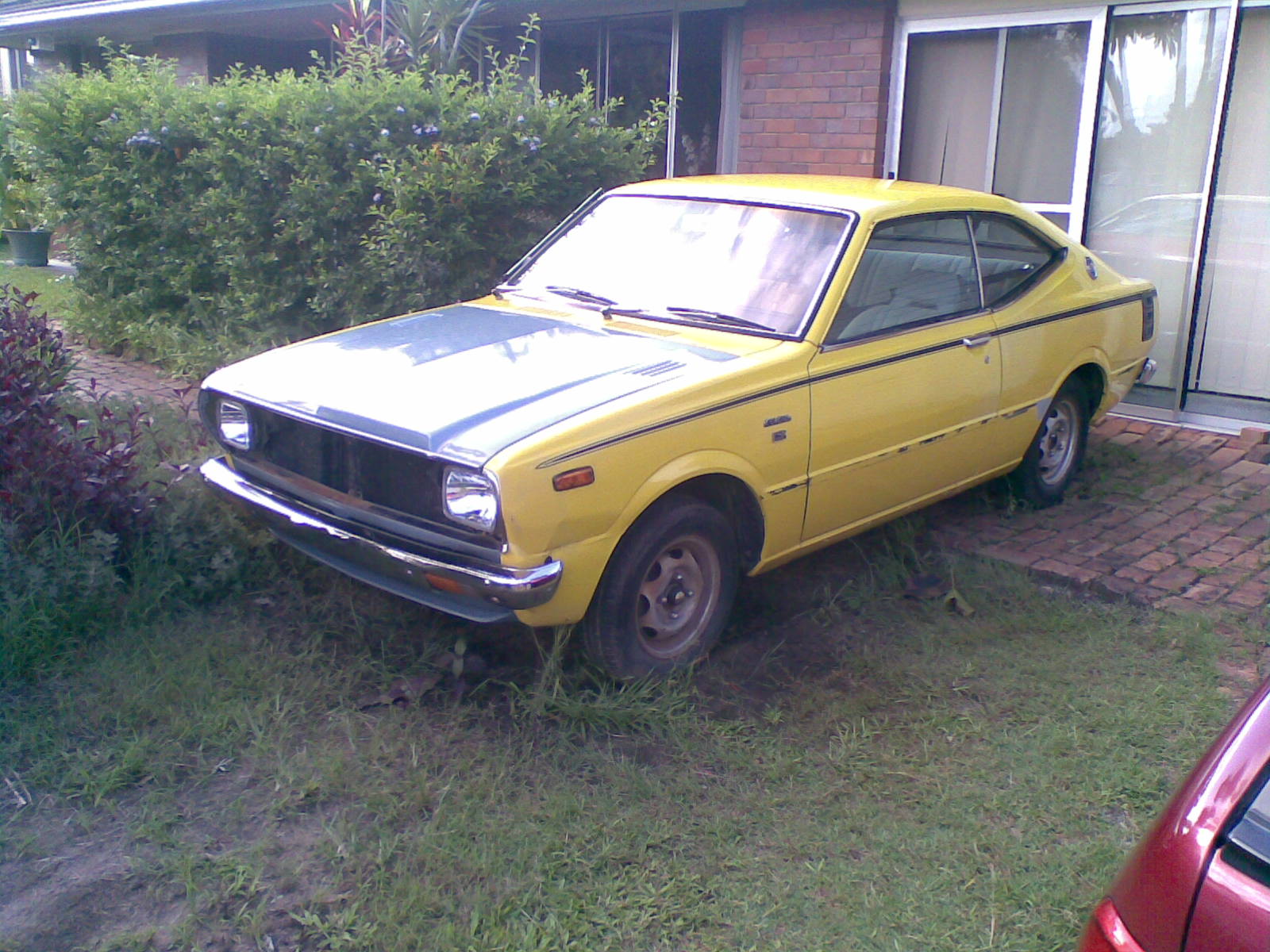

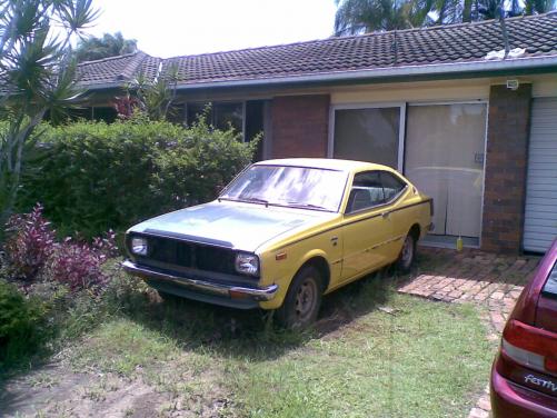

Well its been months since I've last taken the covers off SL2. So since I bought a pump last week and washed Lolla, I decided to spend the day washing SL2 as she has not been washed while I have owned her.
Here are the before pics...

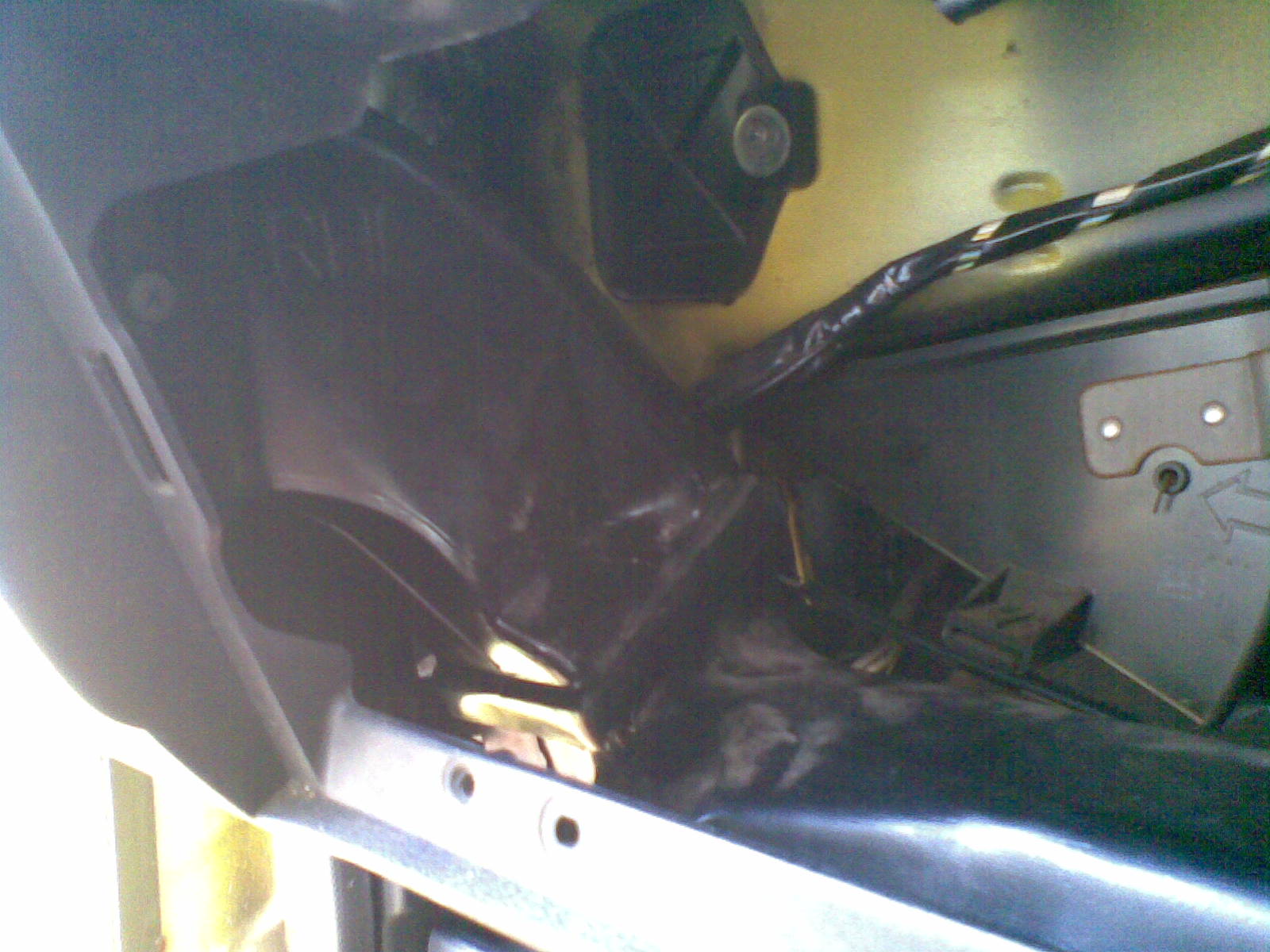

I pulled out the glove box to install the final piece of the aircon ducting.

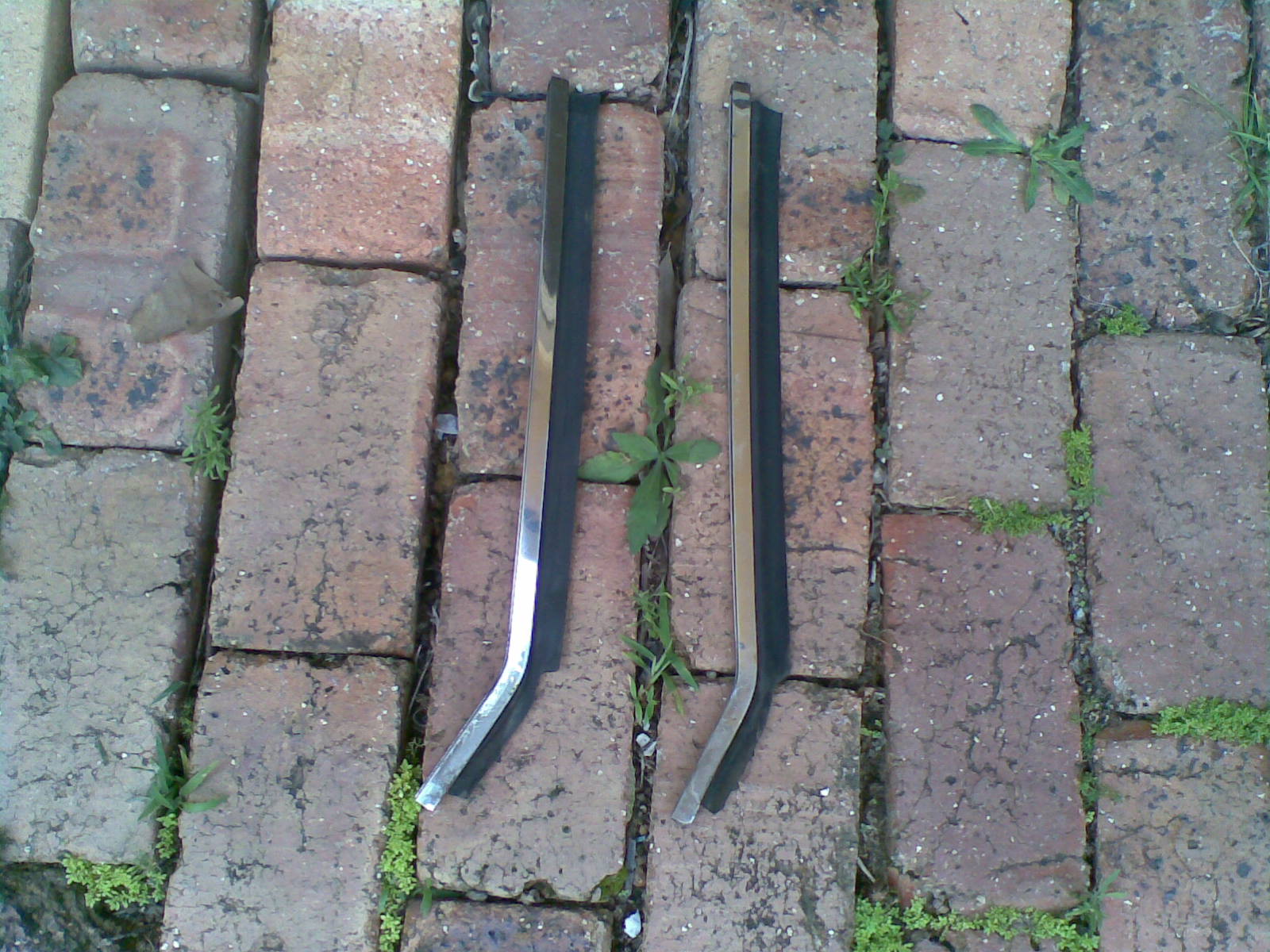

I've had these in my garage for a long time and decided to replace the ones on the car as they have badly perished.
See.

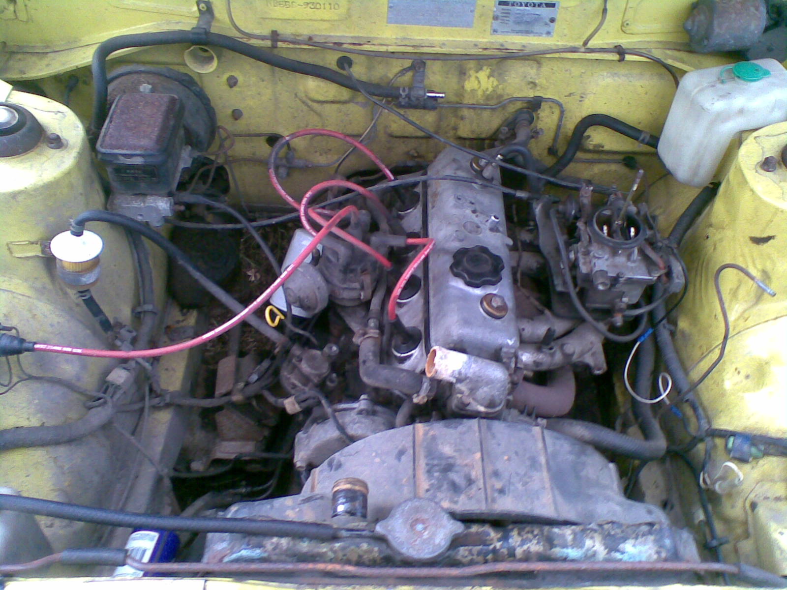

Degreased the bay. Man was it bad. One step closer to getting the Skanky 4K out!

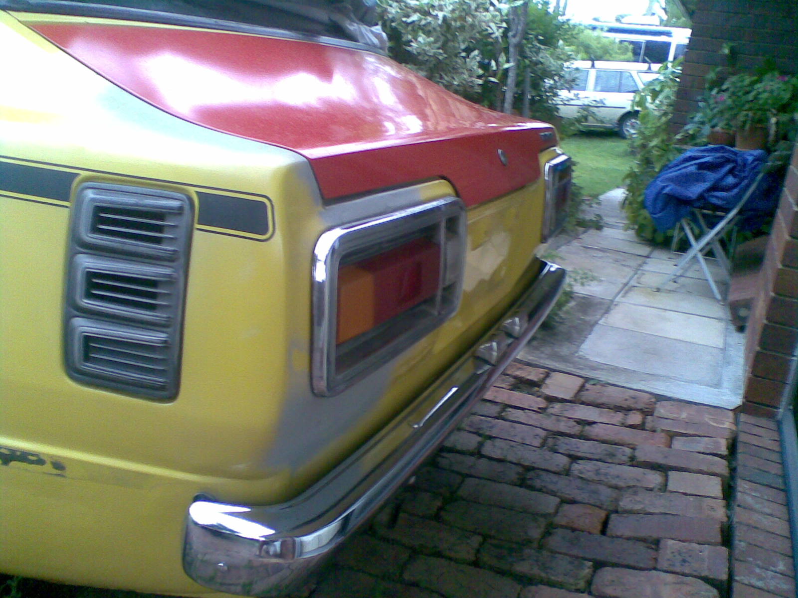

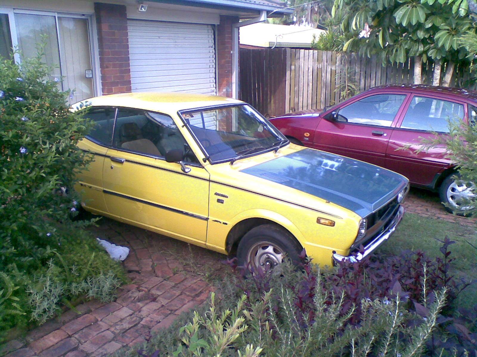

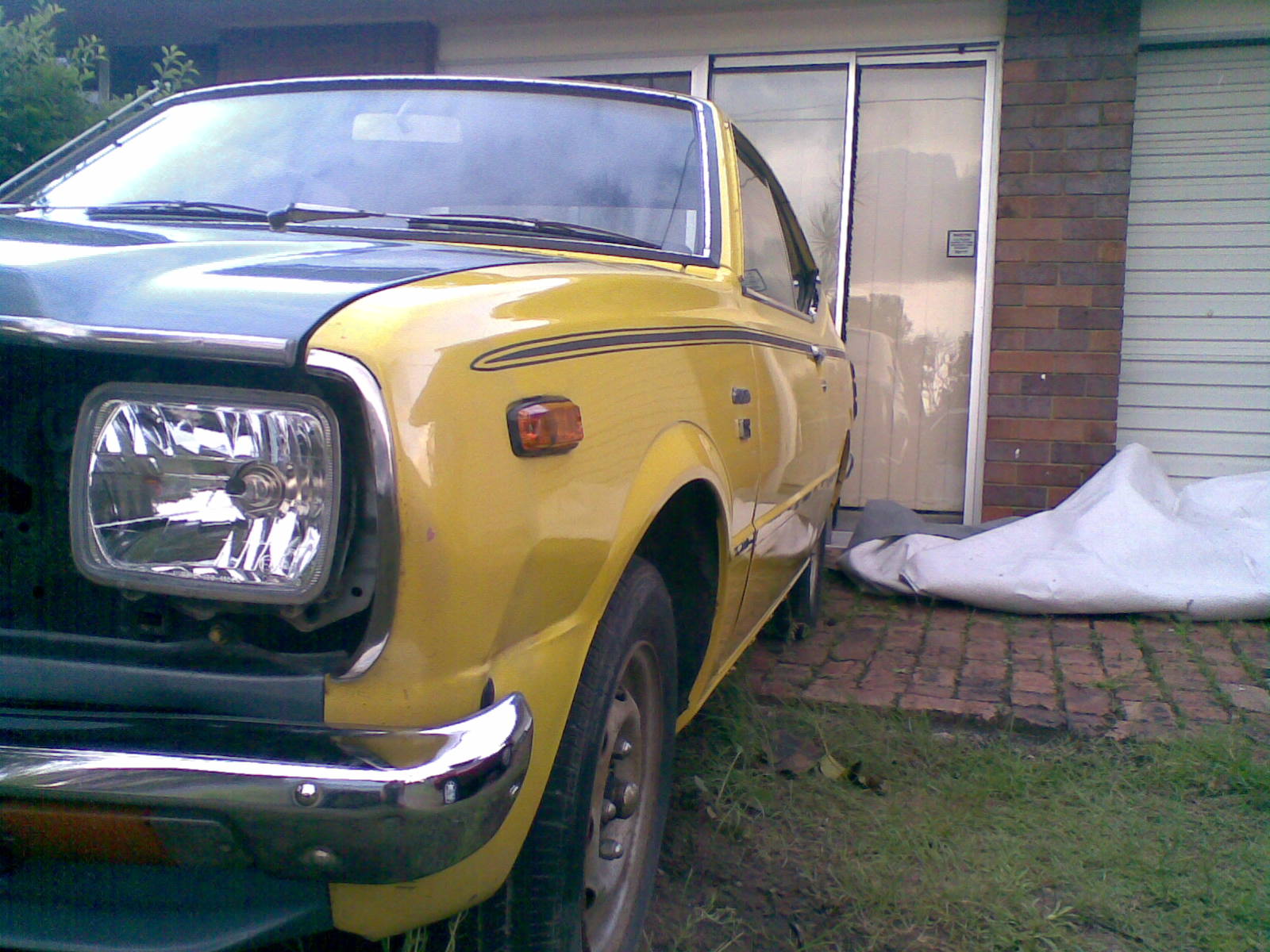

Now heres the after shots.
Shot of the day...
After all that it looks like its going to storm, so I went to put the cover back on and now i've got grass inside the cover. I believe this is the worlds worst car cover!!!

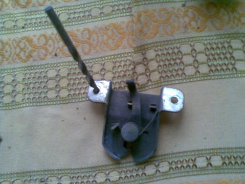

So I was making a boot release for Skanky-Loue. I did the same for Lolla, this is just more detailed. Its a KE70 boot release.

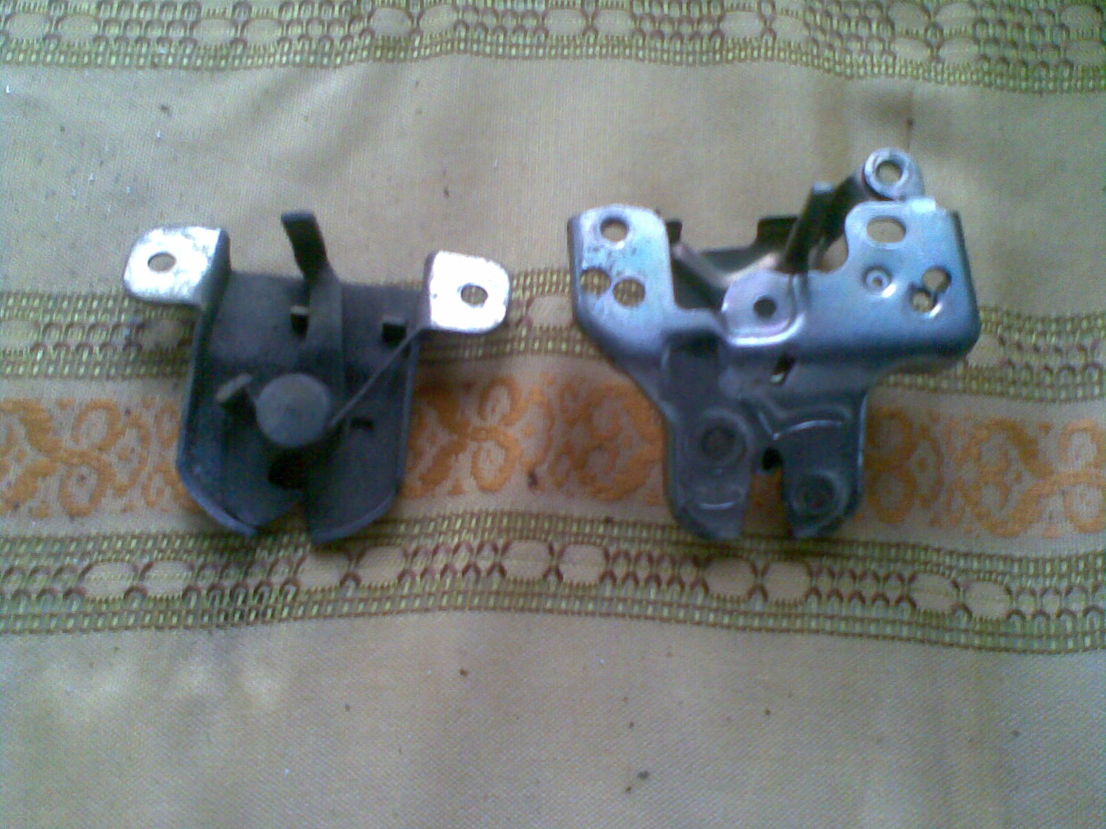

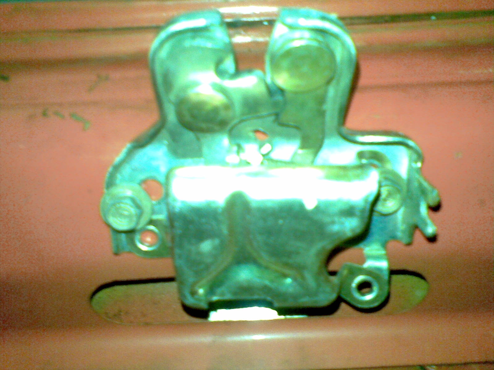

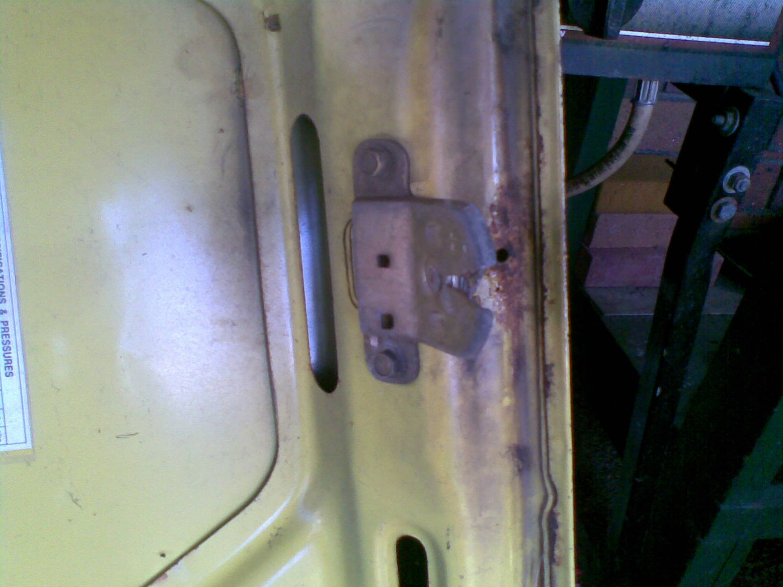

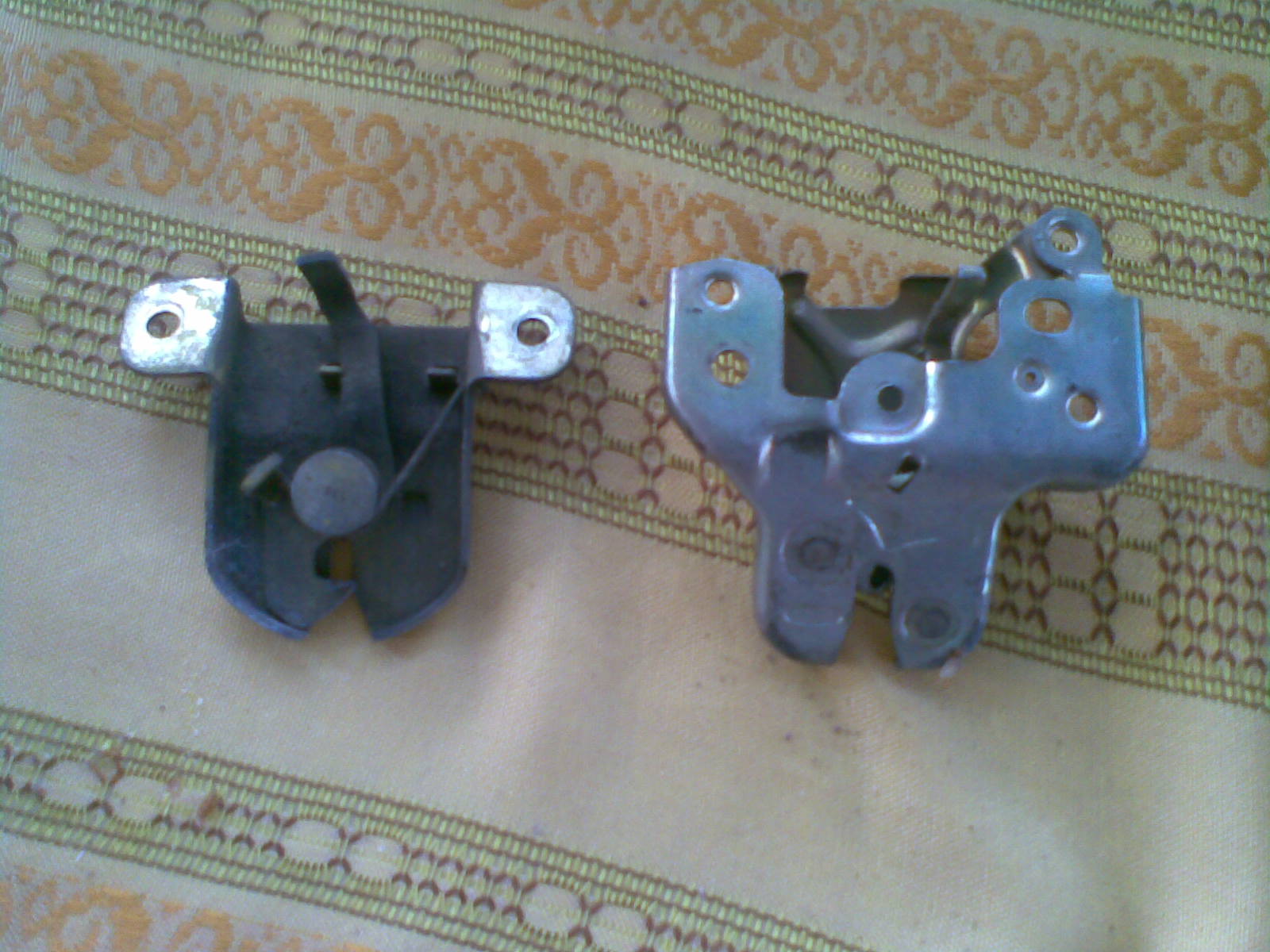

So here is one of my KE55 boot latches.

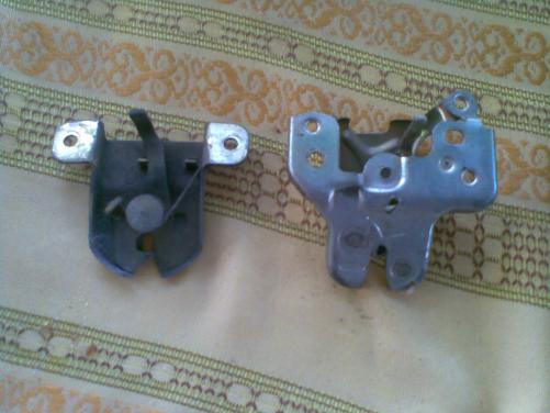

The KE55 latch next to the KE70 one.

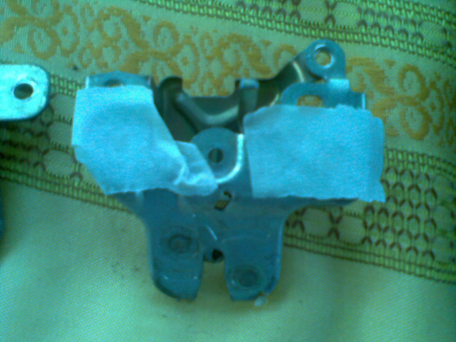

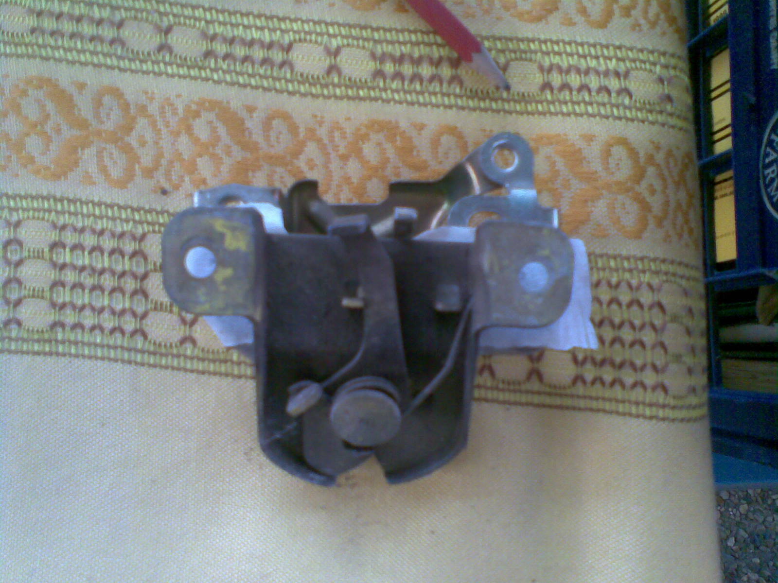

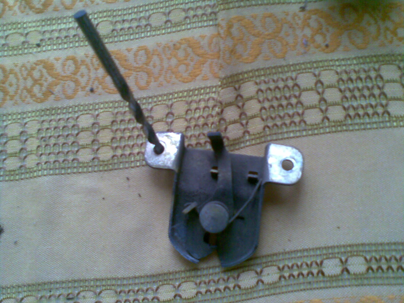

I masked it up so I could mark the holes, plus it'll be easier to drill on it without the bit slipping.
Marking the holes by lining them up over each other, making sure that the latch section lining up over each other, then marking the holes through the holes.
Finding a drill bit that fits.
Drilled the new holes.

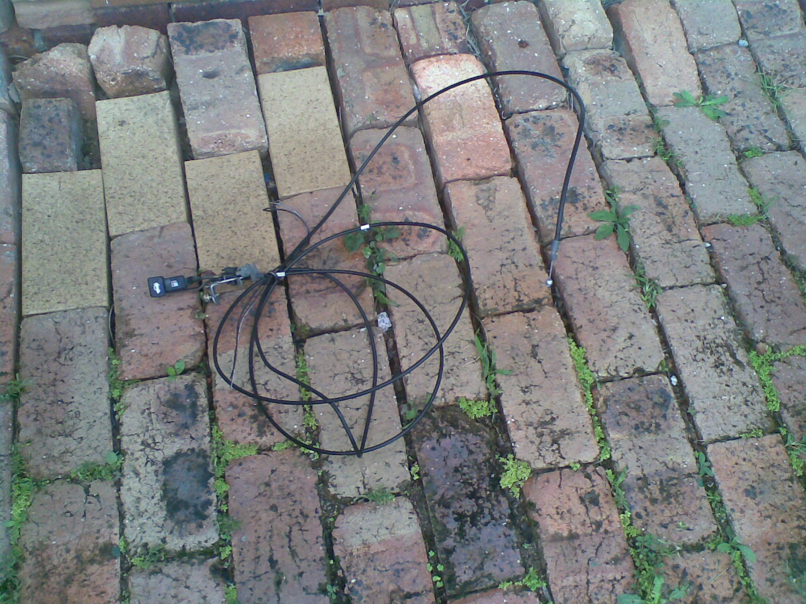

So I went to the wreckers anyway to get the boot release cable and popper. Since KE70's and the Corona's of that age are pretty rare, I had to look into the AE82/AE92. Turns out that the cable is the same as the KE70 ones but the popper is differant. Its actually better as it mounts to the side instead of above like the KE70 one.
On a different not the AE92 sedan I was digging though was in an accident. It had lots of broken beer bottles and bundy cans. Thinking that the driver was drink driving and crashed, it made my decision easier when I pulled the drivers seat out and found a wallet under it. Might I add that the owner didn't have their P's. Was the best $30 i've ever made.
Any pics of the cable before installation.

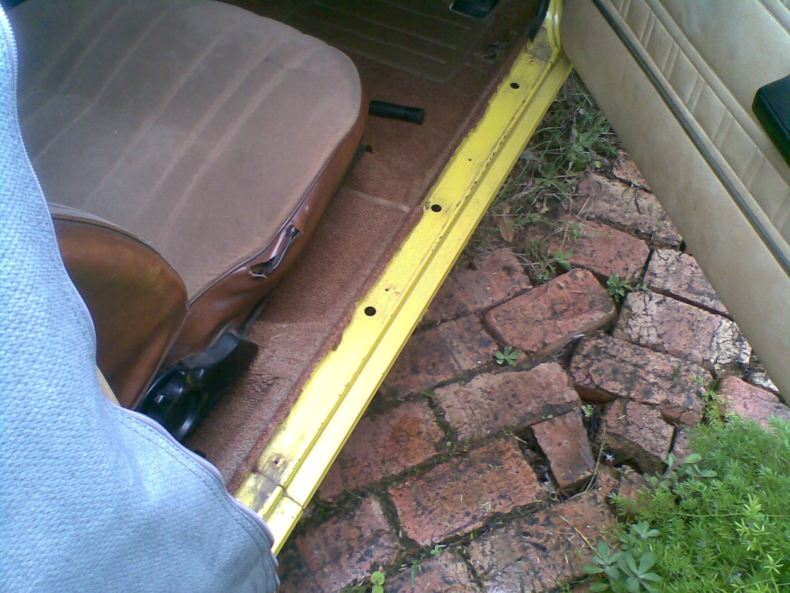

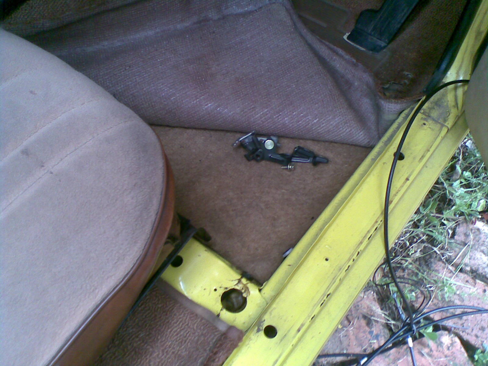

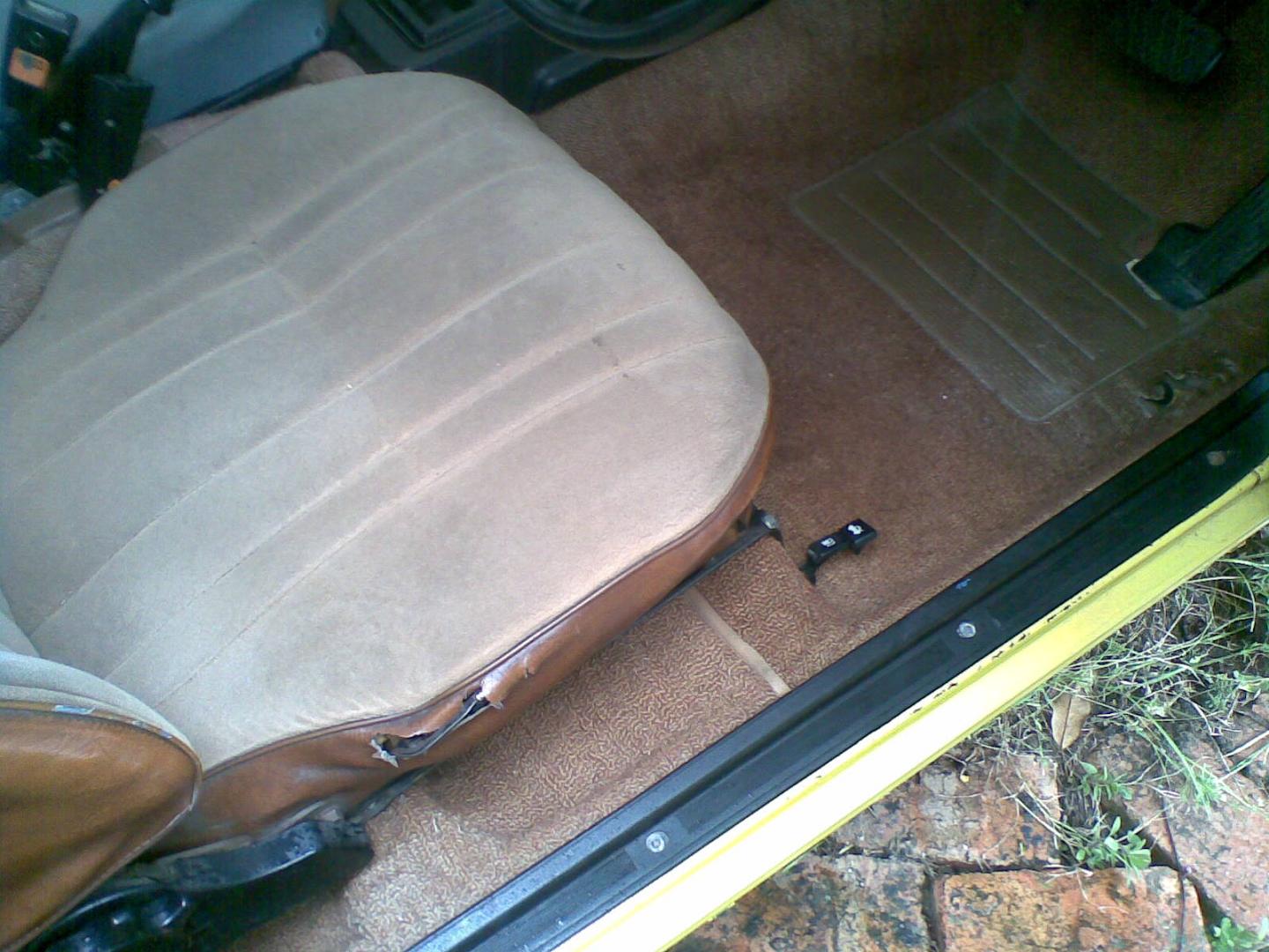

Removal of the sill plate.

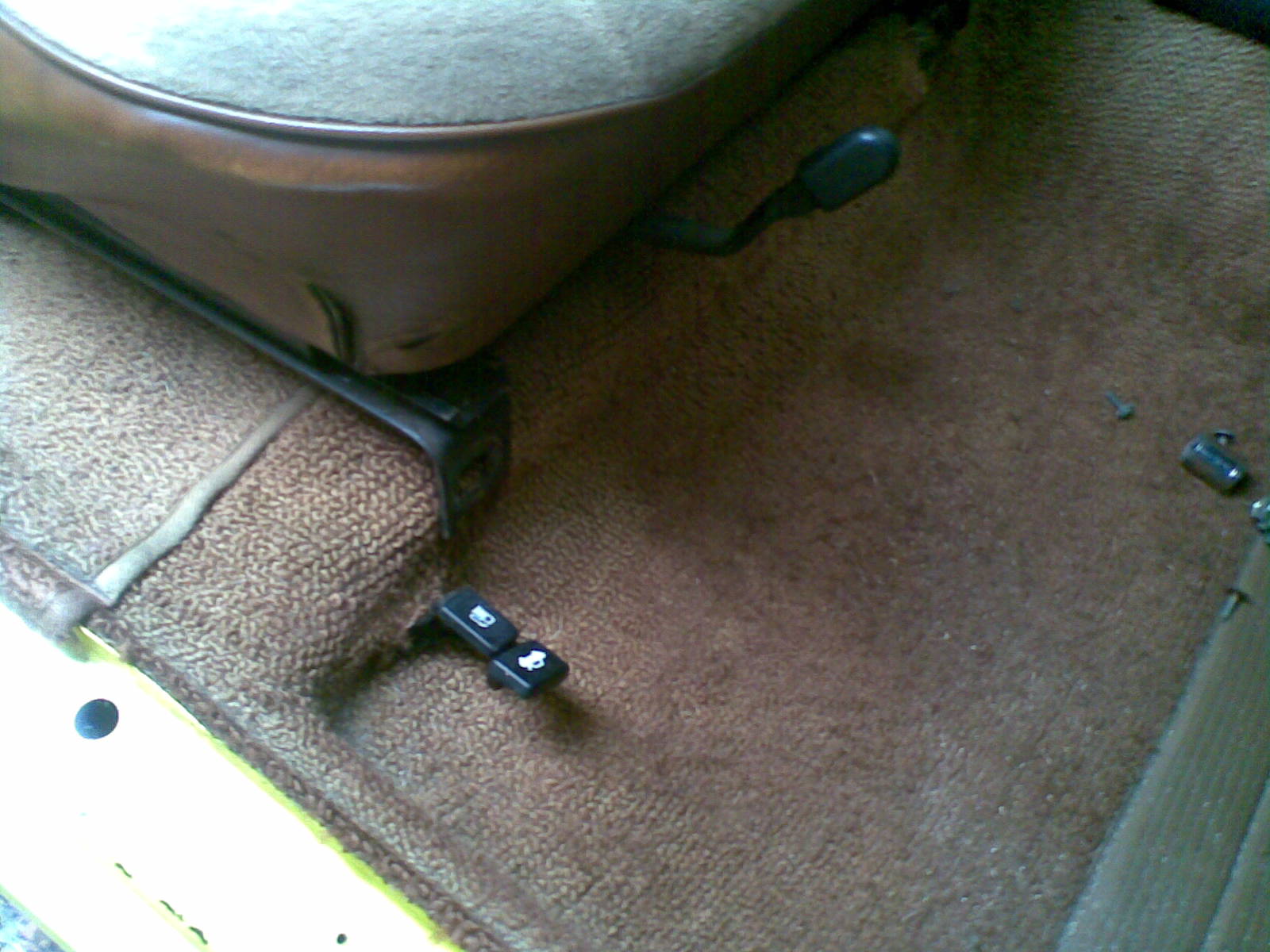

Removal of the front two seat bolts and peeling back the front carpet.

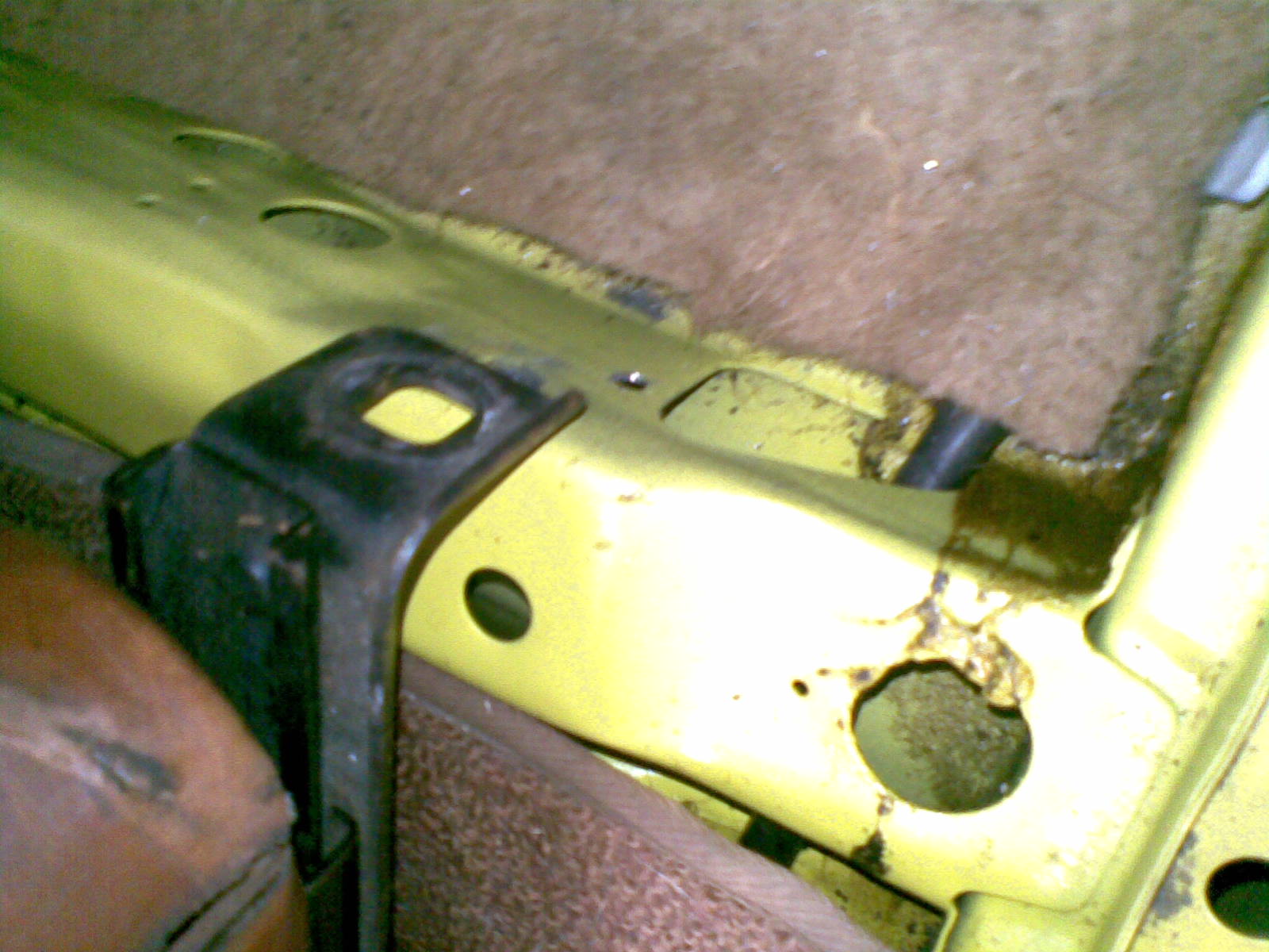

Drilled a hole for the popper bracket.
Fitted the bracket in.

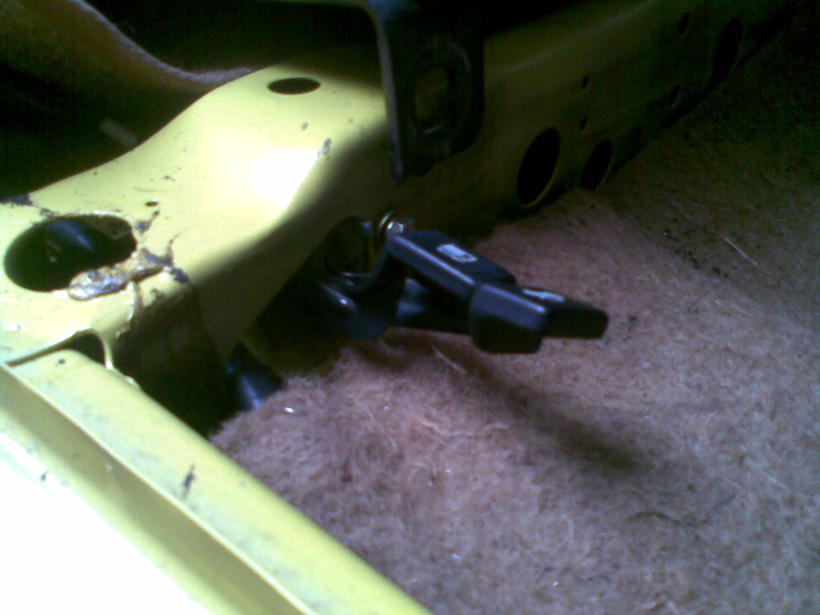

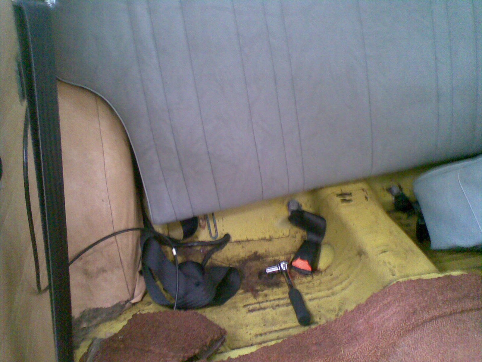

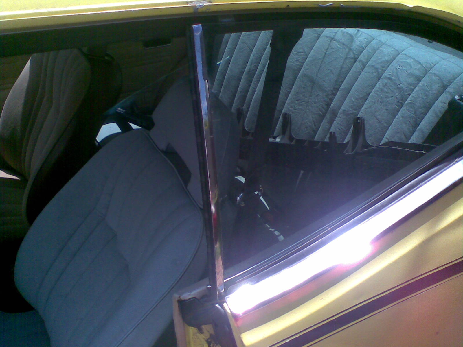

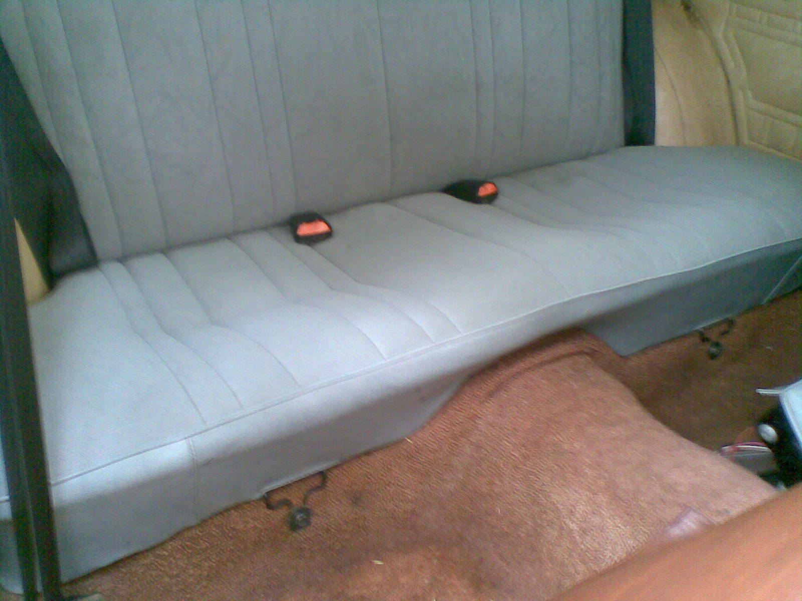

Removed the back seat to thread the cable through. (Stupidly I first go I threaded it though the seat belt)
Seat back in and carpet in place.
Hole cut in the carpet for the popper. I could have angle grinded the fuel popper off but I'll leave that for another day.
