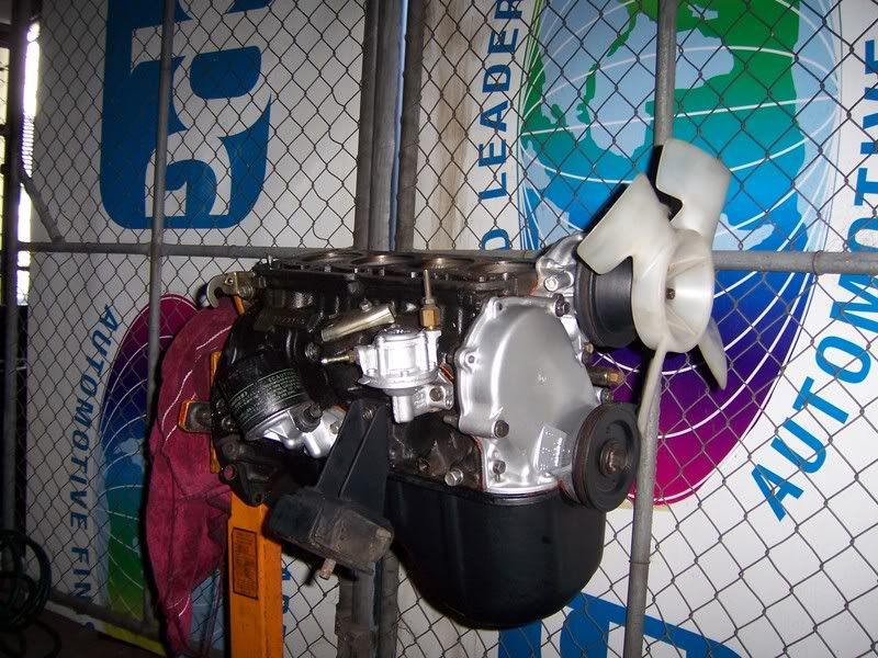

Did some work on the motor for this car on the week end.
Have made a decision on the 4x4 idea: If I get the sierra running gear at a price I'm happy with, it won't be going in this car, I will buy a ke38 wagon for it. The reason, it's all well and good to have the 4x4 stuff under a sedan, but when it comes to practicallity, The van will hold 4 or 5 people + 4 peoples worth of stuff for camping in the back of the wagon!! The wagon also has a lot more roof area if I also want to put roof racks on it.
Anyway, got the 3k off leigh on Saturday, stripped it back to a bare block. Took the 3k head in for machining this morning, won't bother porting it yet.

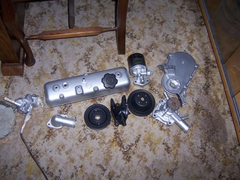

Painted crank pulley, water pump pulley, oil cap and lower half of thermostat housing matt black.
Painted tappet cover, timing cover, top half of thermo housing, fuel pump and oil filter mount "aluminium" - same colour as the dash in the good car.
Got all the gaskets to put it back together, so will probably have this motor built later in the week. Just gotta wait for the head to come back.
Will get some pics up soon. :P

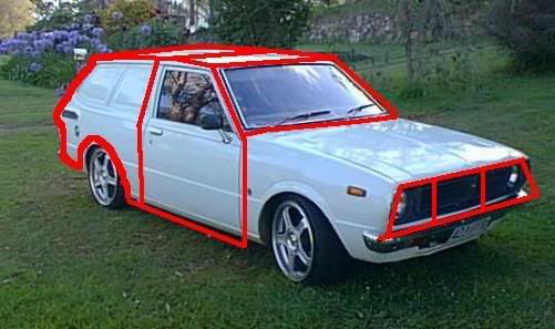

As for the planned ke38 4x4, what are peoples thoughts on an external roll cage!?
.....Hang on I'll do a quick paint drawing to show exactly what I mean. :P
pretty rough, but you get the idea......
would basically be a 6 point cage with vertical supports on the A, B, and C pillars. At least a horizontal support across the top of the front and rear winscreens. Maybe across the bottom of the front WS too as pictured. Do know if I'd go around the rear wheel arch or not.
Oh and I'd probably put a little bull bar on it too, with maybe a winch. Wouldn't be anything big enough to pull a cruiser out of a mud hole, but enough to be able to pull the rolla out of what ever it gets stuck in. :P
painted bits....
Got most of the bottom end done last night.....
Head should hopefully be ready today, so might put that on tonight.

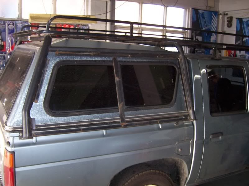

Also just on the external roll cage again, this was down stairs today. Basically what I'[m thinking, but have the bars go all the way to the sill.
Why would you use an external roll cage? wouldn't an internal look better and be more practical?
Well if its going to be used for camping, the external cage can be used to hang gear from.
Very useful when 4WDing, especially with limited internal space.
Sounds like a mad little project. Good luck with it
Yeah thats half of it really, if I have a rack on it like that above pic of the navara, then its heaps of roof space with a good weight load potential, hell you could have a couple of people sitting on it roo shooting if you wanted!!
The other reason for the external cage is not so much practicality, but protection and piece of mind. Once this car has hauled all the camping gear into the camp site, its then there just for fun like the 4 wheelers! :P so with the external roll cage I can roll it down the side of a sand dune 15 times and probably still drive away with every pain of glass still in it!! :wink:
