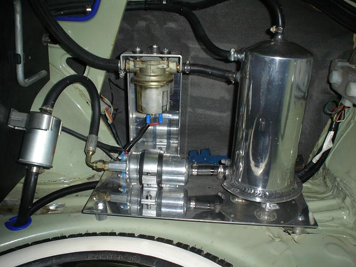

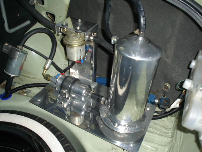

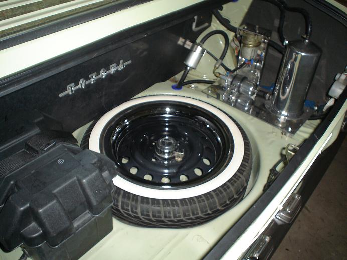

pretty sweet setup dude! if you could pop some pics up of your fuel system that would be fantastic!

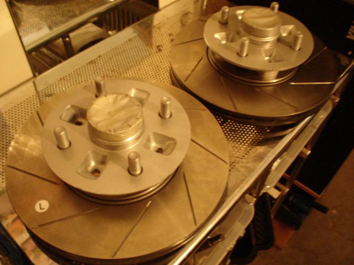

Hi mate, here are some pics of the fuel system , i run a suge tank , bosch 910 pump and carter pre pump. I recently got some new rotors so i chucked them in too.
awsome mate! ok sorry for the noob question, but is the surge tank under your fuel pump and stuff? wicked set up though mate, mite need rip it off for my car! :P
