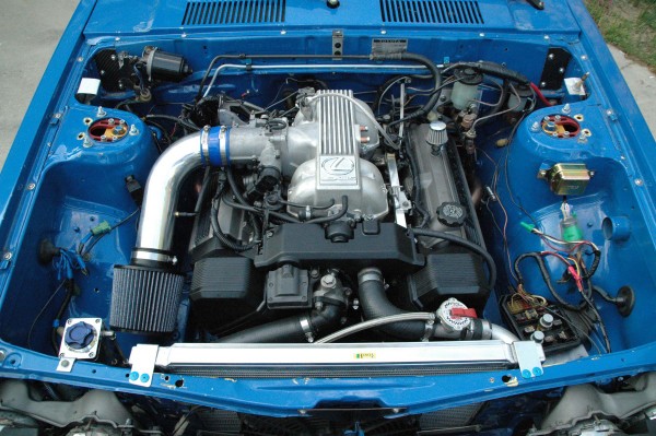

1uzfe *e7* attempting to turn under brakes.

here is a bit of a sneak peak of josh youngs car.
