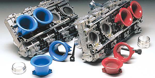

love to get my hands on these 'Keihin' carbs
theyre supposed to be fuking awesome... though never seen them for sale anywhere....
I know someone who's sucessfully tuned a set of Keihan moto carbs on a 4AGE. He has the advantage of working on lotus sports cars that run similar carbs, using the lotus visualisation software he got them running perfect. On a dyno this thing has hit 10,000rpm pulling around the 170bhp mark from memory.
