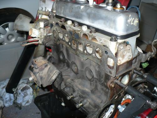

Ok. So I've got the panelvan and the engine out with help from Chris. I've got no tools to take the torque converter off the gearbox haha. Soon we'll be putting the 5k into my sedan along with the extractors. Here are some pics.
Tried to give it a bit of a polish but it didn't turn out that great. Meh.
The torque converter come off the flex plate, not the gear box.
If you want to removed it there is a little plactic cover that clips into the backing plate. Remove this and it gives you easy access to the bolts that hold the torque converter and flex plate together. Turn the motor over to get all of them.
Only tool required is a a ratchet with an extension and 10mm (IIRC) socket.
Where is the backing plate? I have no idea hey. :P I have a 10mm spanner... haha.

Got the torque converter off and replaced rear main seal and timing cover seal and cleaned the engine up a bit more. Also replaced sump gasket.
There ya go, Chris! Sump might not look that clean, but it is a lot better than what it was before...
