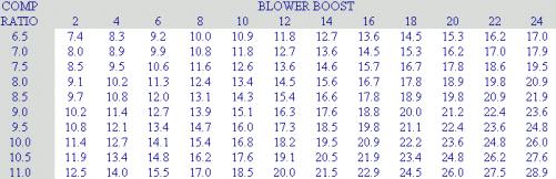

[email protected] Posted April 22, 2008 Author Report Posted April 22, 2008 the estimate that you say sounds ok :hmm: but why do all these lines have to be re-positioned. it all sounds a little to complex for the power output. on the other hand if the engine was N/A, all balanced with a compresion ratio of 10.5:1 this should begine to keep up with a charged 4k. it would rev a lot higher 8000+,+ the cost of the work. i don't think there is a simple way round this. turbo is bolt on but can cost. i hear all the time people using a standard 3k head. 3k use flat top pistons with dished heads, 4k do both flat top and dished pistons. so what happens if you use a 4k flat top piston set up with a 3k standard head, does it work or should it just be shaved 40-60thou. corect me if I'm wrong i don't have all my ke knowledge with. Quote
tenyearguarantee Posted April 22, 2008 Report Posted April 22, 2008 the estimate that you say sounds ok :hmm: but why do all these lines have to be re-positioned. it all sounds a little to complex for the power output.on the other hand if the engine was N/A, all balanced with a compresion ratio of 10.5:1 this should begine to keep up with a charged 4k. it would rev a lot higher 8000+,+ the cost of the work. i don't think there is a simple way round this. turbo is bolt on but can cost. i hear all the time people using a standard 3k head. 3k use flat top pistons with dished heads, 4k do both flat top and dished pistons. so what happens if you use a 4k flat top piston set up with a 3k standard head, does it work or should it just be shaved 40-60thou. corect me if I'm wrong i don't have all my ke knowledge with. superchargers are not very thermally efficient, the newest roots max out at around 75%, most older roots brand new max at 65%, second hand who knows, 50%? they give nice low down torque which is why people use them, i don't think you'd get so much of that if you ran n/a, you'd have to increase the stroke or something. They have a nice sound too which is pretty cool. You could try a centrifugal s/c, they are small like a turbo, look like a turbo, almost as efficient as a turbo and don't require the throttle to be moved like a turbo. they only really shine at higher revs tho like a turbo, so you may as well go turbo... Quote
Felix Posted April 22, 2008 Report Posted April 22, 2008 (edited) From the research I have done an SC14 is can flow enough air for for power levels of up to 230hp. On a k series motor you would probably never get that far though. You need to lower the compression ratio of a motor to be able to run high boost levels, to avoid running into detonation issues. Probably the easiest way would be with a thick copper head gasket, or opening up the combustion chambers. A draw-thru setup with the carb in front of the blower would be the easiest system to setup. Though you wouldn't be able to run an intercooler which would limit absolute power. Supercharged motors respond well to headwork and a cam like in NA mode. 8 psi on a worked motor is going to make a hell of a lot more power than 8 psi on a stock motor. The best I have seen was an SC14 on a highly developed mini 1275 motor (think opened up to 1380), running in drawthru mode with a 2 inch SU carb. The mini ran a 12.8 sec quarter on slicks. Edited April 22, 2008 by Felix Quote
