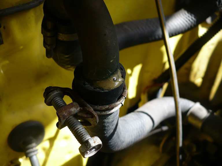

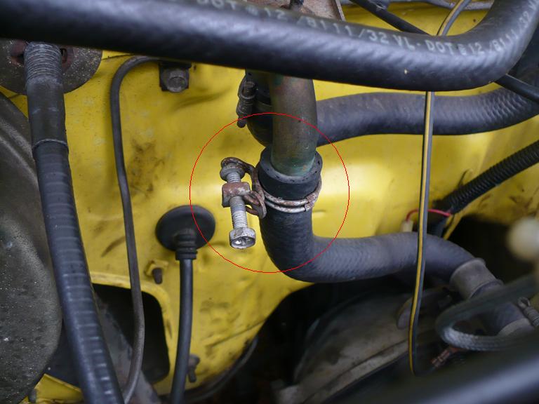

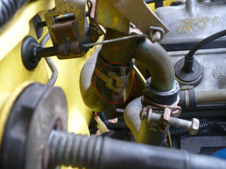

Ok I tried to pull some hoses off but they're stuck on well!
I couldn't get this one off after unscrewing the clip enough to make it loose (as in yes I got the clip loose, but the hose is like fused onto the pipe or something :lolcry: ):
And this one has a weird-arse clip that I'm unsure of how to loosen/remove:
Any help is appreciated. :wink:

Many old Toyota taps are the same, go to repco and try to get a new one, they might have one there aftermarket. Old stuck on hoses are very hard to get off and the heater core is fragile, as is the tap, so don't just pull on them. Get something spike shaped and poke it carefully under the lip of the hose and gently prise it free. The just grab th hose and TWIST it, it should pop off very easy once you twist. I you have to cut the clamp off the go and get a hose clamp for it of course.

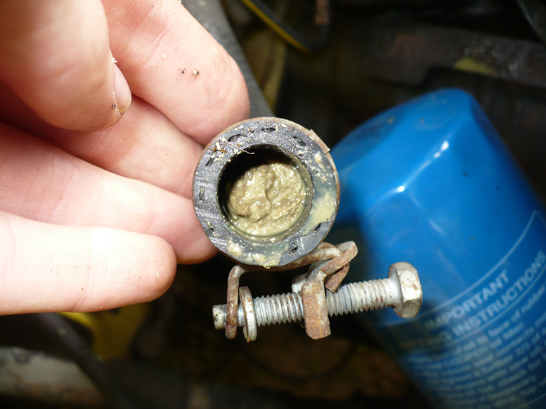

Blockeeeed! :lolcry:

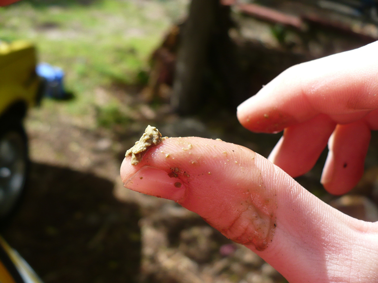

I got the hose off with a flat head screwdriver and my hands of steel ( heh... ).
I got some on my finger! Gross! It smells like... clay and female juices.
It's blocked.

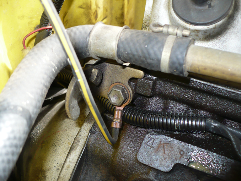

I shrunk myself to the size of a small insect and went in with a bucket and a toothbrush. Haha nah I went in with a toothbrush and thought it might just be congested towards the end of the hose... but I scooped a bit out and I'm pretty sure the whole f^^^ing hose is blocked. What do I doooo?! I can't take the hose off cause of those weird clips.. I dunno how to get them off. Also there's this wire thing that attaches to a metal clip just below the hose... the wire goes to the firewall and looks like it's pretty important... I'm lost guys!
Edit: The wire that attaches below the hose:
Another Edit: I squeezed some huge radiator hose (haha) and the clayish crap got flushed out of the heater tap, followed by radiator coolant. I honestly didn't think that would happen haha.. I was expecting the hose that went from the radiator (or whatever) to the heater tap to get flushed but either way I'm pretty sure the tap is clean now. All I gotta do is clean the hose that goes to the tap from the radiator (or whatever). The only thing is... how can I be sure the blockage doesn't go further down into the radiator??
Edited by Mybowlcut
Hahaha, go down to your local auto parts supplier and get yourself some radiator flush, read directions and hope for the best :wink:
While you've got the hose off start the motor and let it pump the water out and any other shit that is in there too.
By the looks of that the hole cooling/heating system is going to need a really good flush or two or three :lolcry:
That wires just an earth wire, but it needs to be there.
Edit: While your at the shop get some hose clamps to replace those dodgy factor looking things

Edit for your edit: Will do... factor looking things? You mean those pin things? How do I get them off? :wink:
Edited by Mybowlcut
Needle nose pliers in the round end of the pin and twist and pull maybe? or an angle grinder :lolcry:
