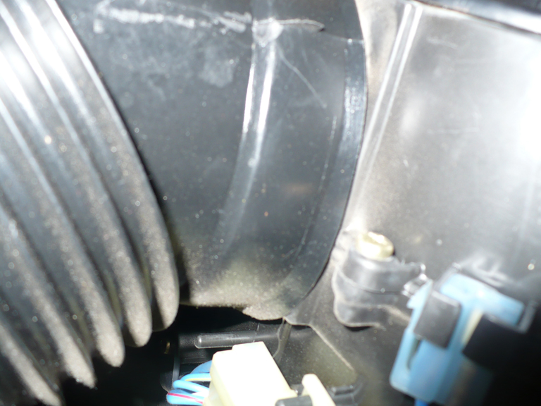

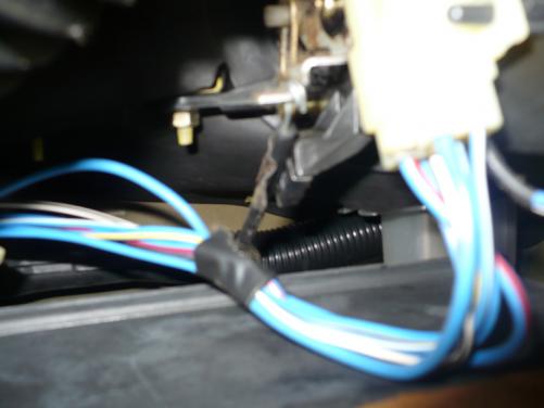

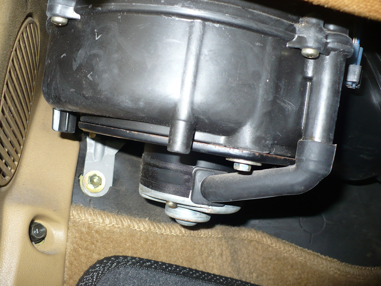

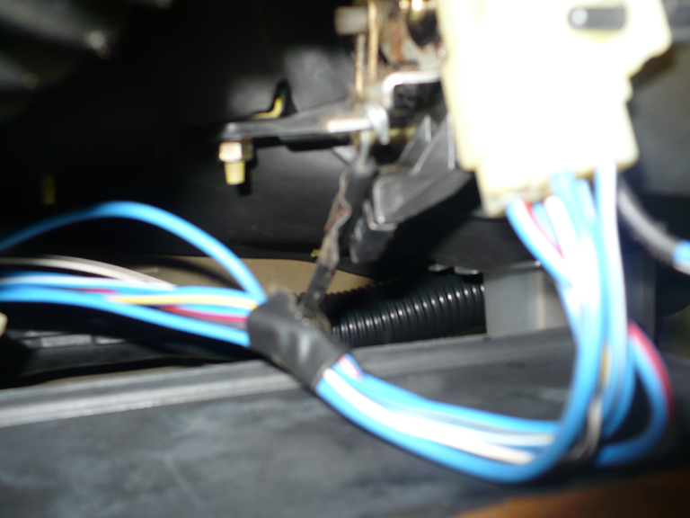

Here are some photos I got just so I can figure out what parts they are:
Is the tap the first picture (upper right corner) and the core the second one?

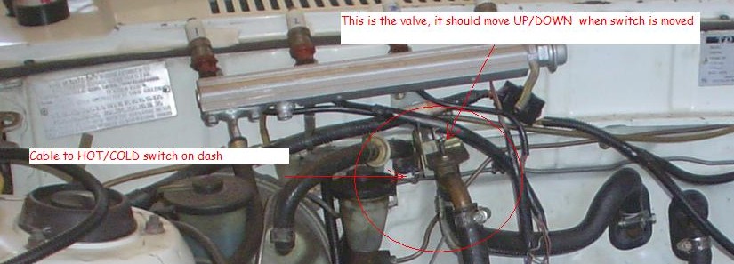

It all looks to be connected as it should be, check that the switch on the dash is actually operating the tap before you pull any thing apart, could be broken or disconnected at the tap.
The cable on my old KE70 was broken and the tap was in the off position so no heat, pulled or pushed the tap the other way in or out can't remember. I just left it open during winter and closed during summer :yes:
The second pic is the fan? I think. The heater core is in the black box directly behind the center console/on top of the transmission tunnel.
Cheers Dan

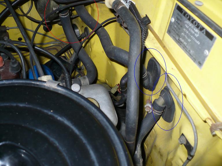

Heater tap is circled in red
Heater core in/out circled in blue..

So I would check if the switch is broken at the tap end in the engine bay? How can I test if it's broken? What cable/switch would I look for? I know this might be common sense to you guys but I've never dabbled with heaters before. :no2:
Yep, you are all spot on, the tap might just be stuck. If you don't use it for 6 months its conceivable it could just fail. Tidy looking car btw.

Get someone to operate the HOT/COLD switch on the dash and you watch if the valve is opening or closing, basicly if the stuff attached to the tap is moving it should work. Might want to give it a spray with some WD40 or similar.
