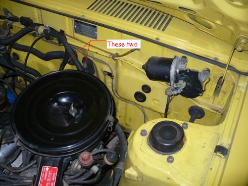

Might be a good idea to pull the rest of the heater hoses off and check them for blockages. Stuff the garden hose in the end if you have to. Same with the heater core, re-move the two hoses at the fire wall jam the hose in the passenger side (out let)
and see if you can't get some flow happening. Might want to check the thermostat isn't full of crud too.

If you pull these two hoses off, stick the garden hose into/over one the pipes thats coming out of the fire wall then you should get water coming out the other side. It will be going through the heater core, no water coming out = blocked heater core or wet floor :jamie:

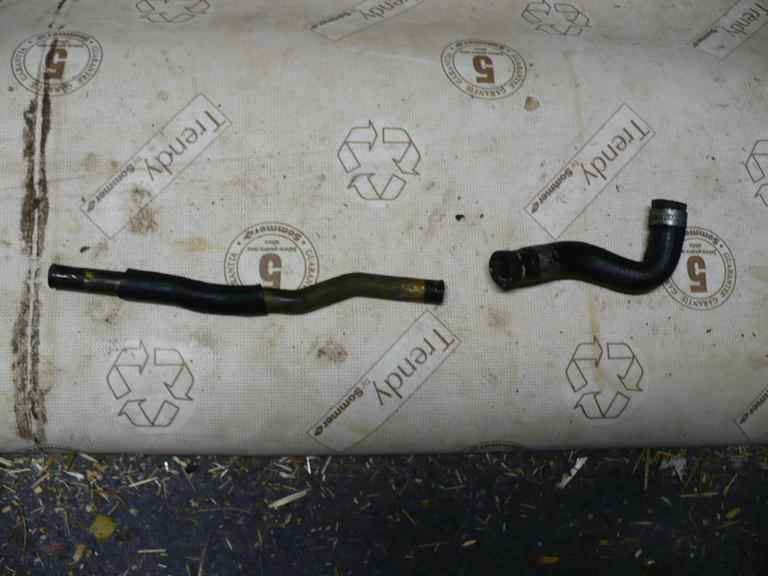

Got these hoses off and cleaned them...
There's just one more hose left and I gotta pick up a bypass hose and then I can test it out! Thanks for all your help, guys! This is the first semi-mechanical thing that I've done on my own (with your help) and it was pretty fun although annoying at times. :rocknroll:

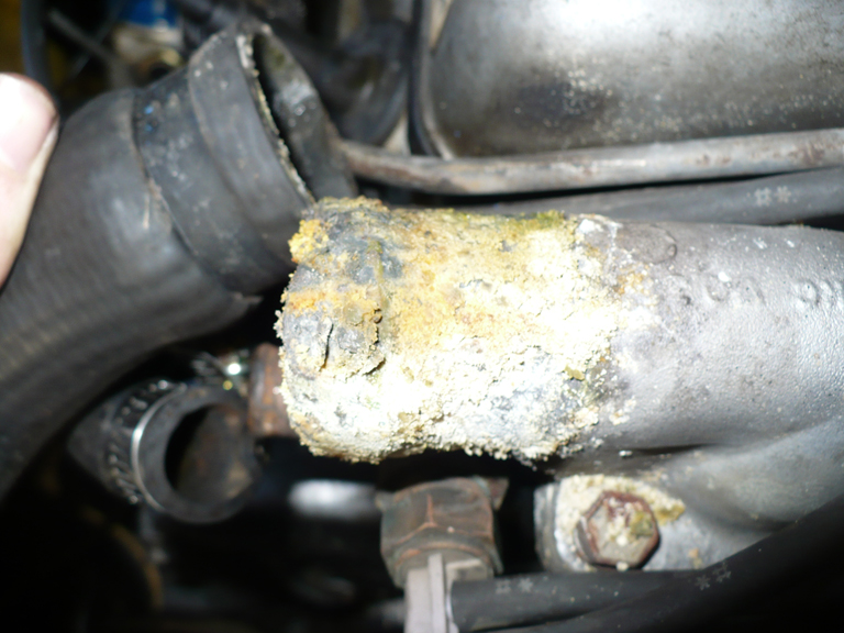

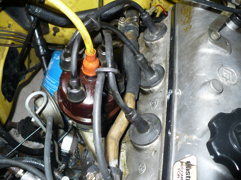

Question: Can the pipe (on the left hand side) in this picture touch the distributor (the distributor has the 4 spark plugs going into it, right?)? It has a rubber casing in the middle of it if you look at it closely. I'm just wondering if it's meant to sit against the distributor to prevent some sort of electrical mishap? At the moment the pipe's metal touches the distributor.. just wondering what to do in this situation; if it's fine to leave it the way it is.
Cheers.
Edited by Mybowlcut
Cheers.
Nothing really should be hitting the distributor.
Do you mean: it's not safe for something to hit the distributor OR in the photo there is nothing touching the distributor that will harm it?

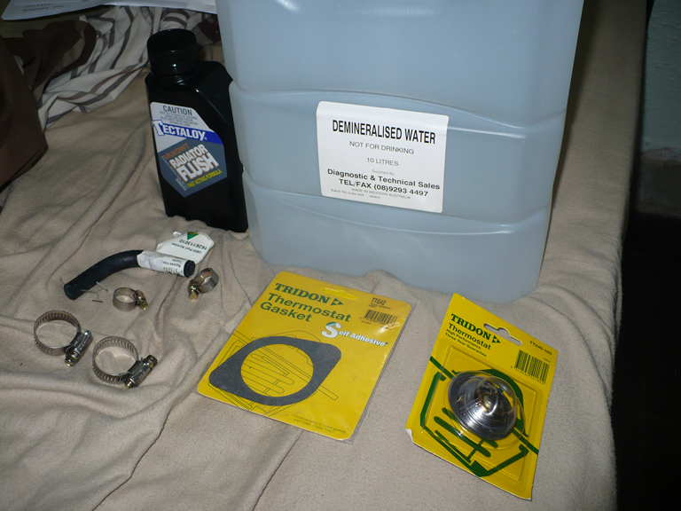

Haha. I woke up really early like 4.40 this morning cause of a freaky dream. I ate and then sat on rollaclub for a while then went out to the shed, put on the radio and started putting the bits back together. I had money so I figured I'd take dad's car and go to Coventrys and Veale auto parts. I got a ke70 bypass hose ($8.00), two hose clamps for said bypass hose($1.20 each), 2 (bigger) hose clamps for replacing those weird clips since they look gay and are a bitch to get off (@HRV-00S I used a screwdriver haha) ($1.80 each), thermostat ($11.94) and thermostat gasket ($2.02), 10l of demineralised water ($14.00 - EXPENSIVE!) and Tectaloy Muckowt ($8.00). I didn't know the brand that makes it.. I was searching on google and couldn't find it for ages haha.

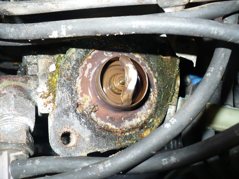

So, I'm going to take a picture of the thermostat wherever the hell it is haha and post it up! :jamie: Then hopefully you guys can help me out with how to install the new thermostat (and new gasket if I need it?). :y:
I think I need a new one of these... haha:
Oh, also... what's better for the radiator... coolant or demineralised water?
Cheers!

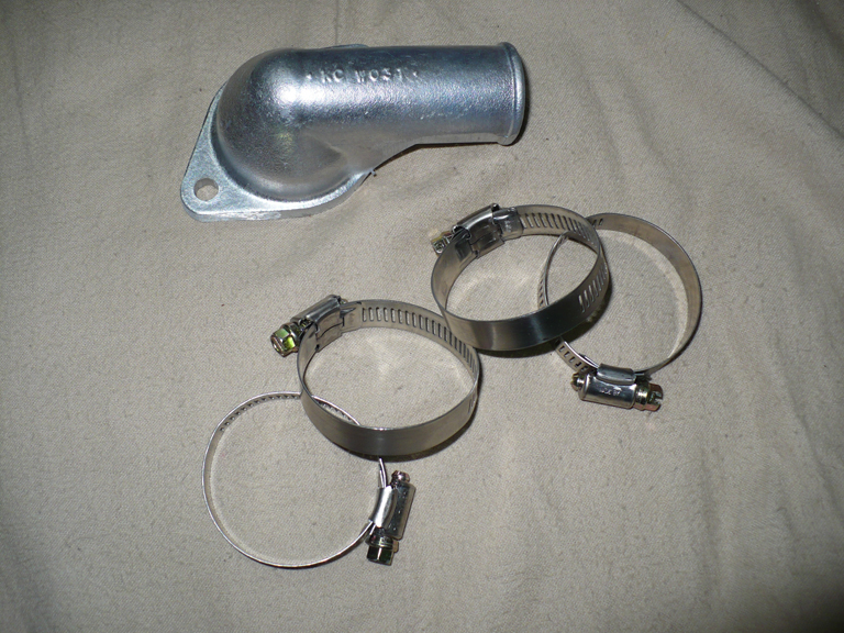

Clamps were $2 each from servo and Thermostat Housing was $27.61 from Coventrys (I must have got the trade price with the thermostat and gasket!)
Any tips on how to install this baby would be great! Or just advice on what NOT to do... i.e. if there's anything to do first, etc...

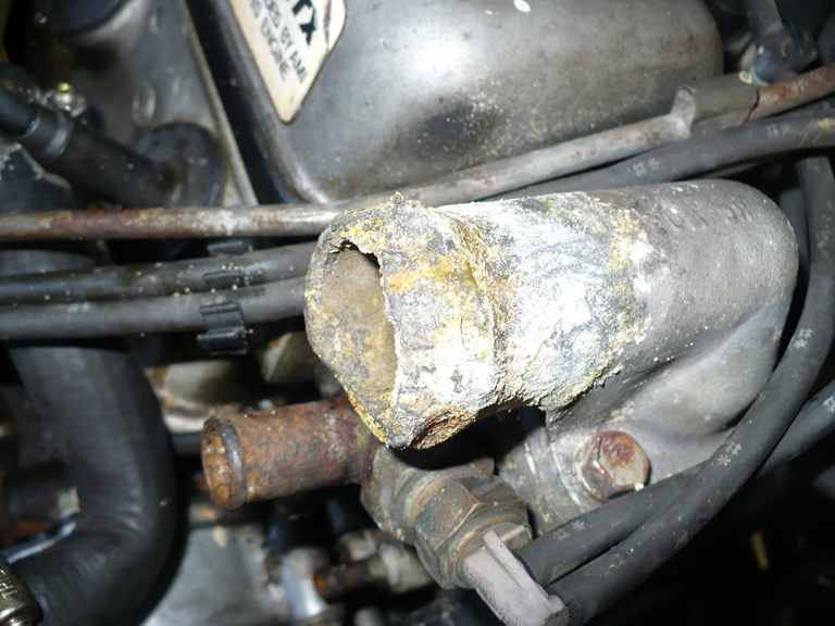

Where is the thermostat?? Where is the thermostat gasket?? :jamie: I can assume that the gasket naturally wore away haha... but the thermostat... is it that thing in the middle? If so, is it supposed to come out? Can it come out??

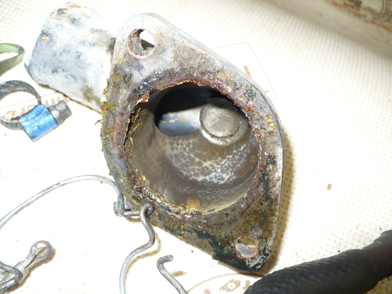

The old thermostat housing... yum. :rocknroll:
