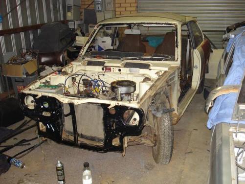

I got stuck into this beast again today, with some good results :yes:

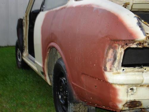

Main shell should be in primer by next week, been working on the rear guards, woken up to the fact they will never be perfect.
Since the last update I have moved house, I drove it as it was in the last set of pics the small journey to the new place. it went really well.
Today I sanded back the last lot of filler I had applied to the rear end. Once that was done I took some rust convertr to the areas with surface rust.
Finally I mixed up some primer filler and put it through the gun on the rear guards.
Pics!!
