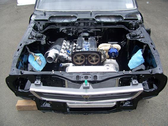

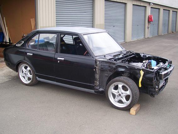

  • cheers guys, will try get some more pics up soon, can't get it out of the shed at the moment as the house is getting renovated and theres scaffolding in the way
  • Heart transplant complete!! now just need to patch the hole i had to cut out of the firewall lol main thing is shes in there!
  • few more updated pics, everythings such a tight fit, had to trim a few bits here and there but its all tucked behind the grill so I'm happy!
Where did you get your alloy rad from?
got the radiator from realdeal radiators in henderson, Auckland

small update, been on hold for a bit but heres a couple more pics

thought i better update this, car has been very slowly getting worked on over the last 12 months due to me working away from the car but things a finally starting to pick up now that i have some time and funds. Exhaust, plumbing, feul system, brakes and suspension are all done.
heres a few recentish pics from towards the end of 2009 i took, will have another update in a few weeks after the dyno tune!!
Oh dear god, I came.
Such a nice car man, engine set up is very tough and should get this thing moving
Love the gilmer setup looks porn.
dream setup right there mate...sept i want it in a ke25 coupe delux mmmmm tasty. but 4 door ke20 would do lol
