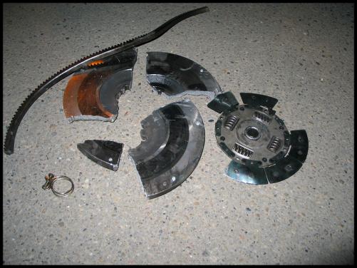

:hmm: at comentry on first vid.
smeg yeh! hell not keen for my bonnet to blow out like that ay! that would really f*ck it,
also :) at the commentry
"and we can tell you what that was people, thats called a flywheel explosion" hahaha

yes they do explode, but rarely and only when the people that lighten them are going to the limits and take too much out in the wrong places.
ive heard of one apprentice machining one who lost it on the lathe!
took heaps of meat out near the bolt holes. idiotic because
A. its the highest stress point.
B. the most effective weight you remove is from the outmost point, rotating mass etc...
C. imagine how thin it has to be losing it on the lathe, imagine if it had gone back into a car!
so be careful who does the work.

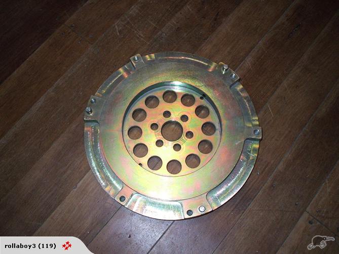

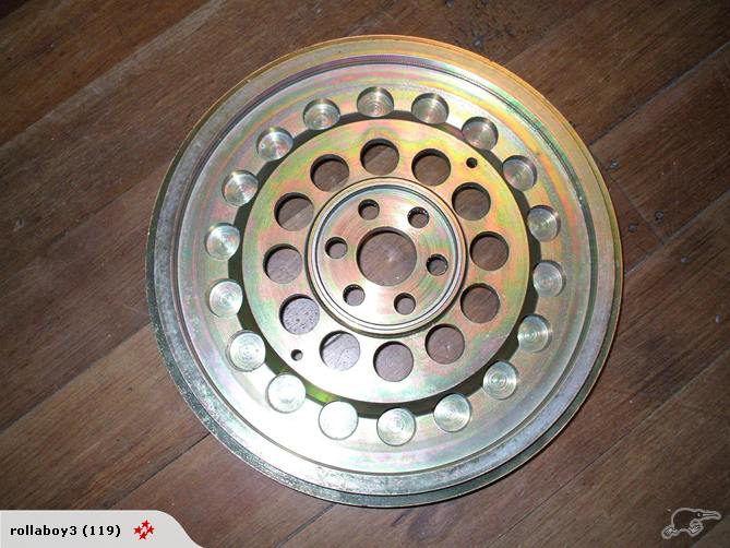

Also below are some photos of swiss cheese I found a picture of. Is a stock flywheel for a K motor lightened etc. This was run on a 5K with SC14 only ran because a blower acts like a flywheel other wise it was so light the motor pretty much didn't run. Was a mean machine photos below of front and back of flywheel. It was cad plated after machining.
Cameron
Where's the ring gear!?
I think its a custom machined piece. I don't think anyone dare machine down a cast flywheel that much. The ring gear will probably be machined off an OEM flywheel and pressed onto this one.
Cutting gears is a pain in the arse!

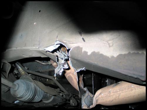

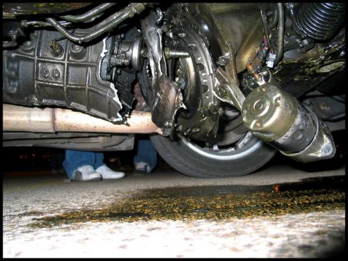

Remember seeing pictures of a flywheel that let go on an R33 gtst. Had a pressed on ring gear that straightened out and went through the engine bay like a steel whip!! Wasn't pretty. That one of the reasons I like the cast ring gear on a K flywheel. :yes:
