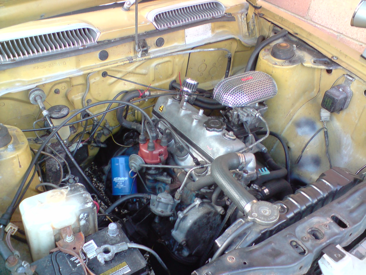

Hey.
On my 5K, there is a hose going from the rocker cover to the air filter. Somewhere on this site I've seen someone get rid of the hose and just chuck an oil breather on. Is there a reason the oil is going into the air filter? Is it better to chuck on an oil breather? And is it legal?
I ask because my exhaust fumes or something smell kinda oily and there is a bit of oil slowly building up around the start of the hose on the rocker cover.
Cheers.
Edit: Found this which answers my first question (oil goes into the air filter because of pressure from the engine pushing it out of the vent thing), but not my last two...

What can I do to stop it from filling up? I've read that it could be something to do with pistons or rings being screwed... How do you make a catch can? Is it just like this? If so I have no idea how to do that... haha. More importantly I have no idea what those fittings are... hellllp? :P

Yeah my air filter is too big.. it hits the breather and won't stay down properly. When I get a weber it'll fit. Is the breather really oily? Have you had to replace it yet?

Everyone's getting confused here, a catch-can doesn't go on the breather, it goes on the PCV outlet. And the PCV feeds to the manifold under the carby, not to the air filter. The oil breather draws air in from the air filter to blow air through the crankcase and head, which then gets sucked out the PCV valve under vacuum into the inlet manifold. The only time oil will get into your air filter is if the PCV valve is blocked, causing the cam cover to pressurise.
A properly set up catch-can takes the PCV hose from the rocker cover, passes it through a baffled can to filter out the liquid, and returns the line to the air-filter/intake. This stops the excess oil from being run through the engine again. You have to empty the can infrequently (more often if you have a lot of blow-by, or a stuffed PCV valve), but it's all legal emissions-wise. Some models come with a fitting on the base so the can drains into the sump, negating the need to manually empty it.
Most people don't do it that way, and intead they just put a little breather filter on the output of the catch-can. Whilst this is better than just chucking a breather filter straight on the PCV, it's still illegal and can result with oil spraying your engine bay a nice shiny black.
If you really want, you can run a catch-can on the breather too, but a better solution is an inline one-way valve so that air can only be drawn in, not pushed out into the air filter.
The only reason I'd run a filter directly on the breather outlet of the rocker cover is if it was a show car that didn't get run. They are for cosmetic value only.
Edited by Hiro Protagonist
A properly set up catch-can takes the oil breather hose from the rocker cover, passes it through a baffled can to filter out the liquid, and returns the line to the air-filter/intake. This stops the excess oil from being run through the engine again. You have to empty the can infrequently (more often if you have a lot of blow-by), but it's all legal emissions-wise.
Most people don't do it that way, and intead they just put a little breather filter on the output of the catch-can. Whilst this is better than just chucking a breather filter straight on the oil-breather line, it's still illegal and can result with oil spraying your engine bay a nice shiny black.
Perfect explanation. :P I'll take the breather back and fork out the money for a catch can if they have what I want.
