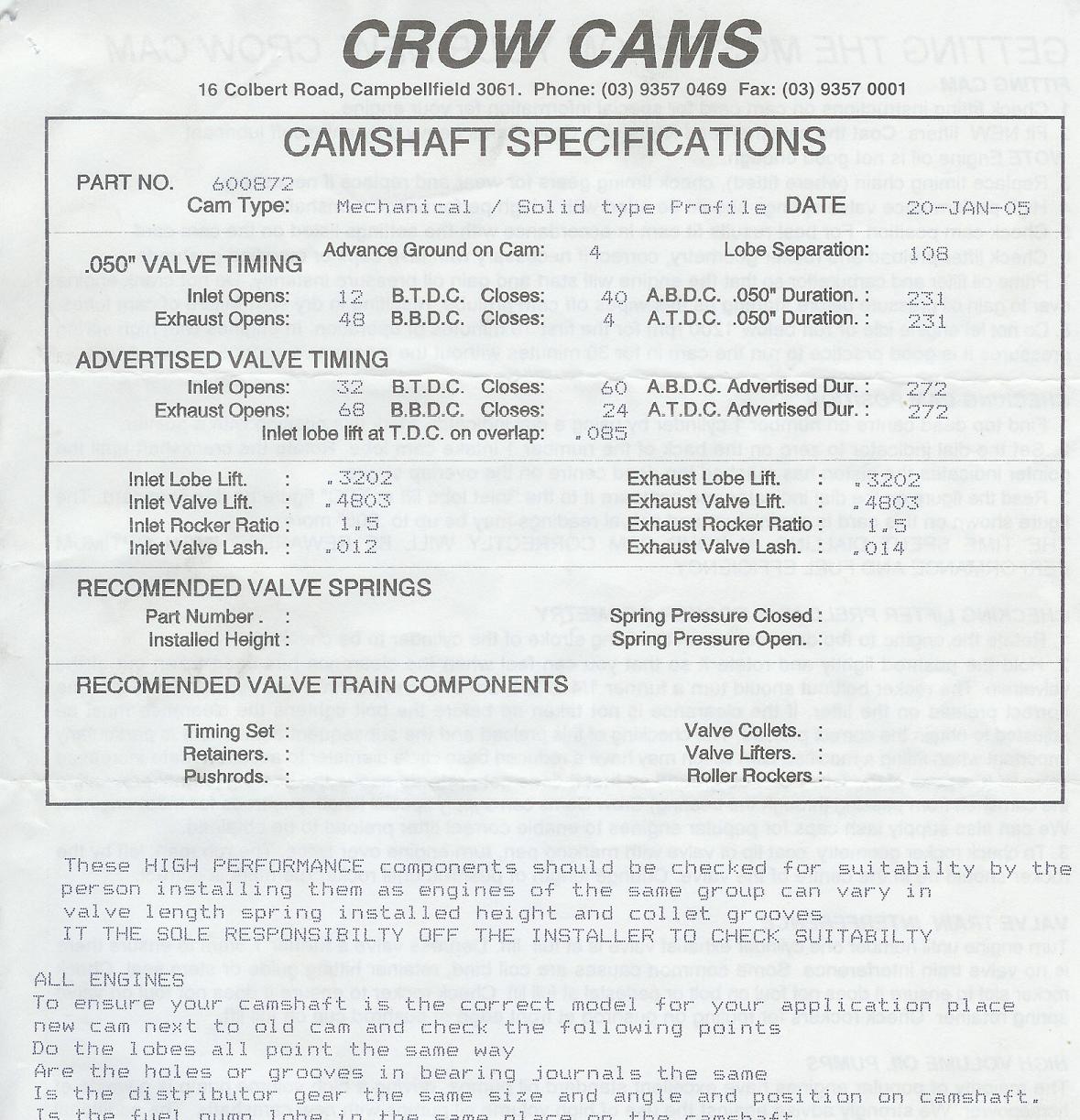

I perhaps would have thought a single 45, particularly with those cam specs you put up earlier (that is the cam you are running?).

Yes - The Crow Cams page is the specs of the cam i am running currently.

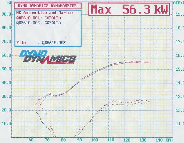

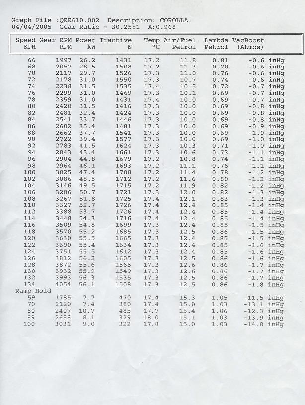

I think i'll be going somewhere else to get the side drafts tuned. The car went in with 56rwkw (full rich weber and glazed rings) - Then once they were finished tuning it, it had 48rwkw (Hrmmm, Somethings not right).

If this was your motor (everyone), how many rear wheel kW would you be expecting or be happy with? I'm a little dissapointed with the 56rwkw that it pulled on the dyno.

what's your cam spec's, 0480" lift seams way to much, that works out to be 320 at the lobe, maybe try a smaller cam, is it a race car or road car?
