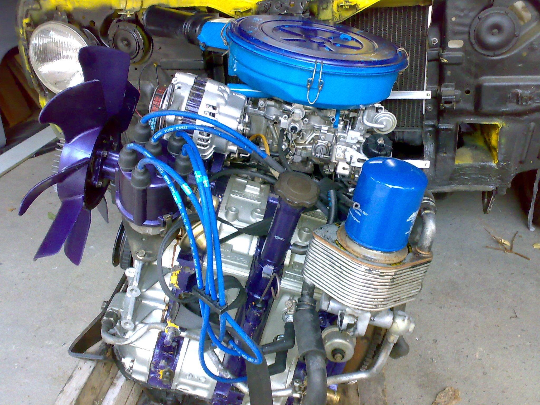

I'm running a 3 row S1 RX7 Radiator which cools fine at idle, but can jump 10-15deg whilst cruising on the freeway.
I'm currently using a S3 RX7 oil cooler that bolts to the block, and has water lines plumbed into it.
I do have a PWR oil cooler up front but i found it took a few seconds to get oil pressure up. Might have something to do with the time it takes to pressurise up the oil lines and cooler before it feeds the engine. Mine set me back about $300. Look on ausrotary, they pop up all the time.
I couldnt really find a neat place to fit a standard S1-2 oil cooler. It was just physically too long/wide to fit up front without chopping the car up.
An auto transmission cooler is not an option.
S3 RX7 Cooler
My PWR Oil Cooler

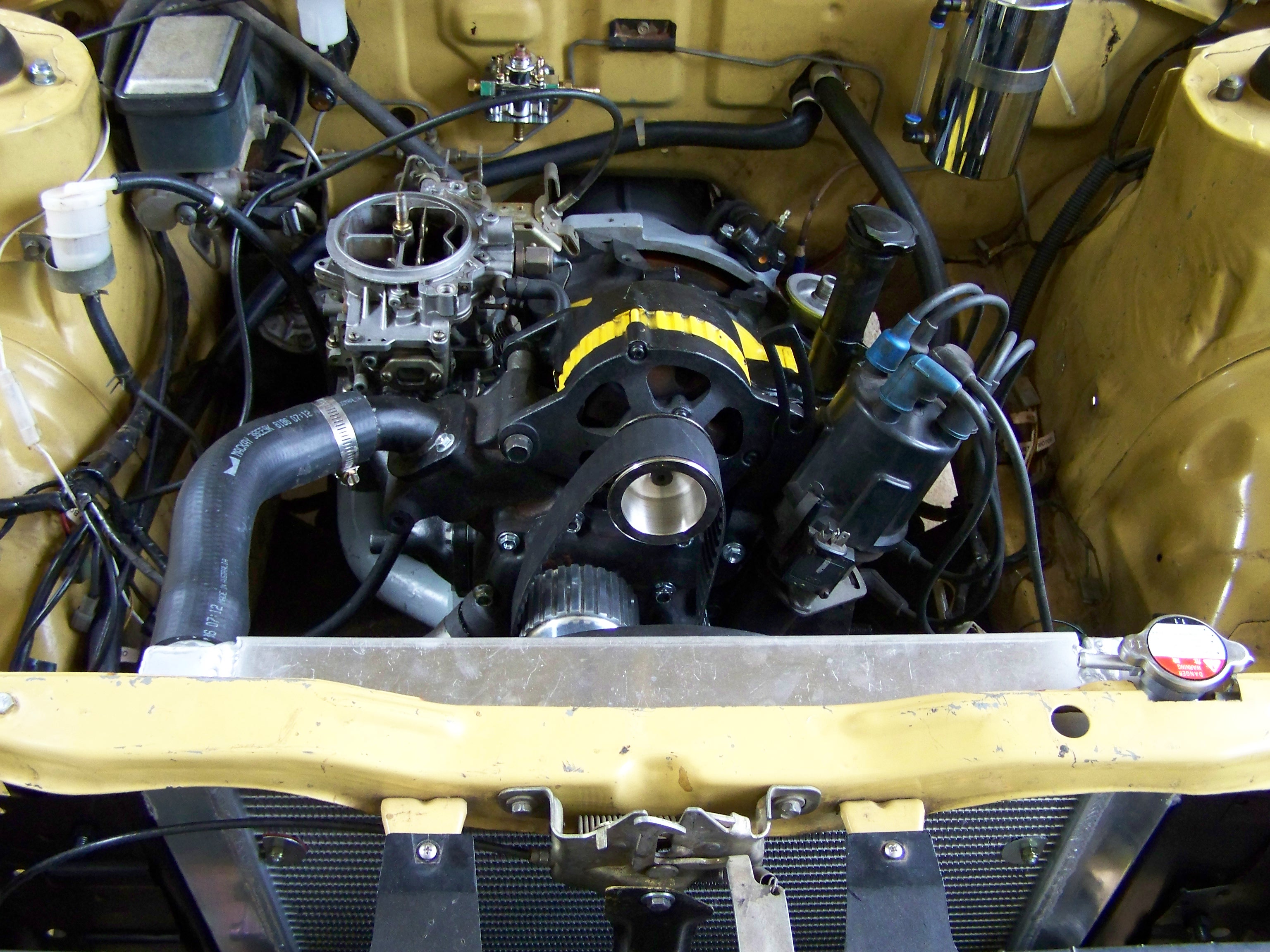

Check out my thread (KE30 Rotorolla - Tech Build) in a day or two for pics of mounting of the engine. I'm actually working on fitting a VL Radiator into mine now (taking a break) so I'll uploads pics later in the week when its all sorted.
S1 RX7 Radiators fit in nicely with custom brackets. However you may need to cut out a section of the radiator support panel to get full air flow over the radiator as its wider than a KE unit.

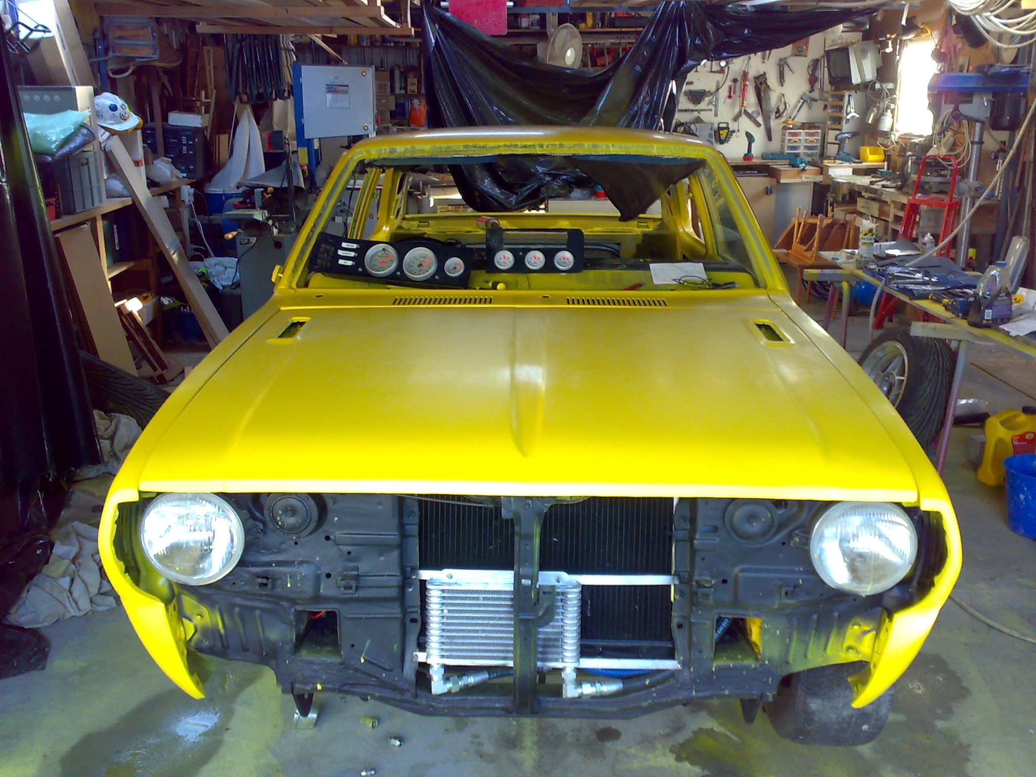

so stuff that are going in over the next 10 days are
gearbox $300
alloy rad $270
alloy oil cooler $300
catch can $50
gilmer drive $250
holley red fuel and reg $250
r31 diff and rear brakes $325
can't think of the other stuff
but i have all the parts ready to go
Sounds like your Xmas break is sorted :lol:
The Holley red was a nice choice. I have them in mine....they're a bit loud even with the soft mounts. Then again the Carter fuel pump was louder.
thanks so much for the help ay its been awesome when its done ill criuse up and meet you take both them out can't waith for your 12abp though
some more pics of so far. i will put a weber on it when i get some more cash. and chrome alot more stuff foes to the rotary shop this monday to get the timing done.
