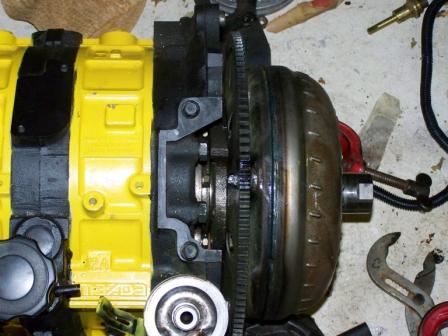

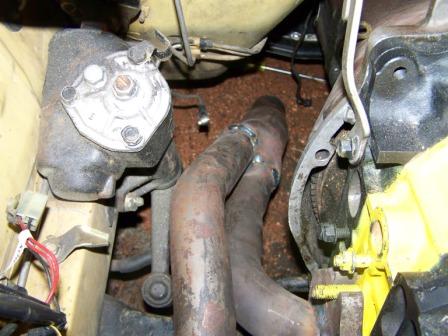

thought i should put some info up on my build.
it wasnt easy to find pics and stuff so i thought this might help ive got heaps of pics to up load
cost....
engine, auto box with cross members and every thing $800
manuel box $150 but may need a new one from rotary shop $700
custom engine mounts and cross member and the headers fab $600
this is all so far.
fare bit of hours though cutting old mounts out ie
ill put pics up soon any question ill try my best to answer

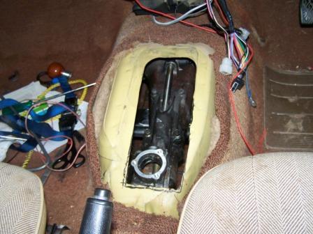

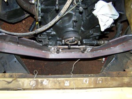

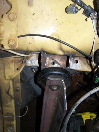

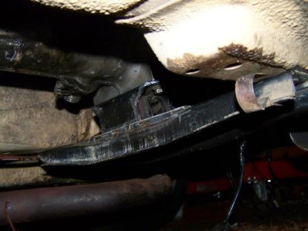

the gear box cross member was the easyest (my welder said) just used the corolla one cut the middle out see were the bolts sat and welded the whole up and drilled to new wholes looks really good
i just need to work out how to post pics and ill show you all
cheers steve-o
oh yea and fly wheel $88 and clutch was $130
slave and master i think $140
need to paint it all and neaten it all up
but thats it so far
had to cut the corolla xmember to fit the rota in
