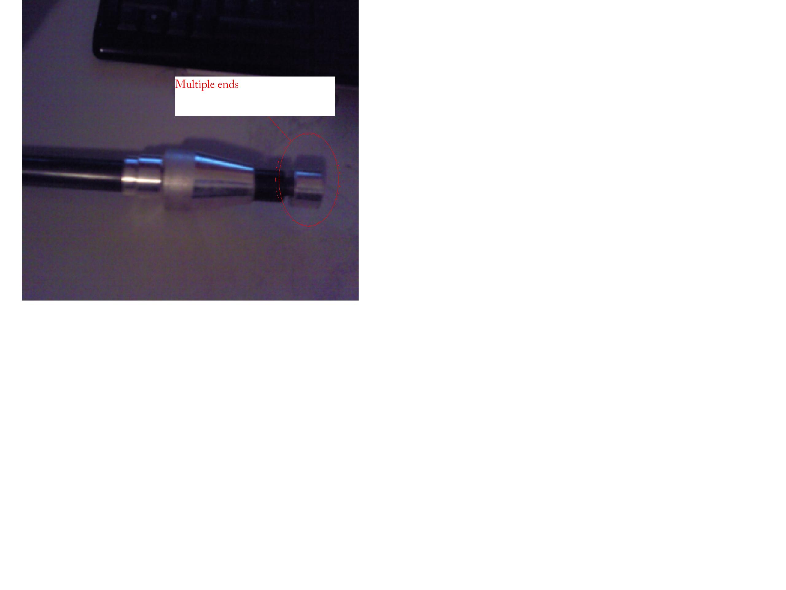

Hey guys, been too sick to work on the ke lately, went back out to align the clutch, using my "special" clutch alignment tool, turns out i have NOOOOOOO idea how to use it......i've got a pic of the thing, and there's multiple little nobs that u can use. I can't seem to use any of the nobs to be able to hold the clutch disk in one secure location....on the box it just shows some dude sticking the tool in the clutch, not much help :bash:
