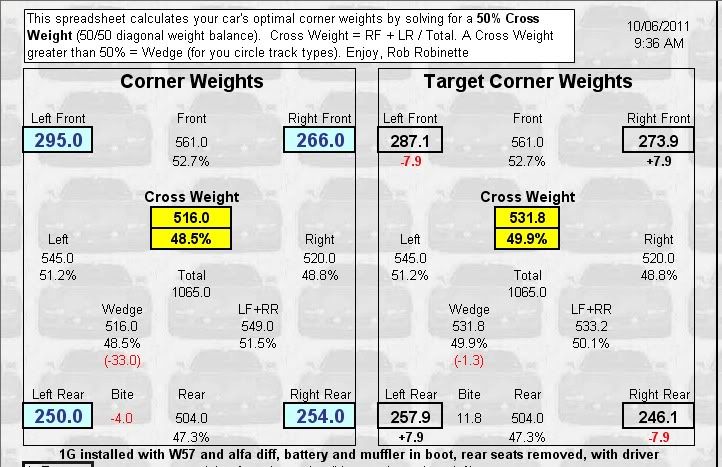

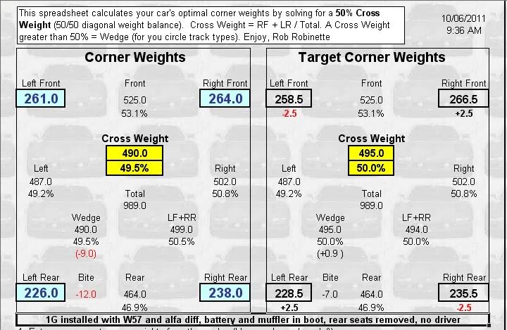

love ke70 Posted June 9, 2011 Author Report Posted June 9, 2011 ok, good news. got the car weighed this morning so this is now with the 1G, the W57, the alfa diff, my steel wheels, 15x7 front and 15x8 rear, fuel tank probably 3/4 full, i cbf filling it, just to pour it away at a later date, the rad is in, battery in boot, muffler in boot, no water in rad and no engine oil, but i reckon that counteracts te 3/4 tank of fuel, which was full when i first got the corner weights done. No intercooler or turbo, but other than that, pretty well everything is there. with no driver and with driver so looking at that, ive added 27.5 KG but the percentages front to rear with me in the car has gone from 56% on the front down to 52.7 on the front. so, thats really f@$king cool. :D just gotta shift a bit more weight to the right of the car, but I'm sure we can find 20kg to stick on the right hand side somewhere. by the time the cage goes in the balance will probably be slightly biased to the rear, seeings as when I'm in the car it improves the front/rear percentage, the same will likely happen with the cage, which is gonna be obviously mainly behind me, with just the front hoops and strut braces coming into the front end... but yeah, we're good to go :D Quote
