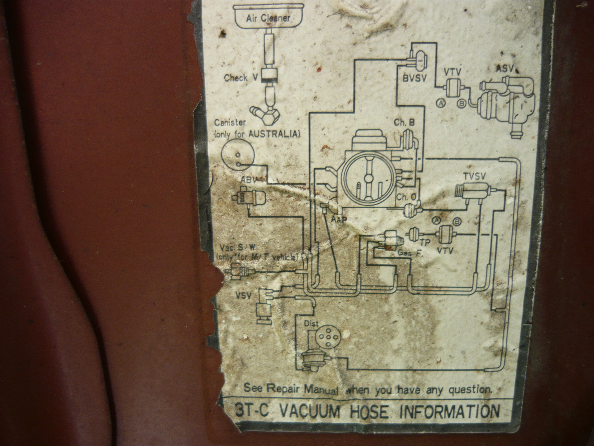

and jake, if you can look it up that would be good, also if you a clear copy of the californian emissions diagrams i would love that, the sticker is getting a bit old now...
Nothing in the t series manual, pretty sure there is a different one for USA emissions, I'm pretty sure they had way stricter emission laws over there, ill see what the one under my bonnet says if that is the right one.
Pretty sure the "C" in 3T-C and any other Toyota engine refers to Californian emissions standards, so i might just be the same as local models?

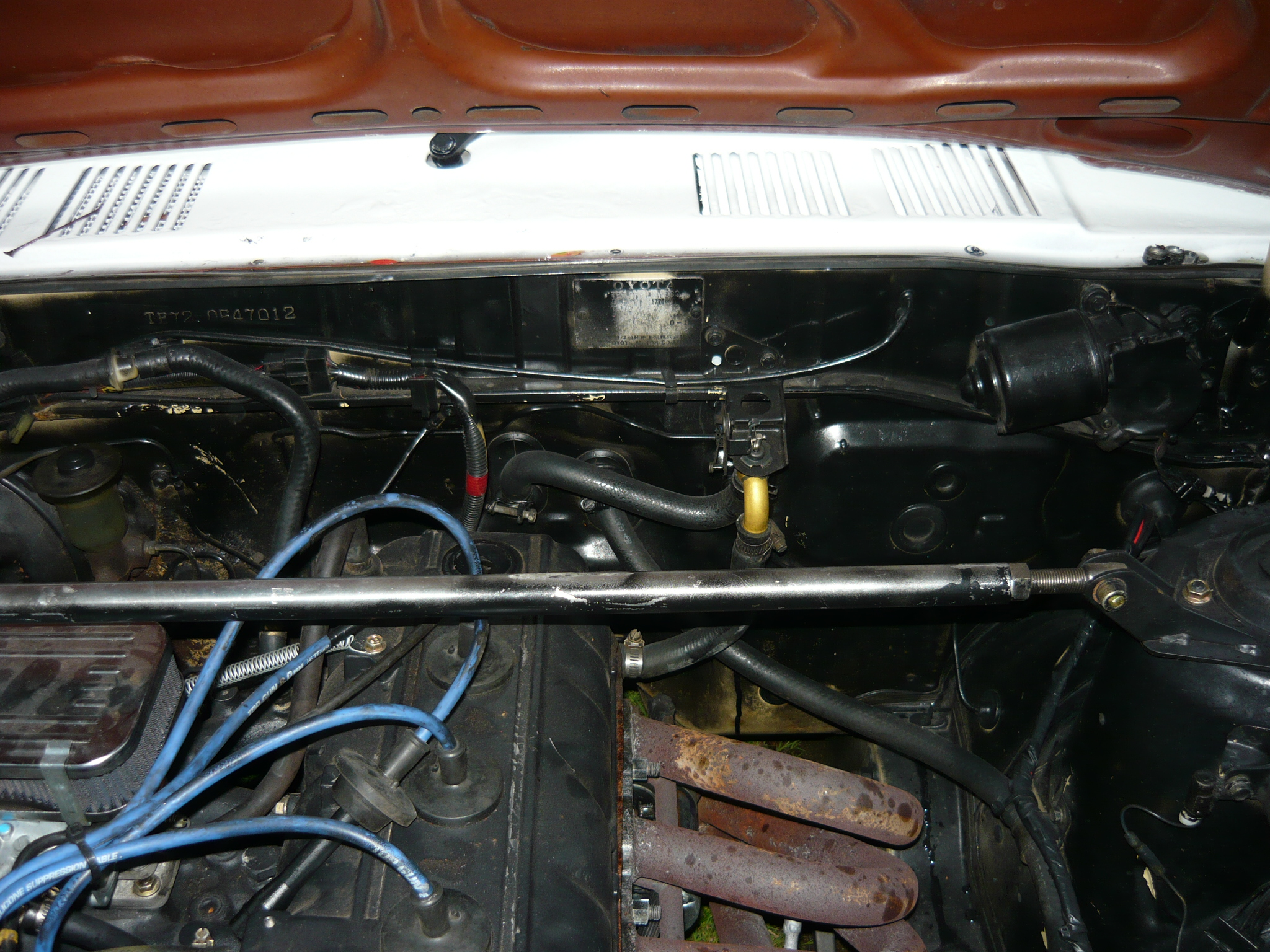

Got a picture of the guide on the bonnet, not the clearest but might do.
Also searched through the repair manual and couldn't find anything to do with vacuum lines/emissions.

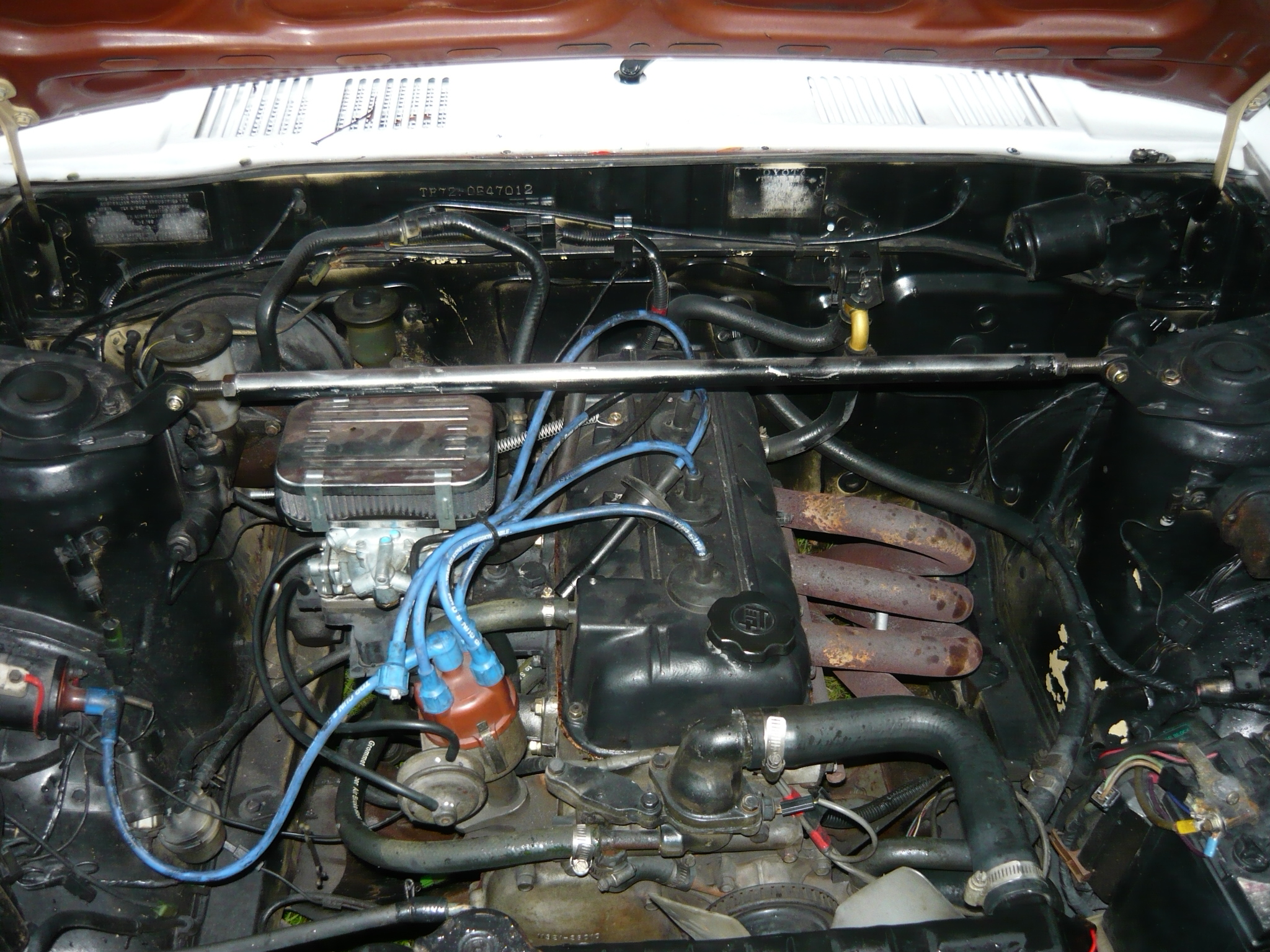

got it done, about half the lines were wrong, idles better once hot now, which is definately an improvement, still no vac advance, which is odd. I'm thinking maybe diaphram, how do i check this? or maybe something in the dizzy sticking?

thats the emissions i was playing with, its crazy spaghetti shit.

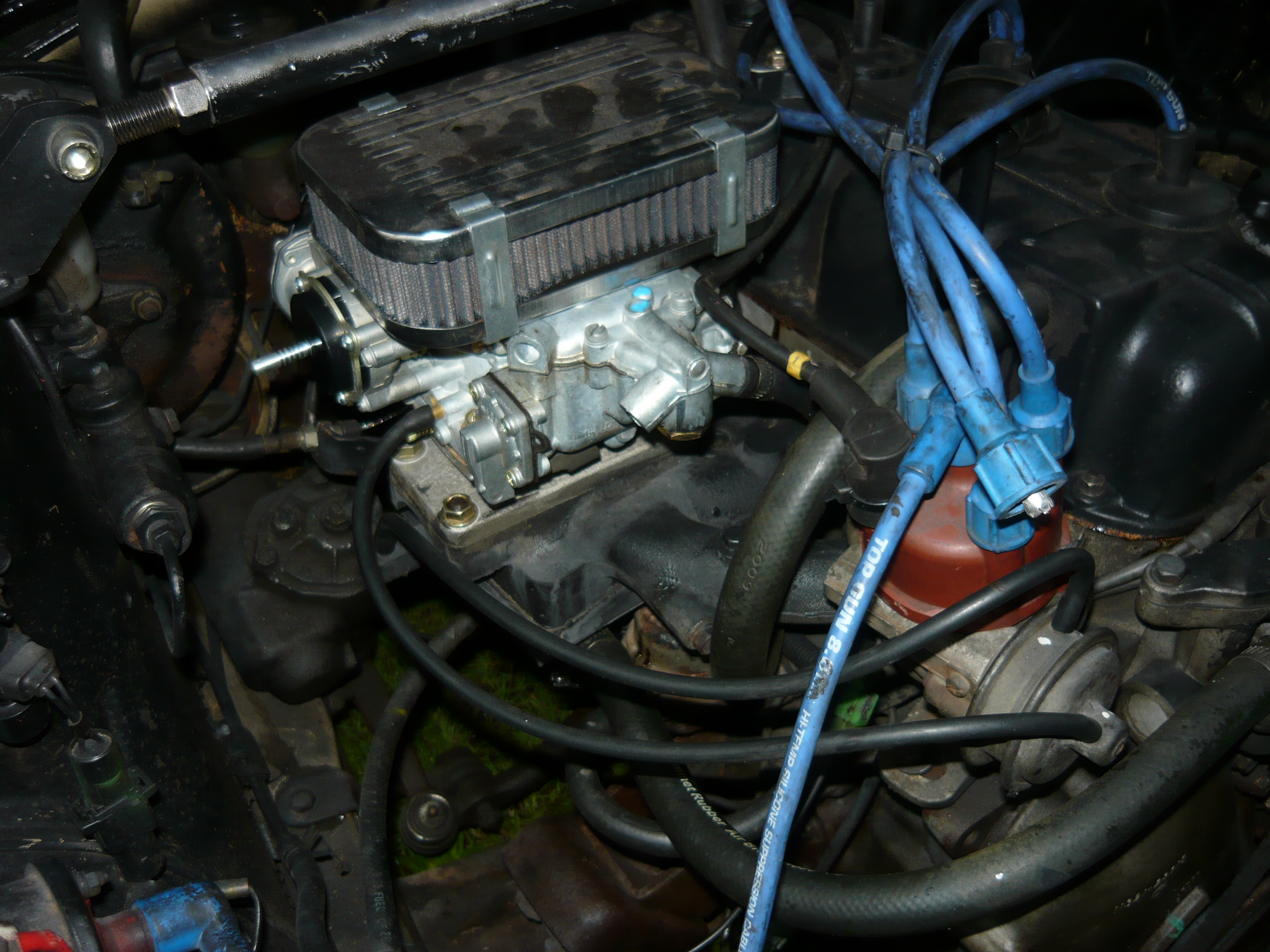

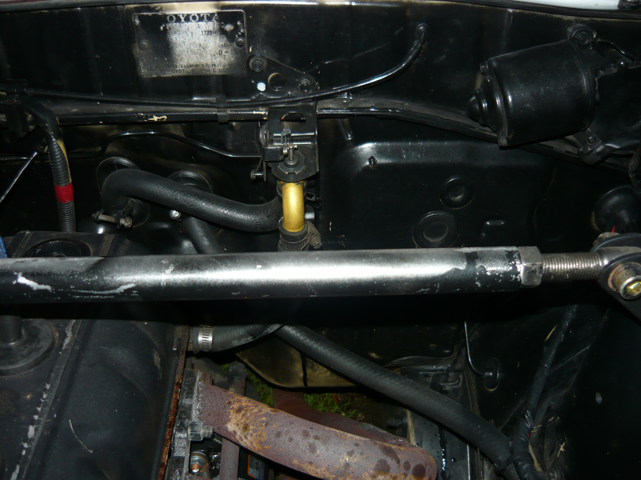

Anyway here's some pics of my heater tap, got a brand new genuine one from Japan, also with the air pump I took mine off as it was making it backfire very slightly when driving normally, just took everything off and blocked up anything that was required but I would think you would need it to get ti registered unless you do a very good job and get proper plugs for the EGR part.
Anyway the last pic is of how simple my weber is only having 2 vacuum lines for vac advance :laff:

haha if i was keeping the motor i would have swapped to a decent carby already
that heater tap looks exactly the same as a ke70 one.
