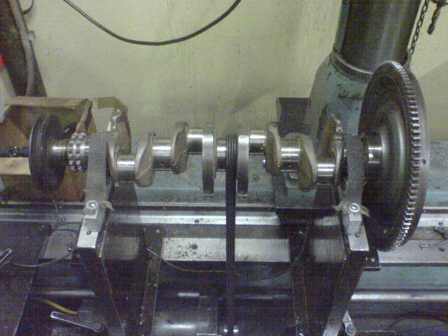

so i have been reading up in this forum for a while and lots of people ask about flywheel lightening and weights so here is what i found before i started machining the flywheel weighed 7.9 kg , i believe this is a standard 4k flywheel after machining the back only the flywheel weighs 6.2kg , i think this should make some difference to the way the car revs , also after maching i shot peined the back to combat the cracking issues that come with lightening cast flywheels , although i am sure it would not break anyway. after maching i balanced the flywheel on the end of the carnk shaft, and it was only out 1.8 grams , so it seems fi you set the flywheel up well in the lathe there is very little balancing to do . i hope this helps !

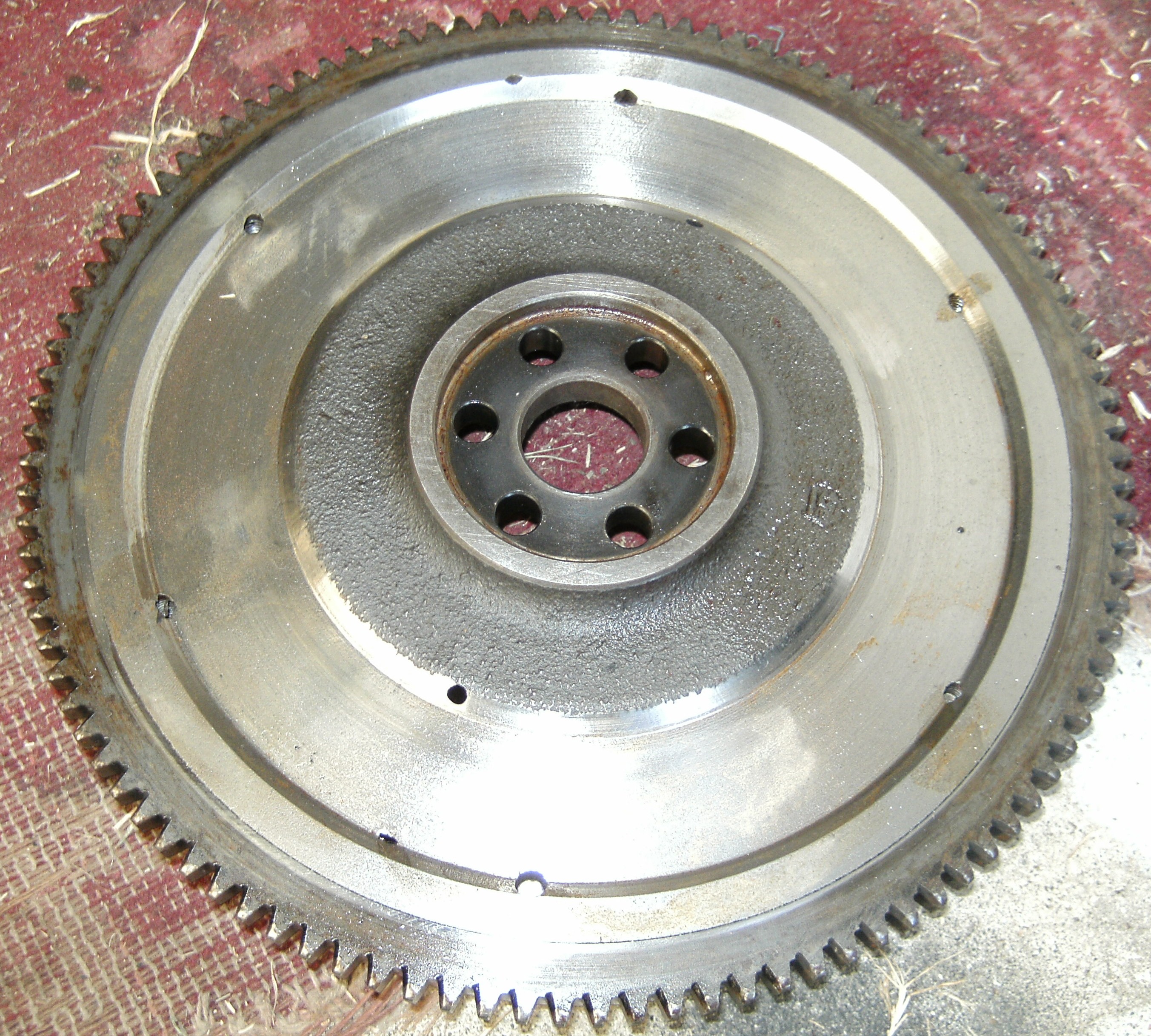

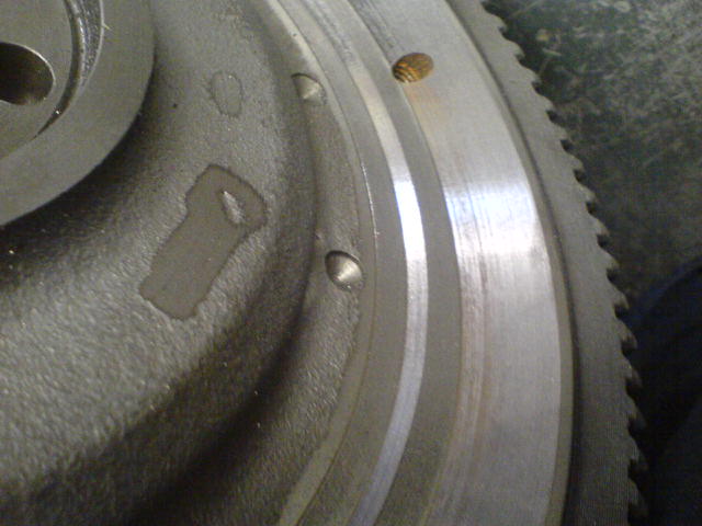

I used a older 3K flywheel but. They are different and slightly heavier than a 4K one. But it had a thicker middle section and inner part so though it would be a bit stronger in the center.
I jsut started from the flat section where it begins cleaning up the surface skimming it then cut the raised part on the edge back so it was thinner cleaning up its surfaces. Then I just machined the outer edge level with the ring gear.
Pic below:
While at it I faced the clutch face needed a bit taken off so the whole front of the clutch was refaced to keep a good step between the clutch face and the rest of the flywheel..LOL So can kinda say I lightened the front..LOL
