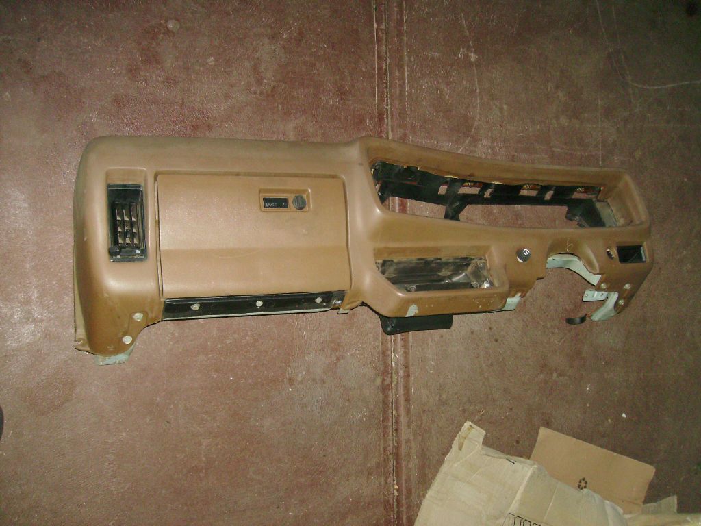

So tomorrow is going to involve:
- pulling out a complete dash at the wreckers if it's still there so I can get it reupholstered and put it in prior to the ID check.

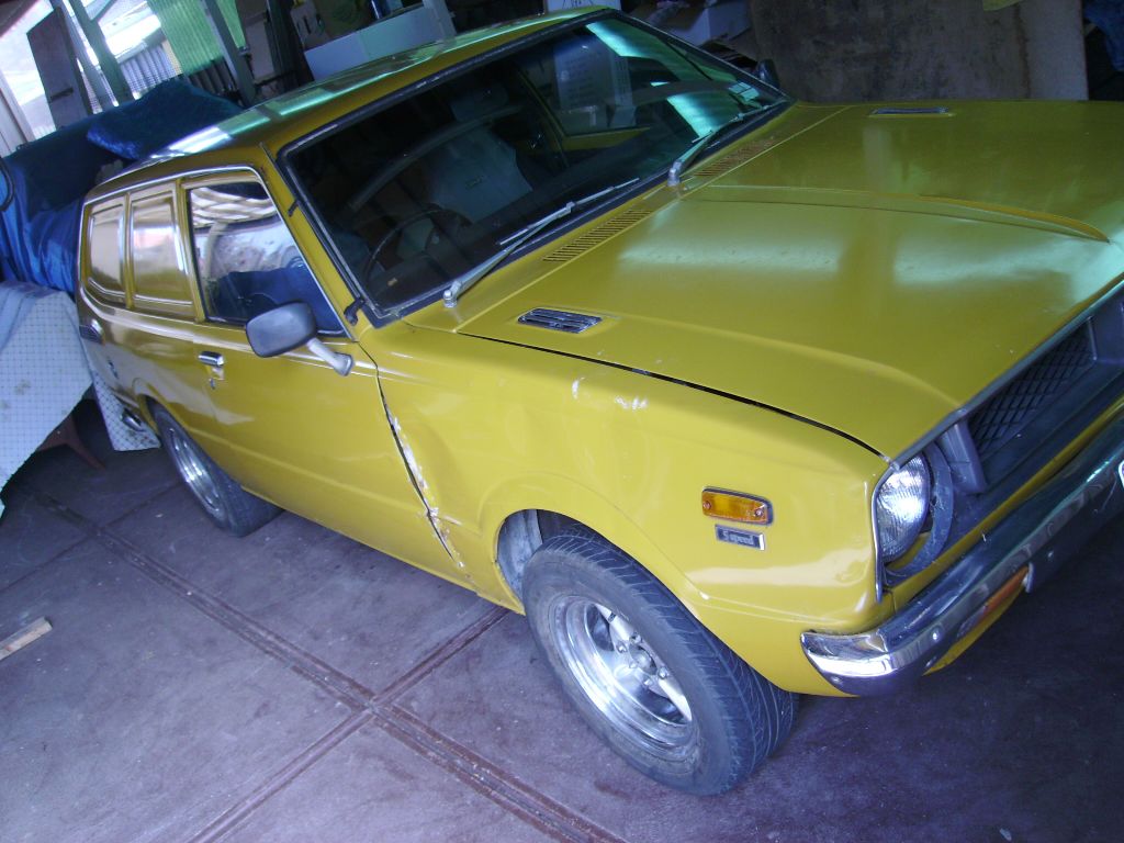

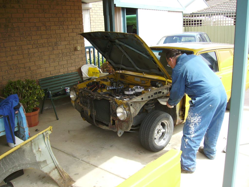

As I was exhausted, I didnt get a chance to upload the photos.
The weather was pretty crap, but here are some pics!
The camera battery went flat prior to me getting a half completed picture of the front end of the van.

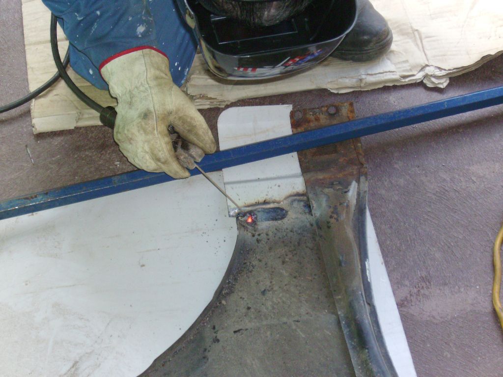

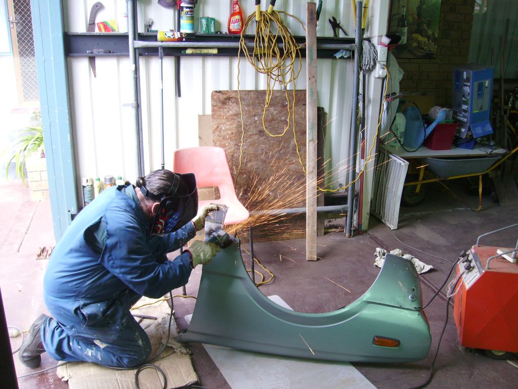

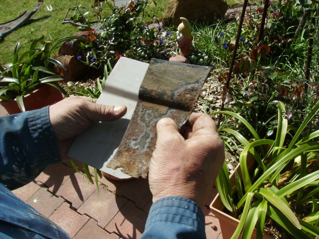

Panel Welding with an Arc welder? Fun and games!
I borrowed a TIG off my mate and I'm getting my chops up with that, if you want to let me come around and practice on your panels....
EDIT - ahh, I see, lap joints.
Edited by philbey
Haha, yeah, I don't own a mig, but the arc seemed to do the job without warping anything, thanks to the old man doing the welding.
Just need to get stuck into filing it back smooth and a touch of fibreglass or something to fill the lows.
Yeh I've heard it can be done, a lot of guys in the states are doing their motorbike frames with Arc. After laying down some of the tiniest beads with a TIG the other day though, I'm hooked and will never go back!
