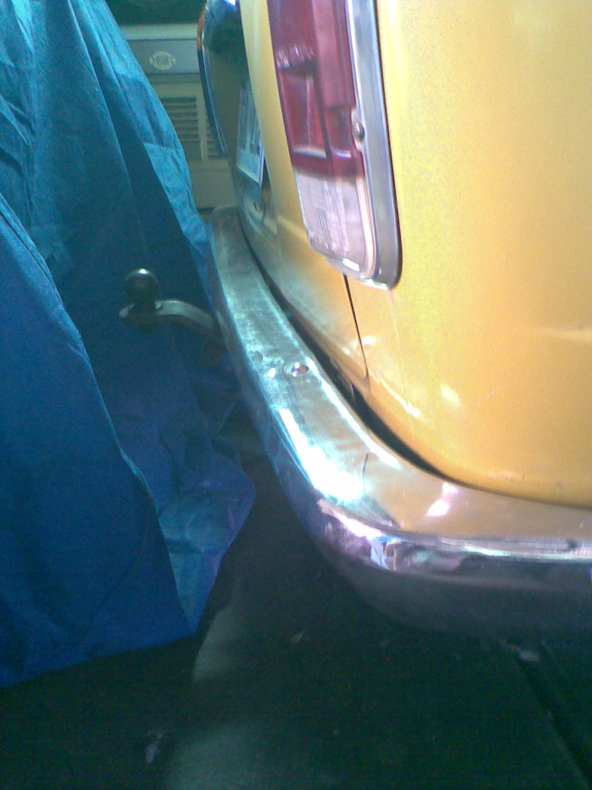

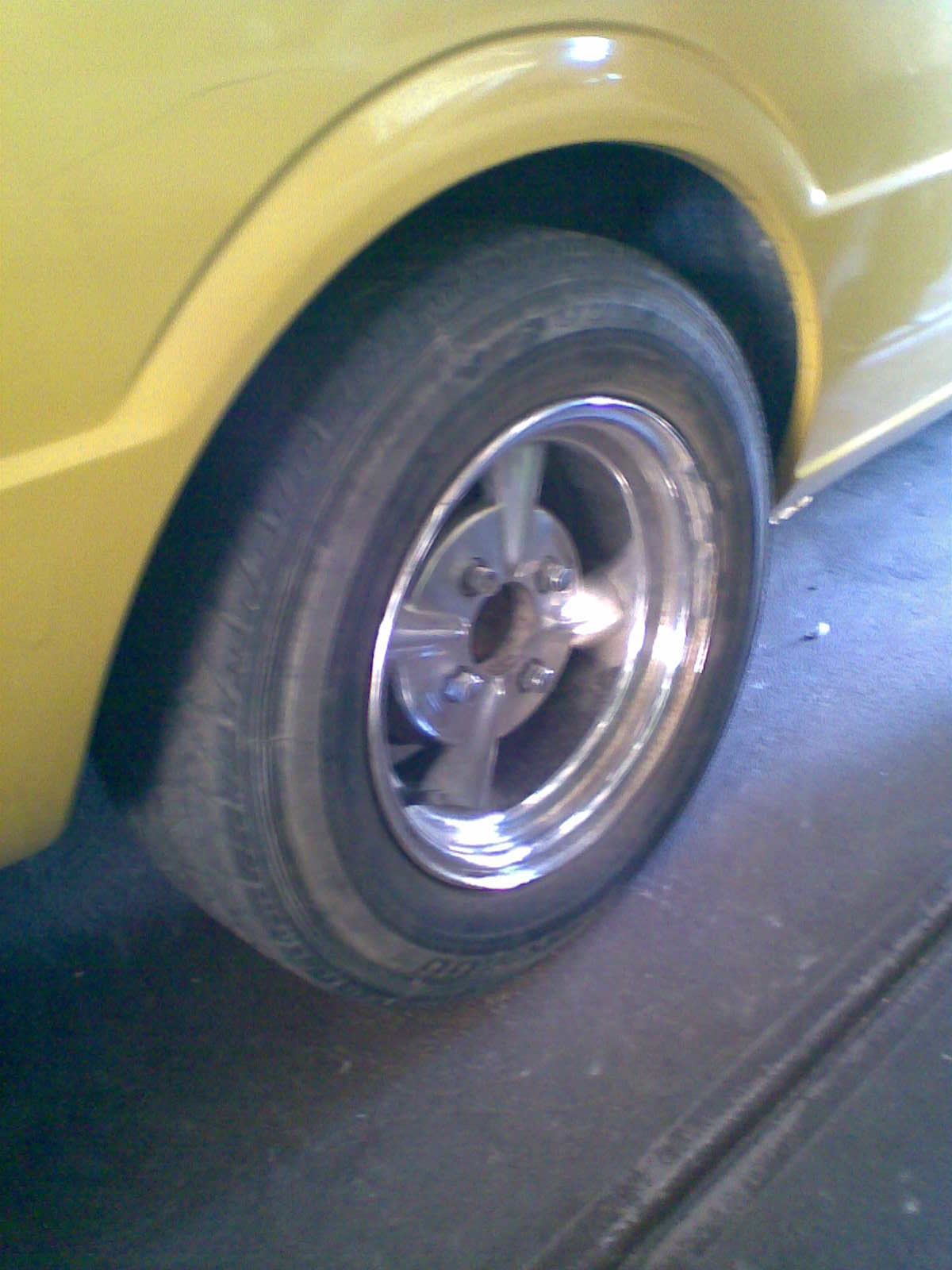

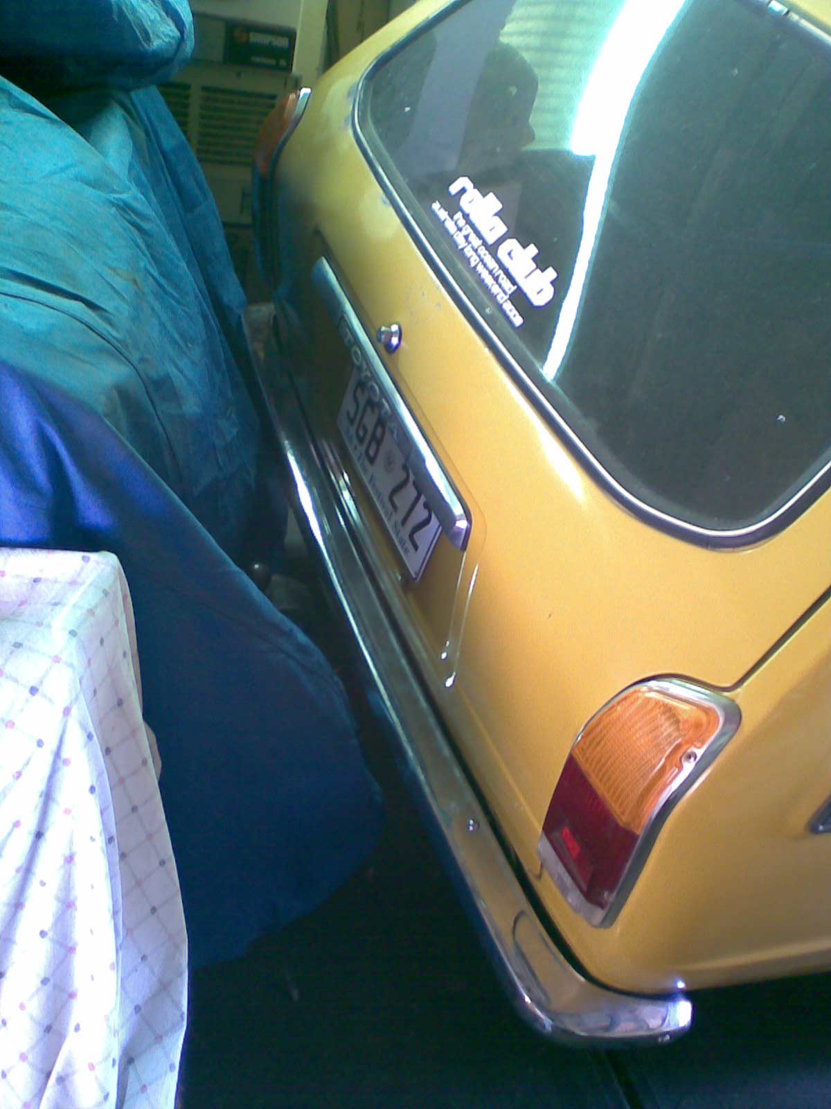

Took a few pics today to show how much the rear leafs have brought he height up and the rear bar as its currently fitted.
That is all. :y:
Lookin Shmiko Micko.
Yeah looking good alright.. Nice straight rear bar you got there :y:
