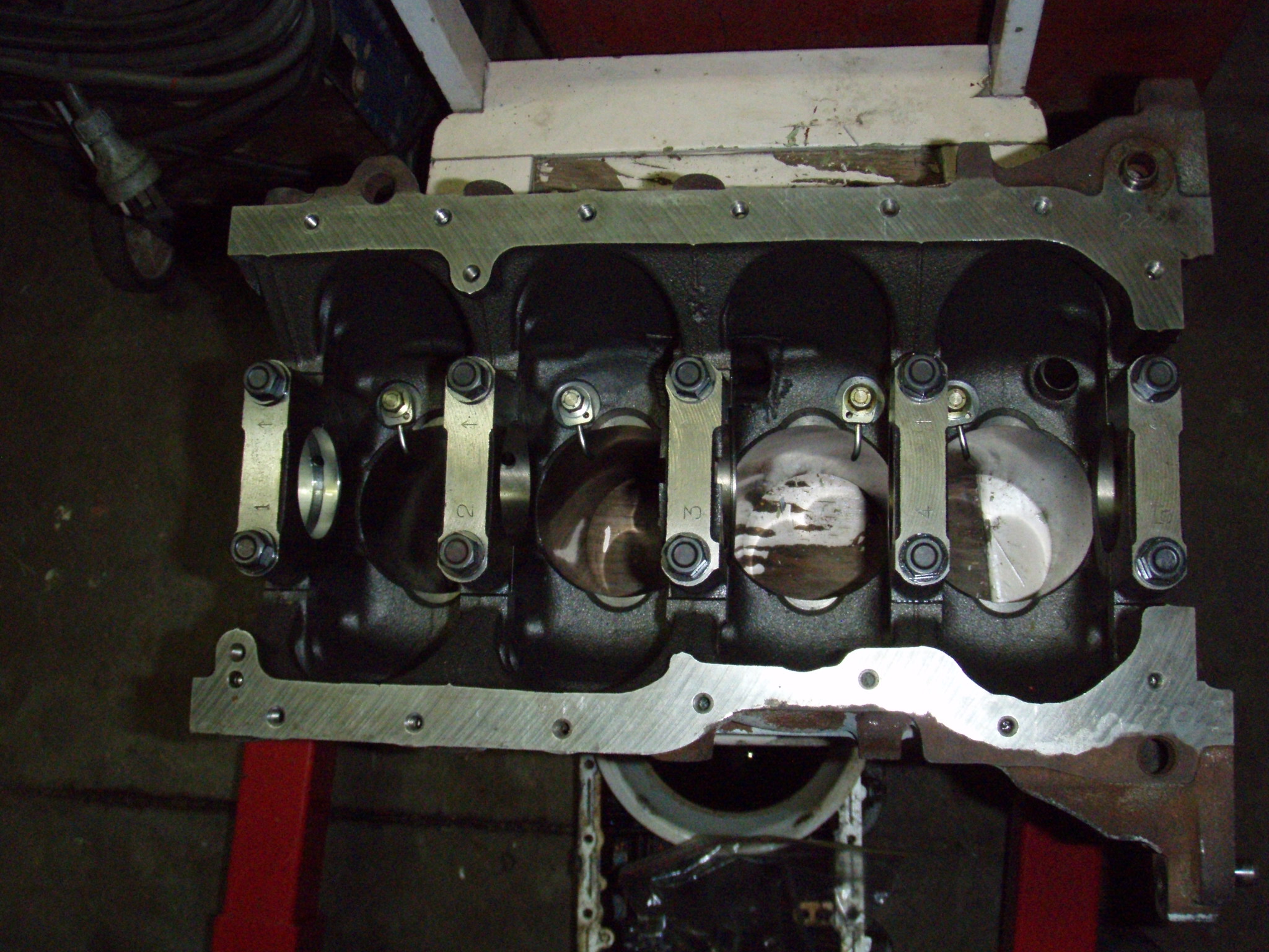

Currently peicing up a 7agze for my AE95 Proper machining in of oil squirters etc... Will start build thread when she's coming along a lot more..
