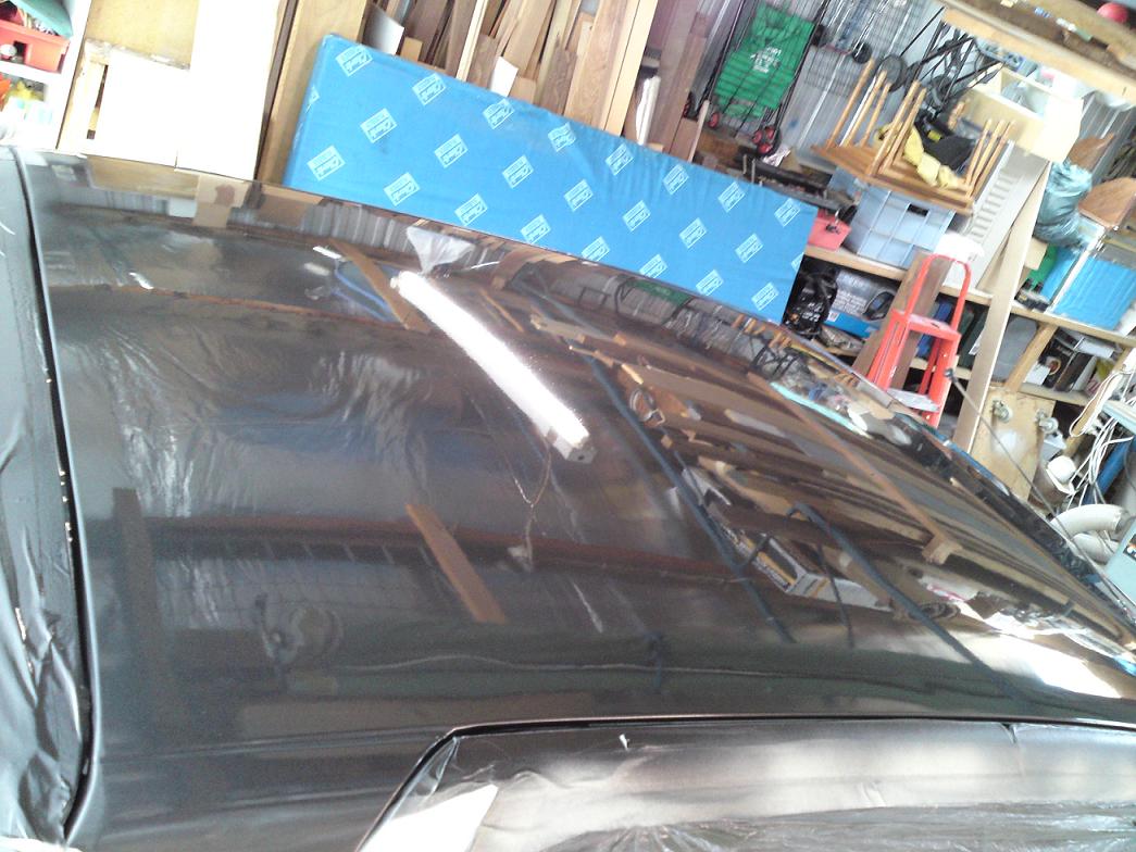

November 8, 200917 yr comment_389267 Have a search on here for words like "concept" "acrylic" made by myself. I did a small write up years ago. I sprayed the roof of my daily last weekend as it was all faded. This is the finish you can achieve with acrylic paint straight out of the gun. Its yet to be blocked back then cut and polished. Edited November 8, 200917 yr by kangaroosa Report
