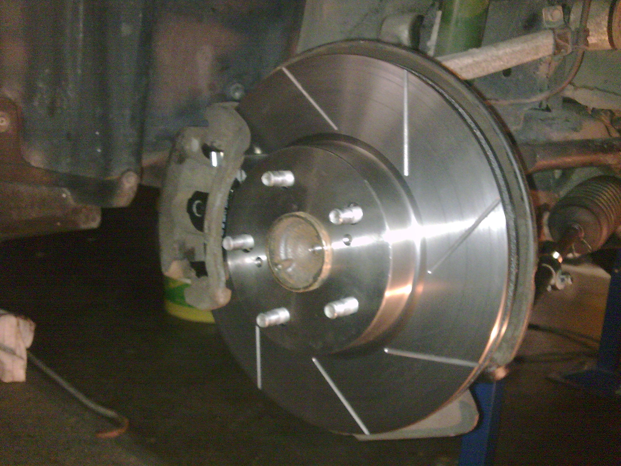

For the roadworthy to be done i had to do the brake pads and replace the front rotors....what better way to replace front rotors than with nice big Slotted ones. :bash:

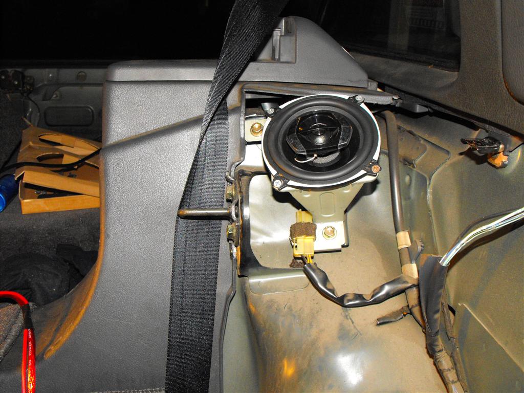

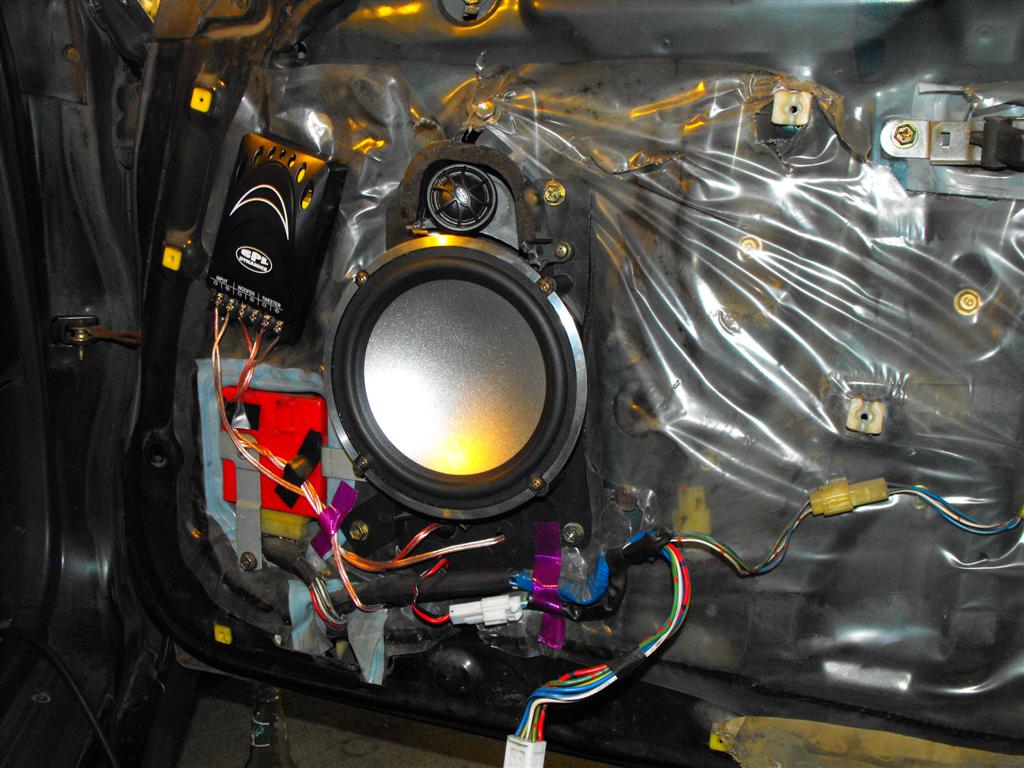

And the Stock Headunit had been removed, so i set to and gave it some upgraded sounds....

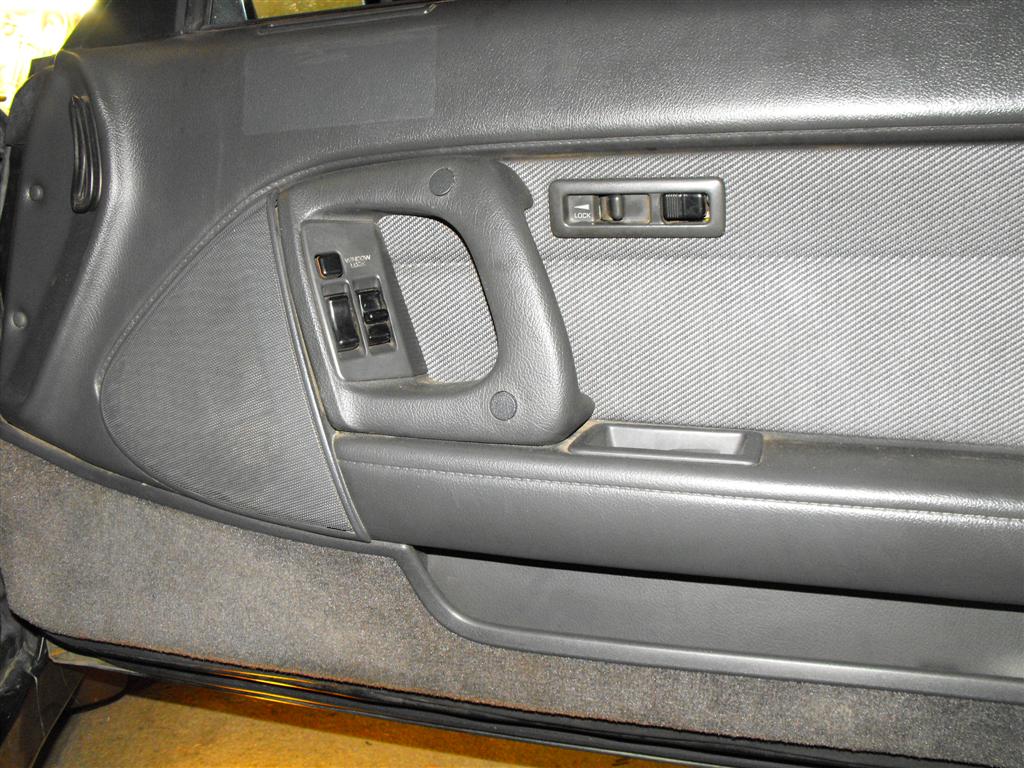

Front Door:

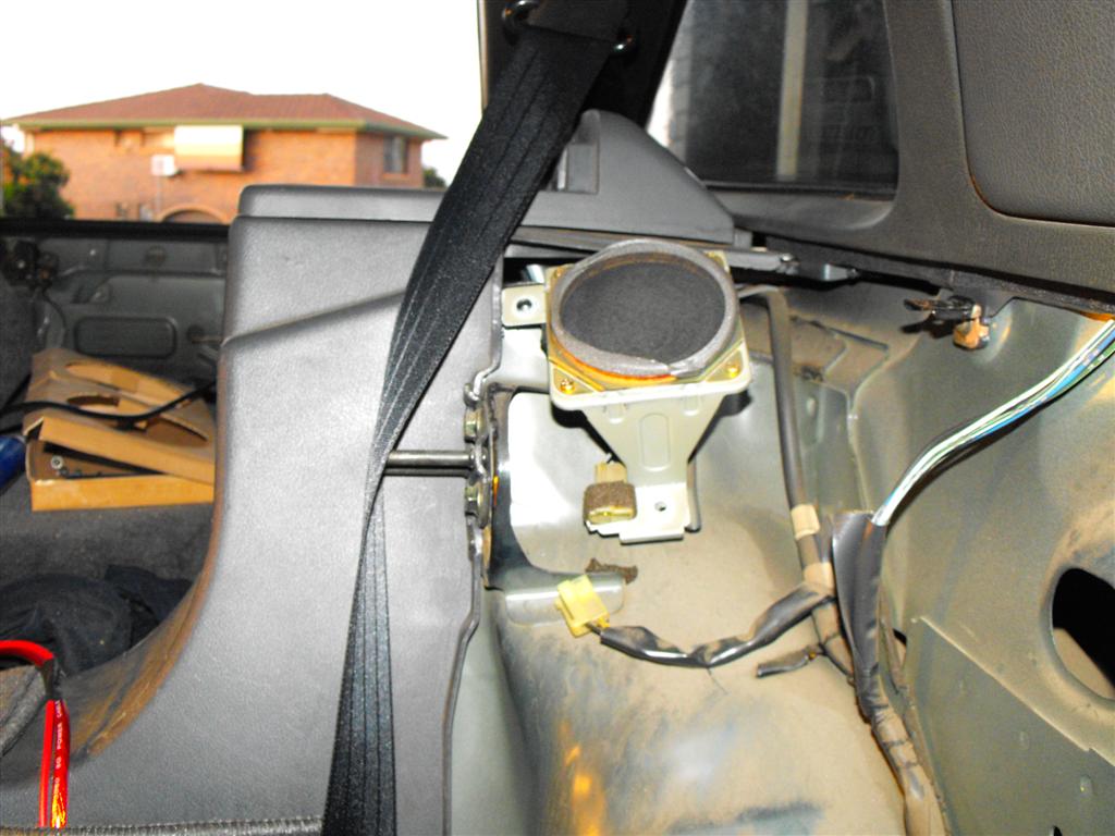

Original Rear Speaker
Shiny new one

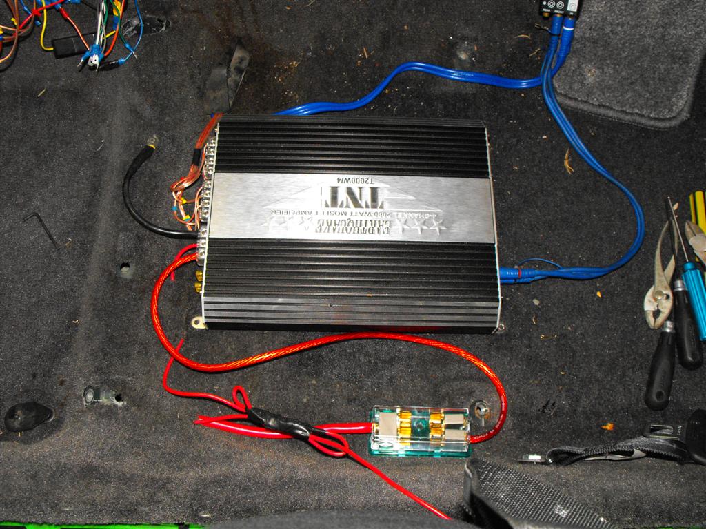

Front amp for cabin speakers:

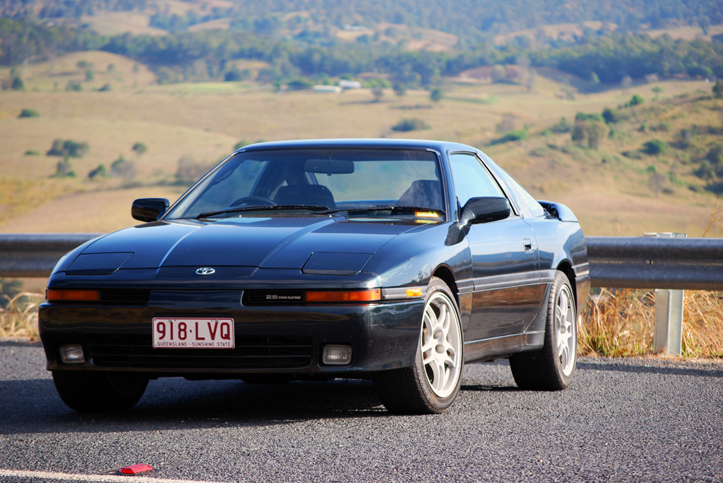

I love these Supra's too, Xany! :dance:

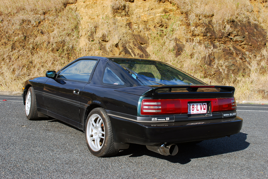

In my opinion (apart from the huge eff off cannon) you beat Teddy :cool: Take care of her!
The cannon is getting replaced with a nice looking twin tip muffler when i can get to a exhaust shop and have the cash to do so. :cool:
Also, both mine and teddy's supras are decent looking...his has alot less k's on it than this one though, and is VERY overrated. lol

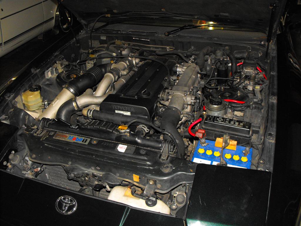

Wise decision holding out for a J rather than the M...... unless you have shares in ACL. :bash: :cool:

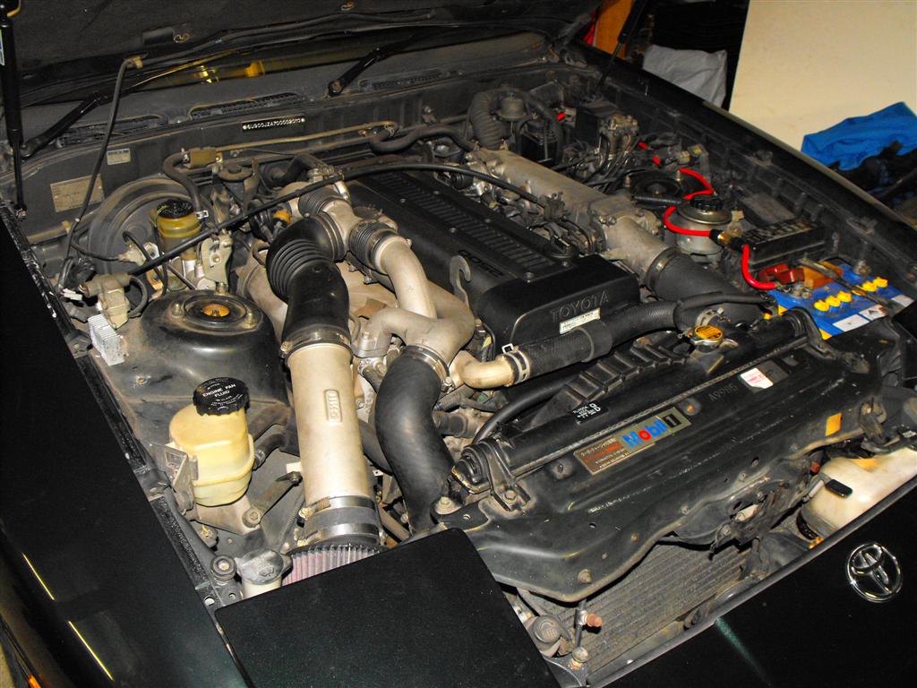

There's a lot to be gained in a siamese dump pipe on these. The design of the stock dump pipe/s is woefull. However as soon as you do fit a siamese you'll start getting over boosting (which isn't great with ceramic turbos) issues as the tiny waste gates can't keep up with the new increased exhaust flow. High flow and steel wheel the CT12A's while you're at it and you won't be dissapointed though! :dance:

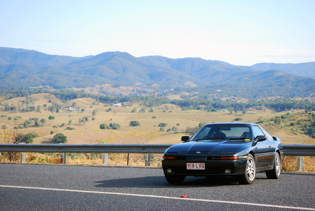

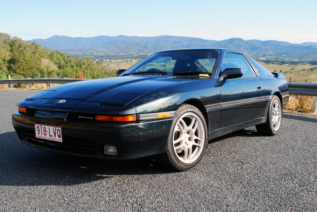

Hawt. Looking a little bit boatish. Maybe some suspension work on the cards? Love the 17x9s but! Forged goodness.
Doesnt handle like one, trust me. Just looks high in the photos....it's already got lowered springs and KYB dampers installed. Maybe down the track i might invest in some coilovers, however i'm quite liking the dampers atm.
Mods already installed on the car when i bought it include a 3.5" turbo back exhaust (hence the massive cannon), High flow cat, Dampers, Springs, K&N pod filter with HKS intake pipe, R33 GTR 17x9's. Engine is Stock as far as i know, about 3 weeks after owning the car i was driving over mount tamborine on the way back from the coast and hit a massive rock in the middle of a rock slide (tried to avoid as many rocks as i could) and it punctured the sidewall in the drivers side tyre. So i had to replace both front tyres with new ones....they now have Maxxis MA-Z1 tyres on the rims.
Oh and Taz, i've been told about the dump pipe design on these....yeah i agree its woeful, shall be upgrading them when time and cash permits. :S
