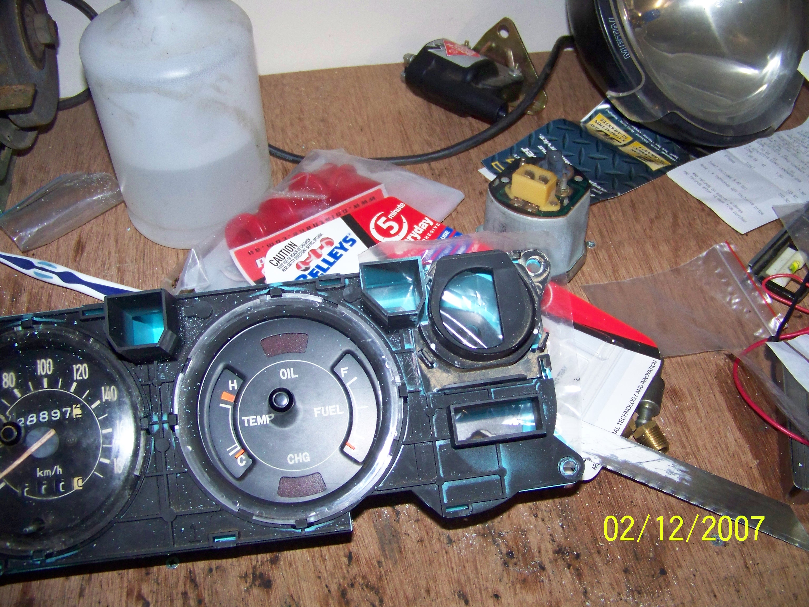

Not really happy with the chariot at the moment, some things draining the battery.
Anyways, while i'm figuring that out i've begin working the fuel gauge
Worked out what was draining the battery the other day
the oil pressure gauge, believe it or not. So i think over the weekend i'll be re-doing the wiring for the gauges through the acc wiring this time round.
