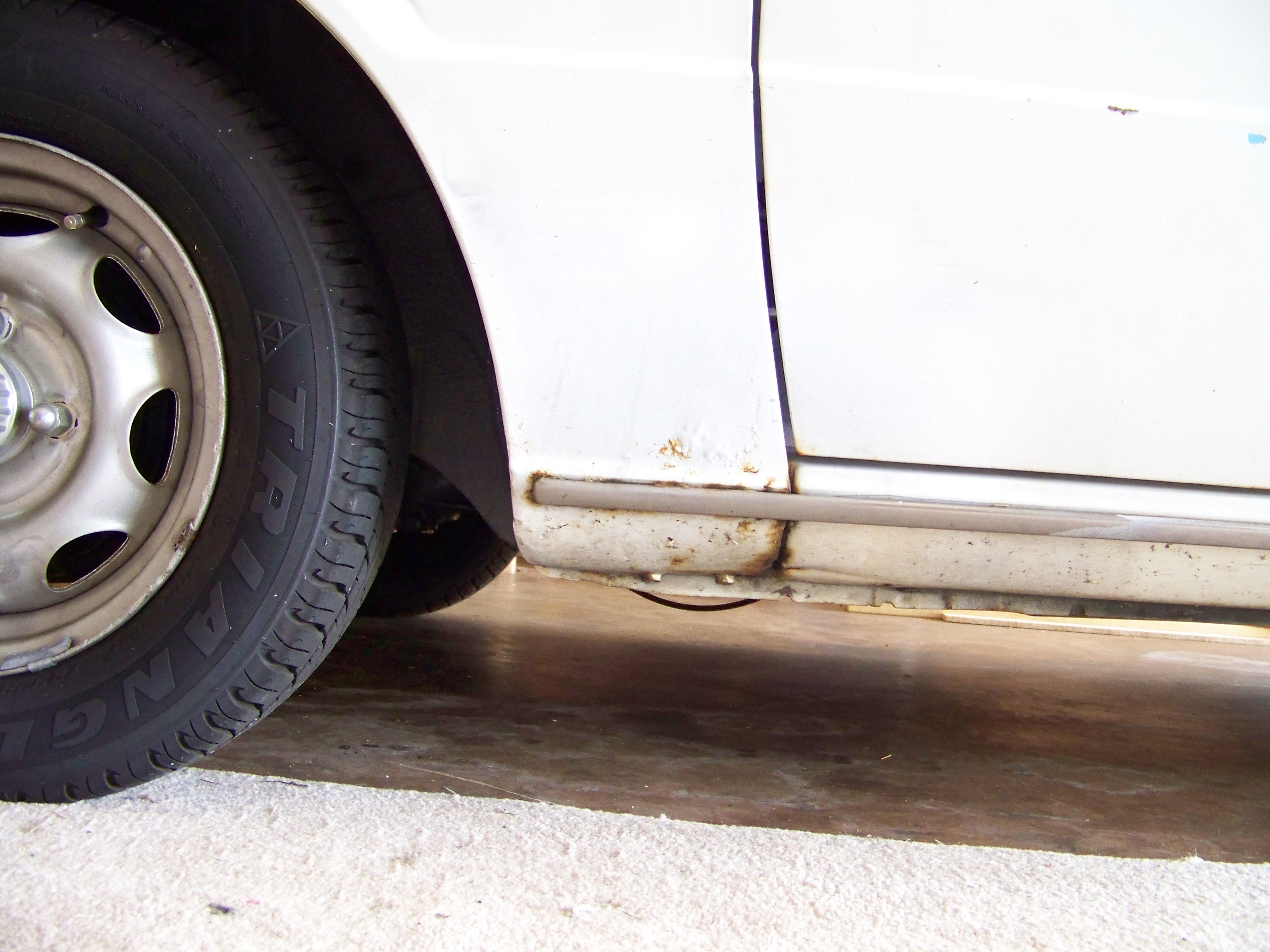

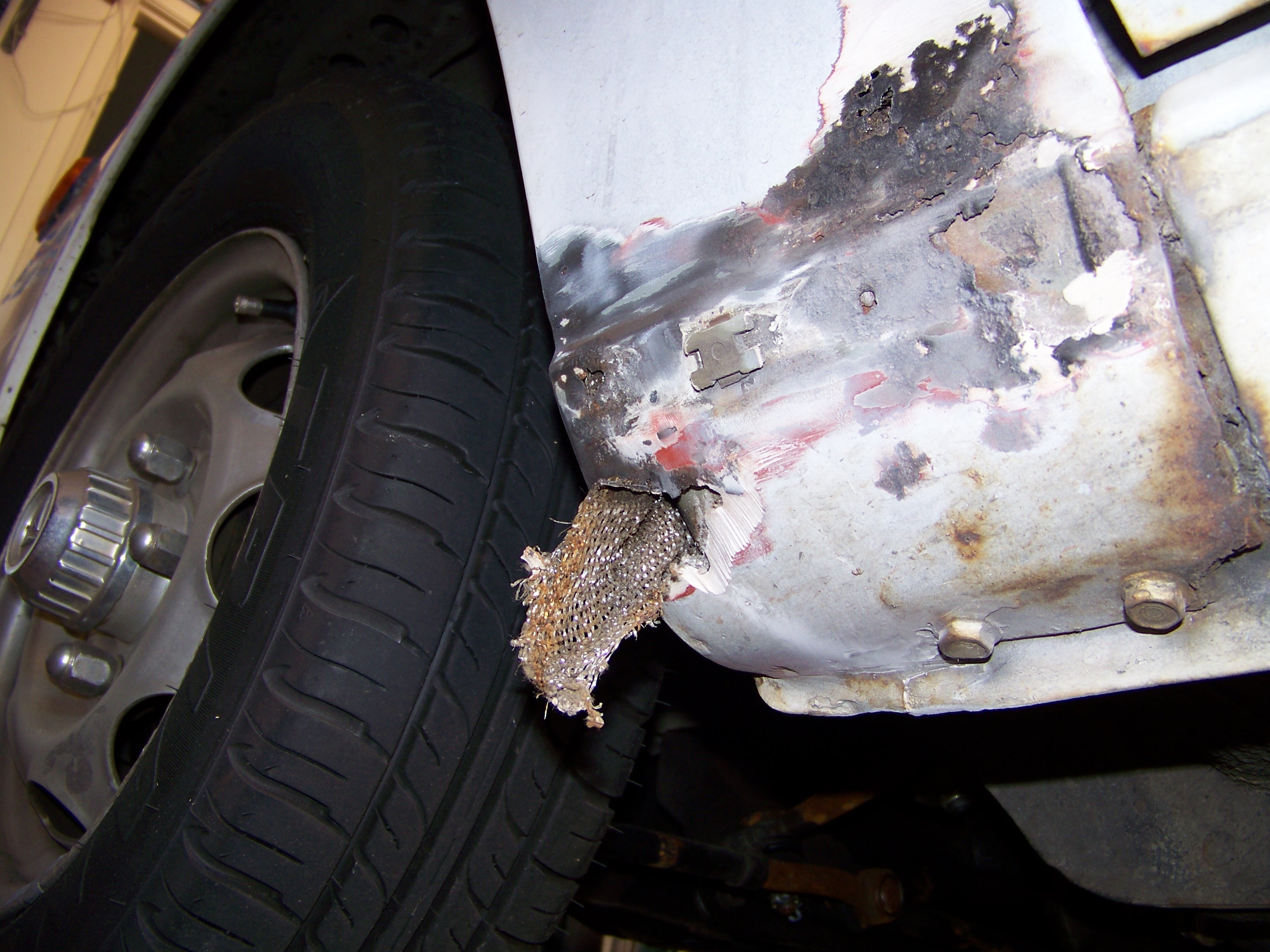

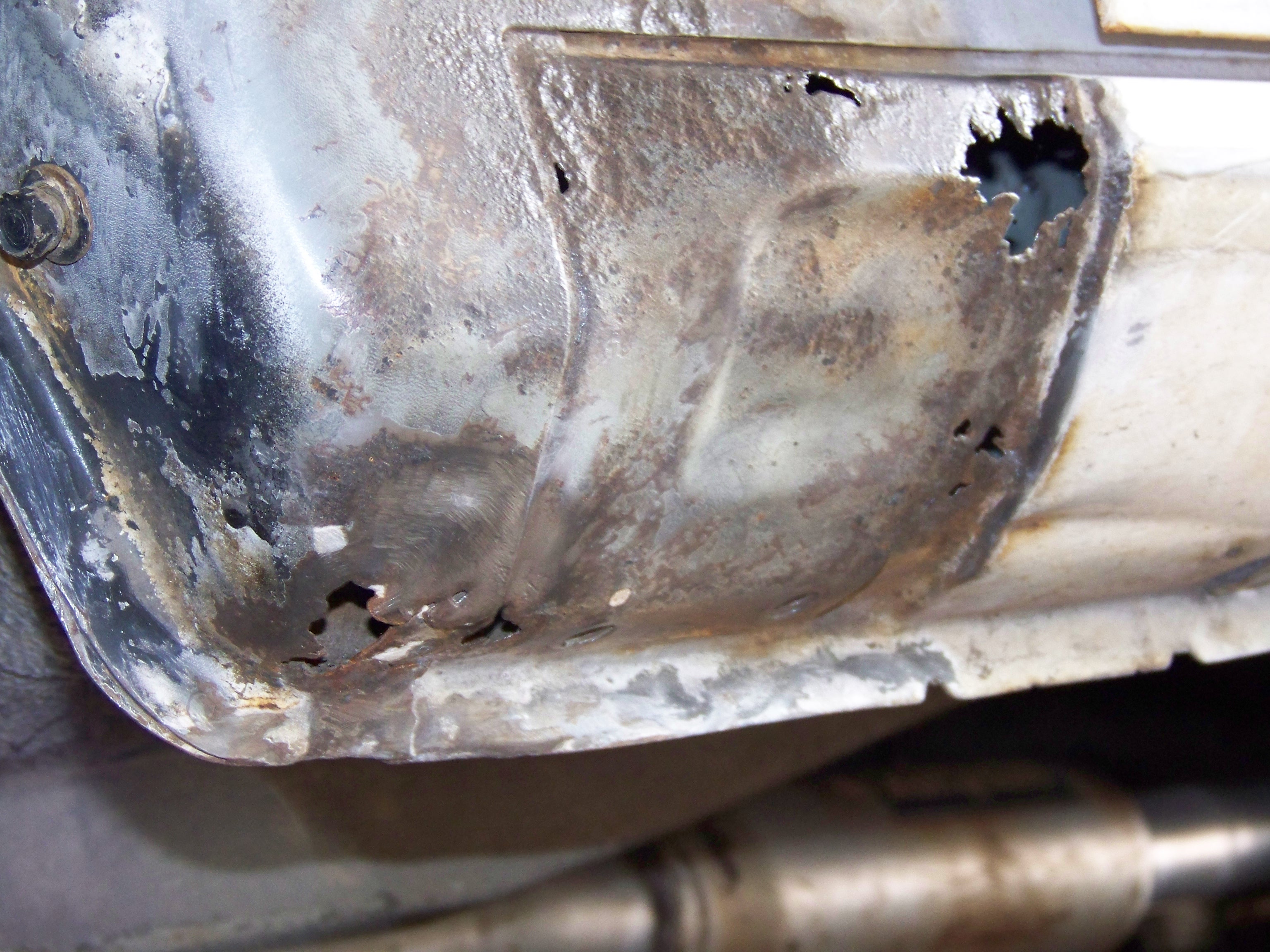

I decided to pull my finger out on sunday and got cracking on repairing a small spot of rust behind the front left wheel.

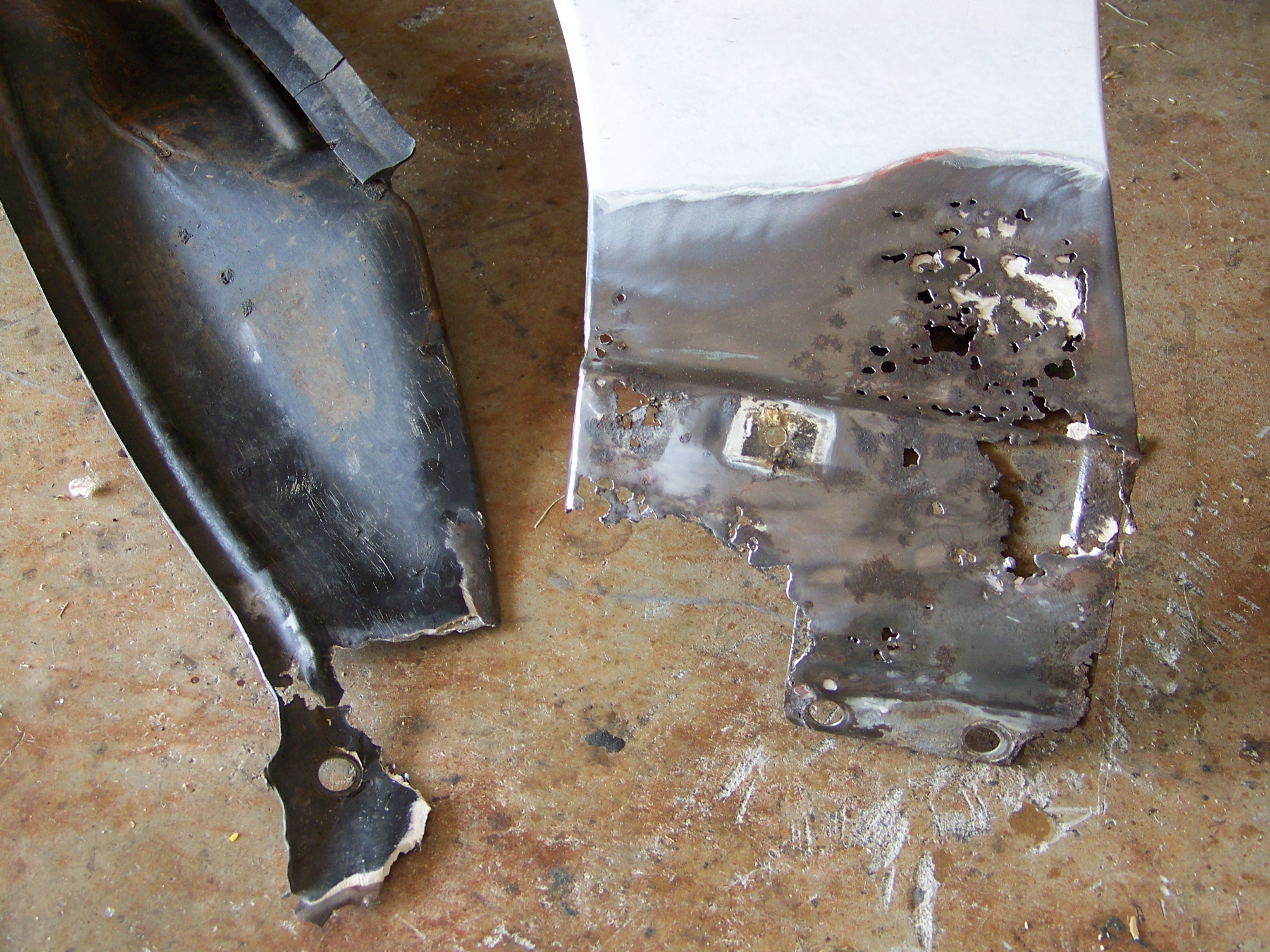

Everything was going fine till
And its just getting better

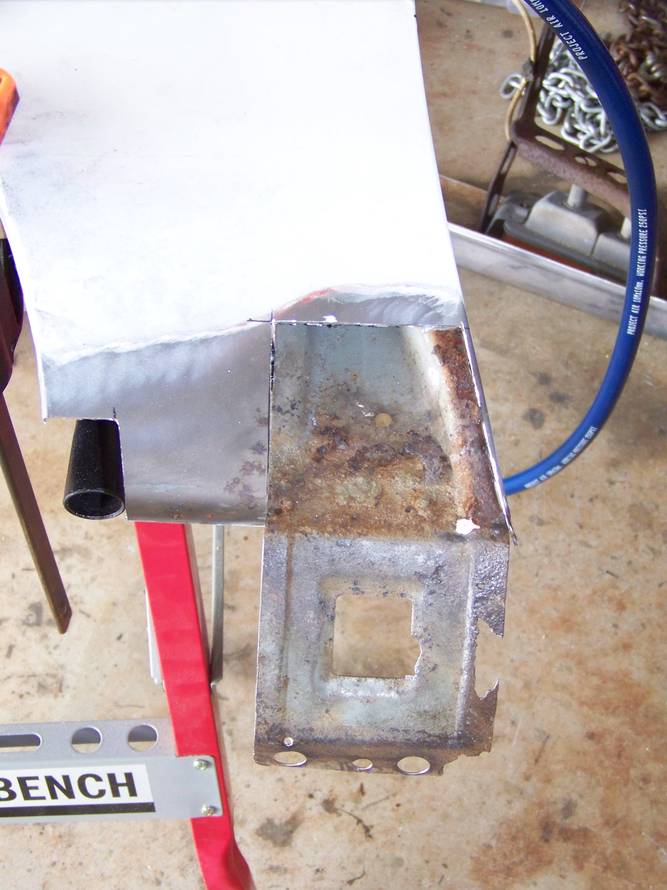

I had to take the panel off cause there was even bog packed in behind. More on that later.

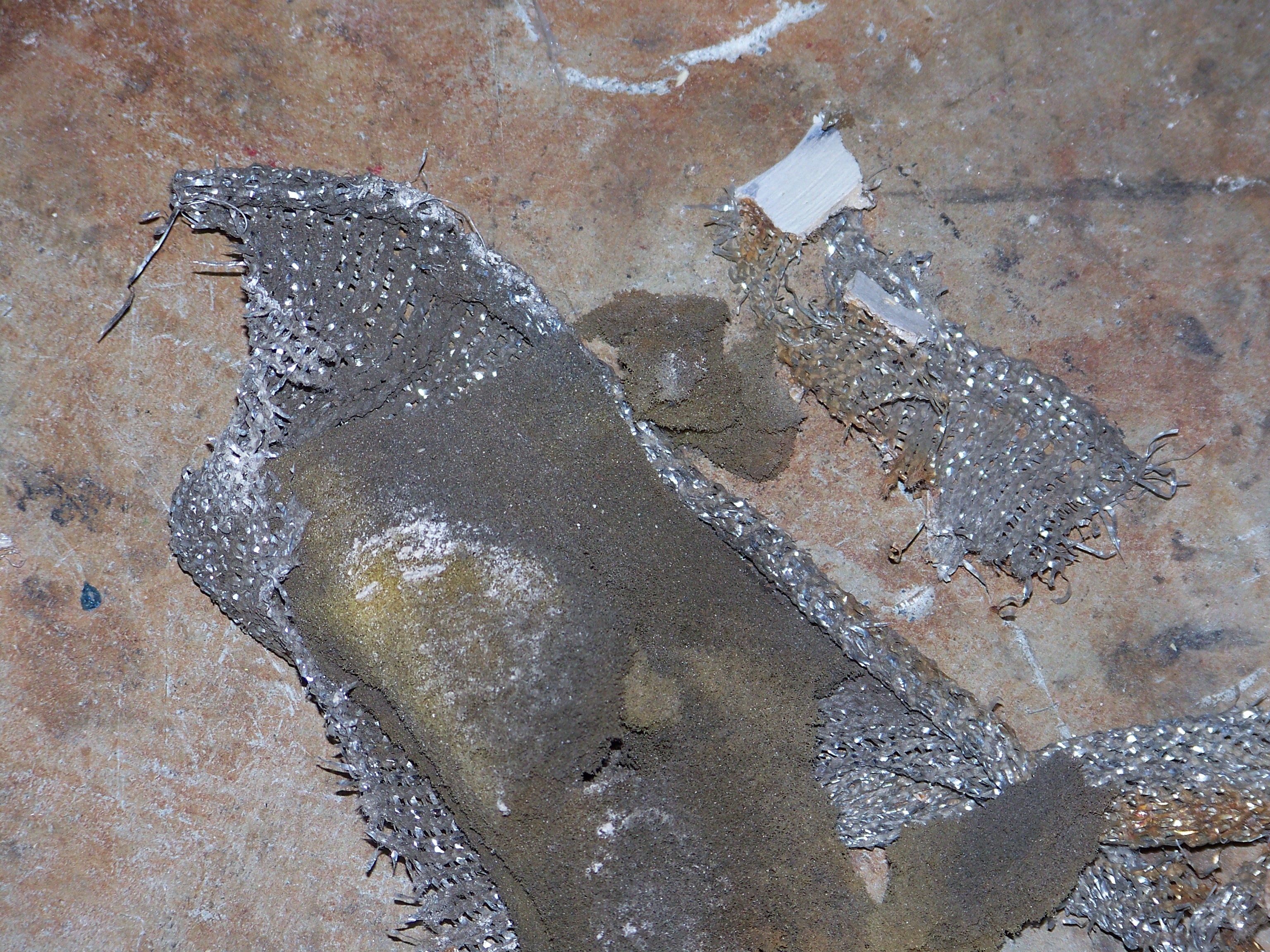

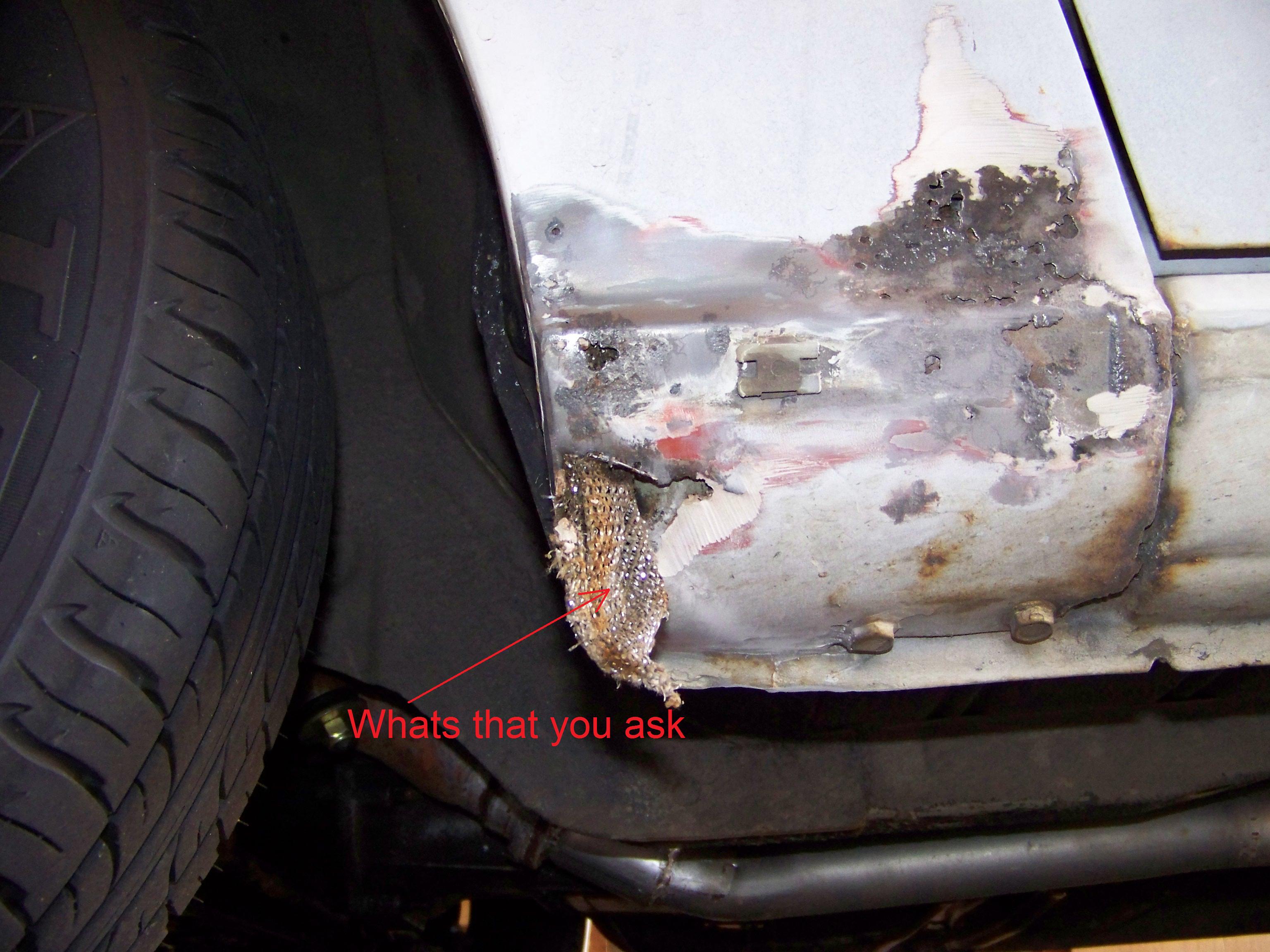

But what was it you asked
A scouring pad :blinks:
Nice and damp as well
I've heard of paper being used but not a damn scouring pad. Till ambers dad came over tonight and "Oh yeah i've used they before"........:blinks:
Now i'm wondering what else is hidden under the body work.

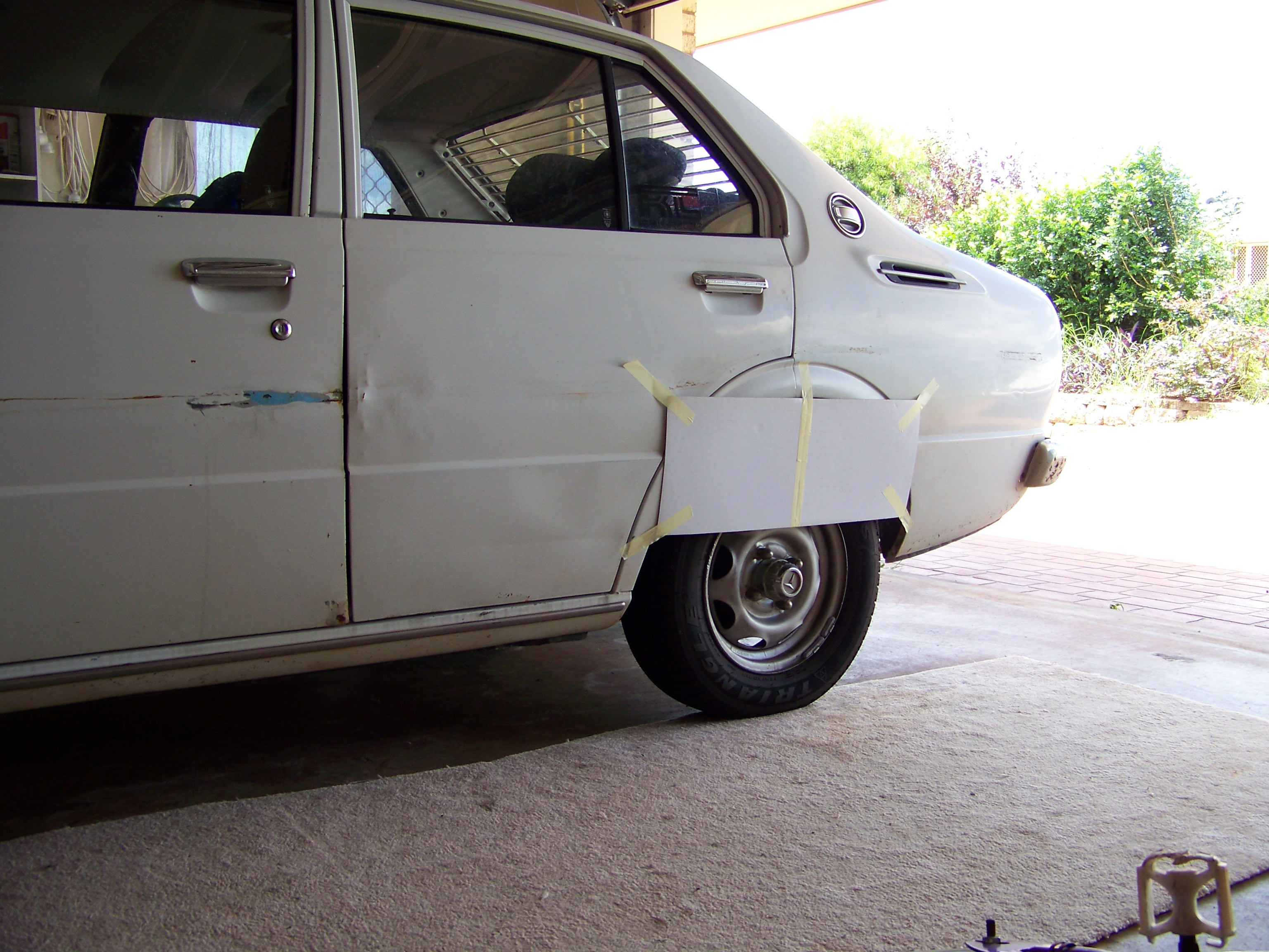

Don't toy with the spats idea any more! Looks good on an EH Holden.. not on a Corolla :)
Are you crazy! I hate the stupid spats on EH's with that dirty piece of rubber strip in between them.

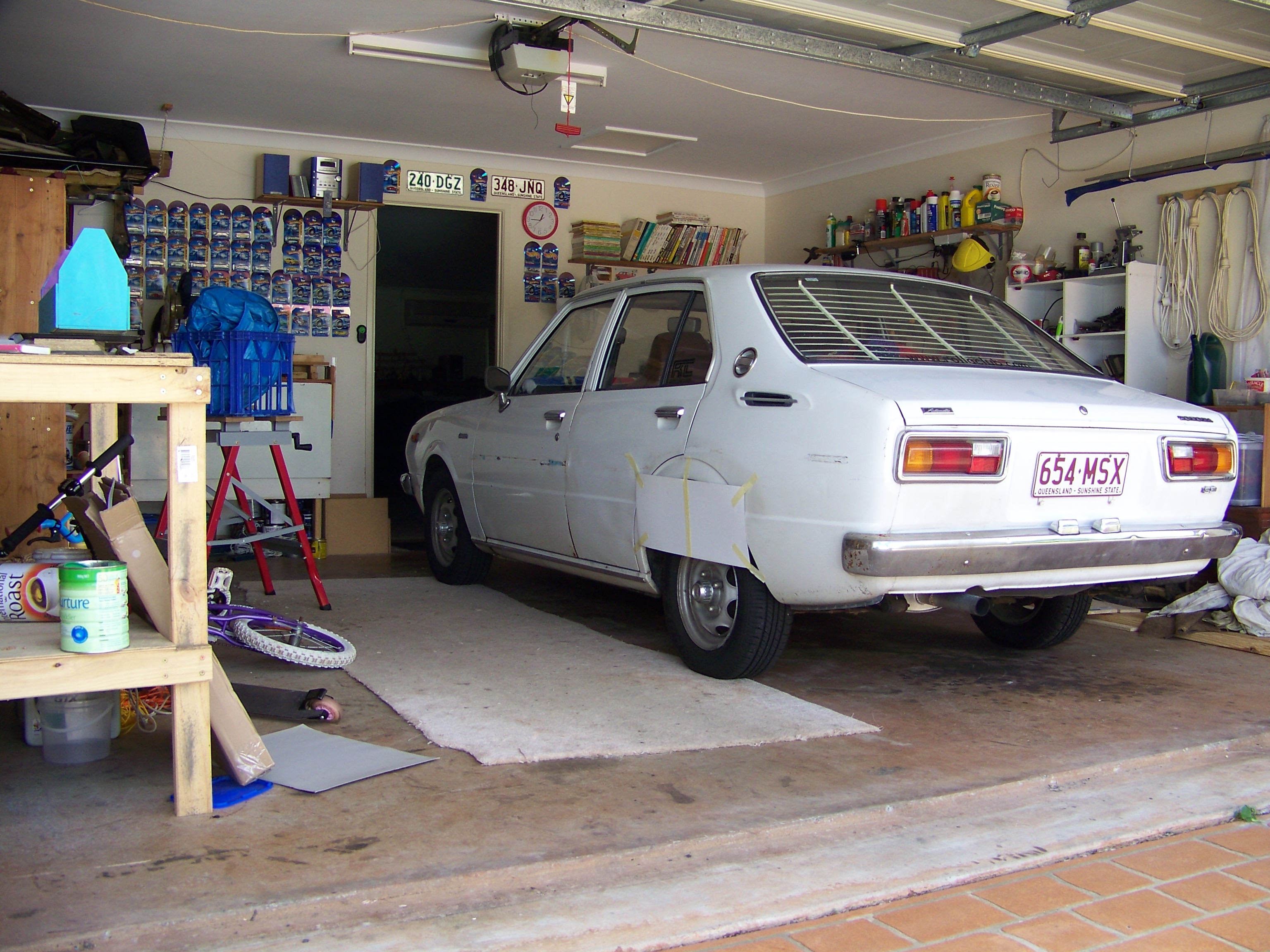

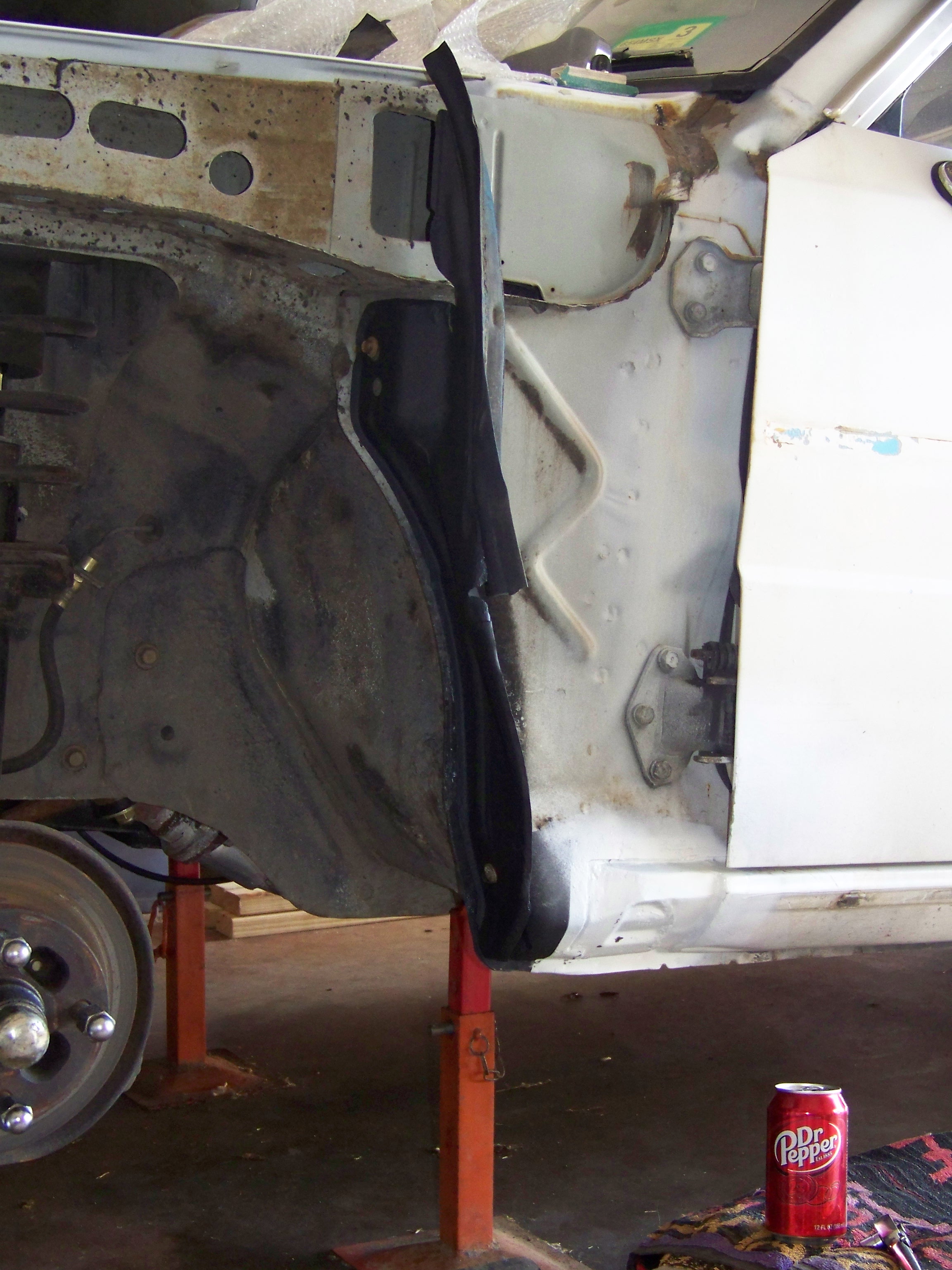

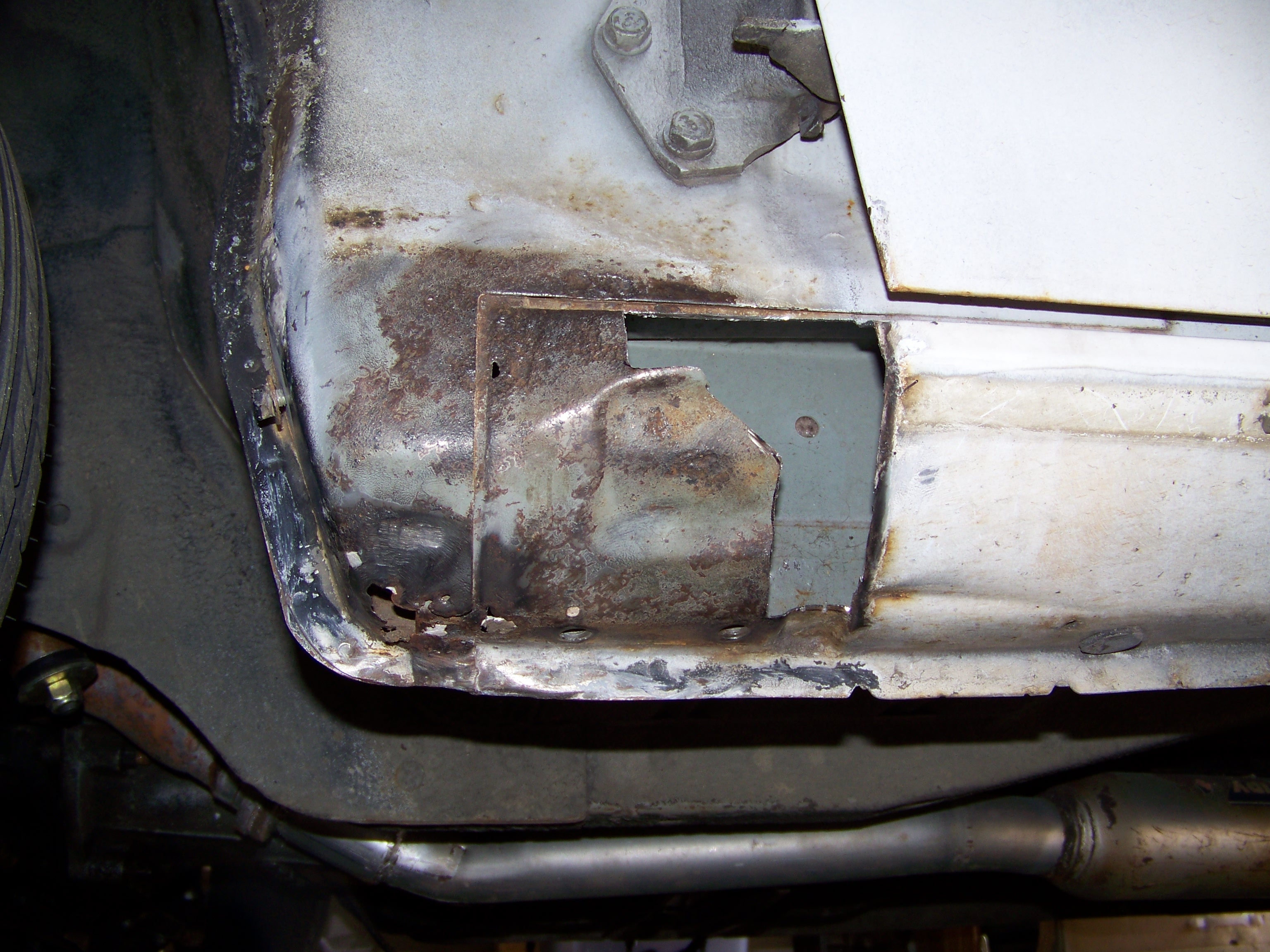

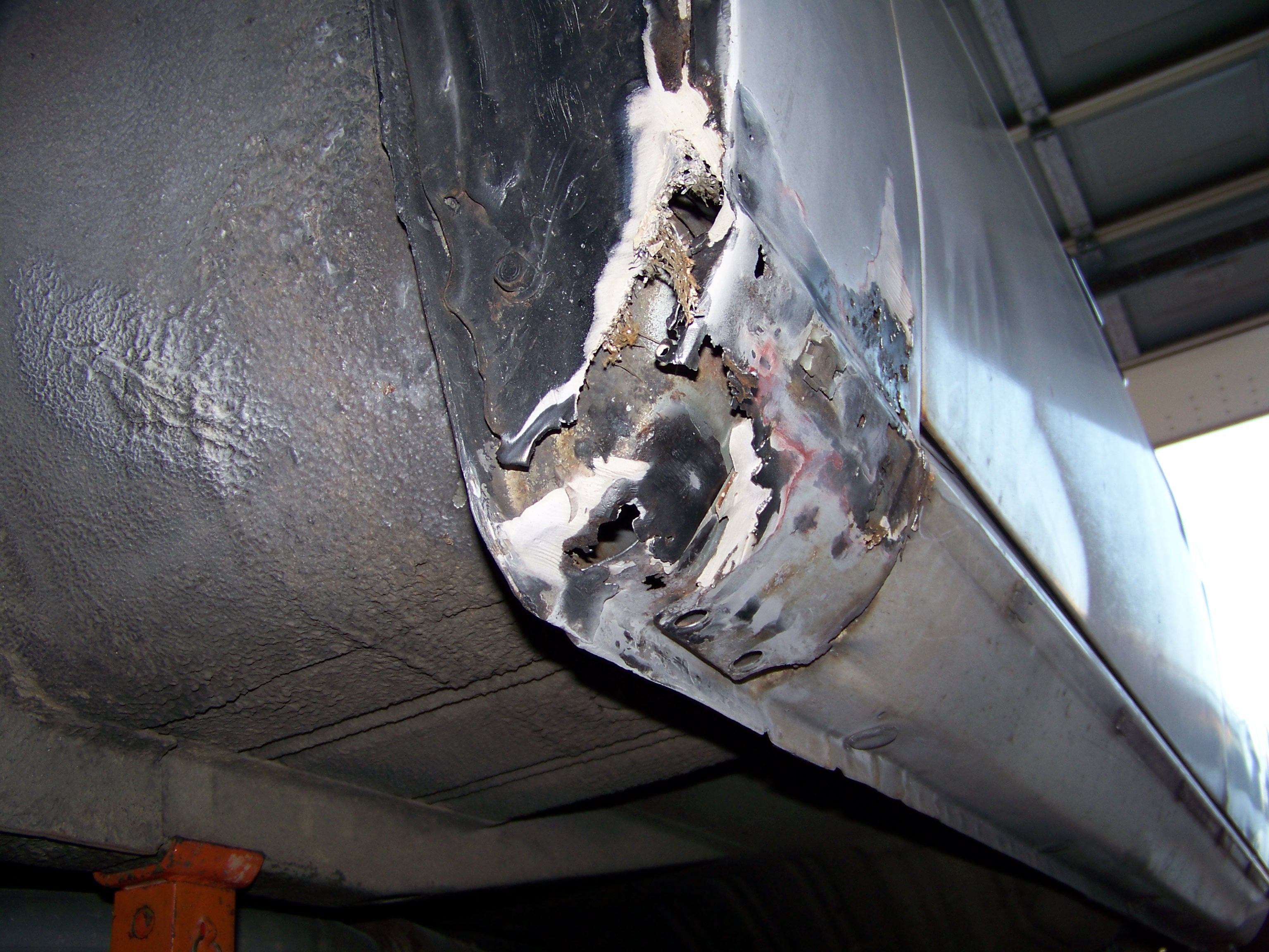

In-between doing this that and everything else i managed to find the time to do some rust repair
And many thanks to Andy43 for the splash panel, whom i owe a beer to when hopefully we meet up :jamie:

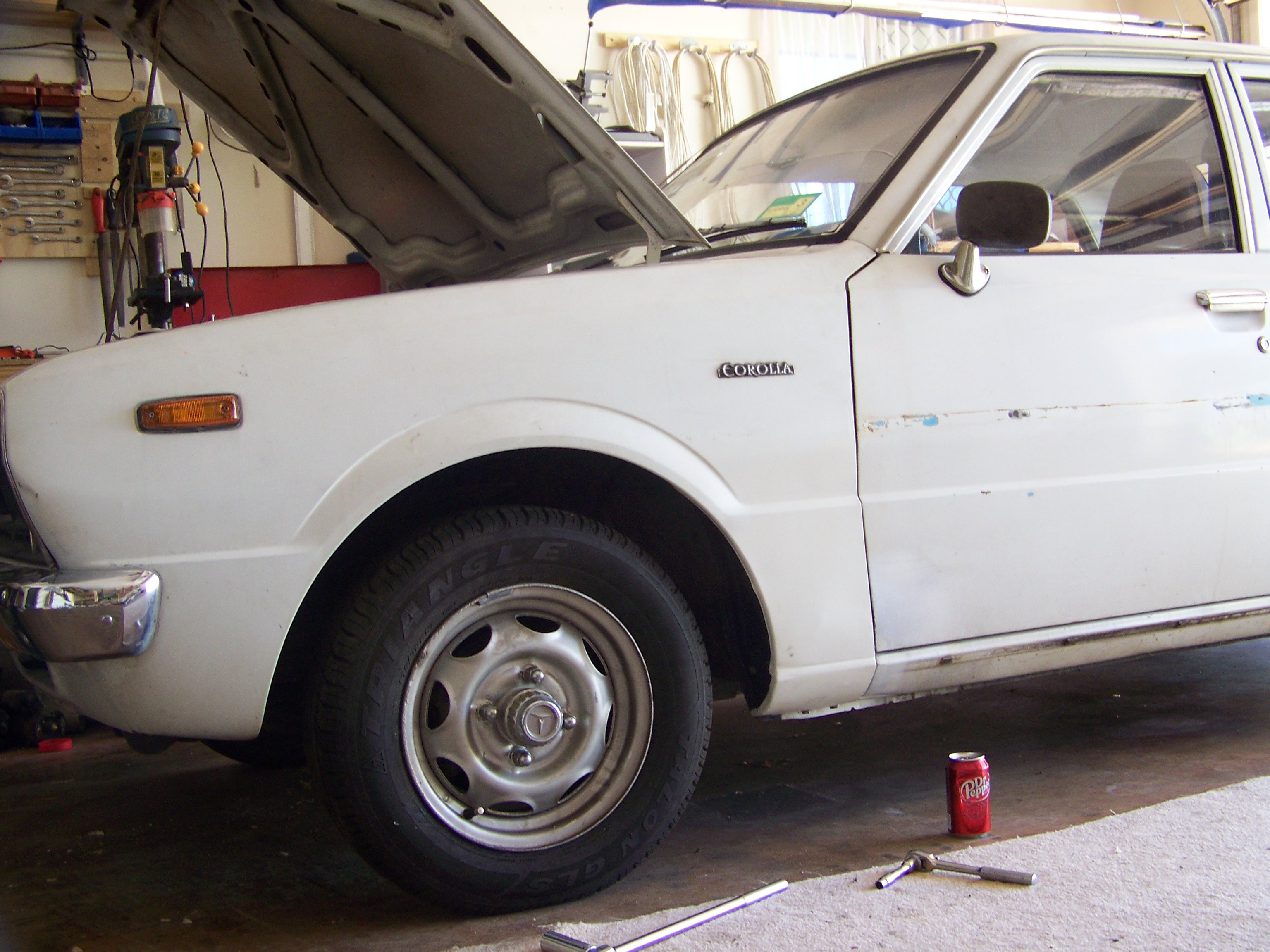

Its taken me forever and a day to get the car back on the road.
May not the best of jobs, but i got it back there.

Rust repair is also looking good. Amazing what you find in original looking cars.

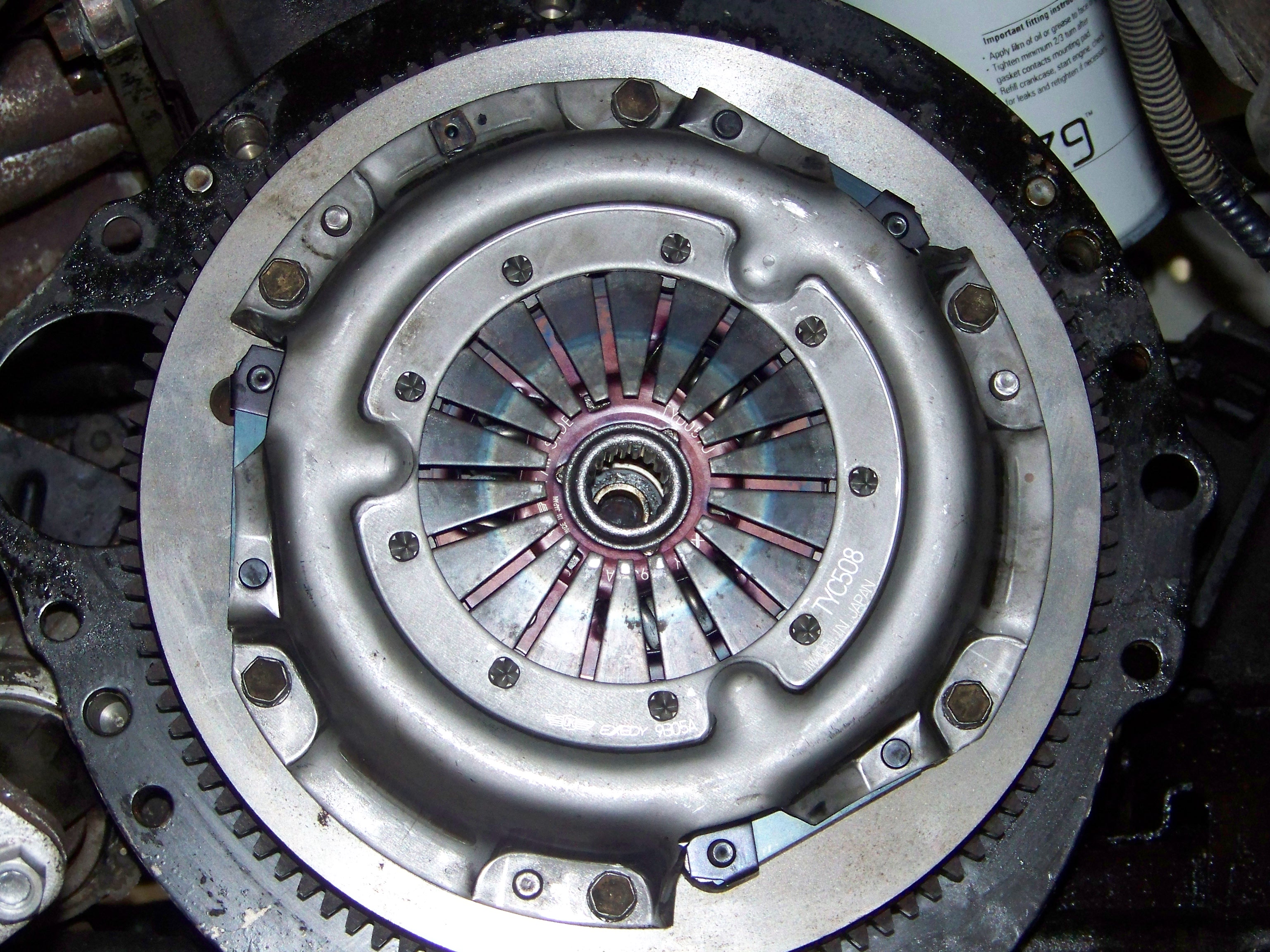

Had a mate come up from Gympie for a few days and he helped me with the clutch. About the only thing we could find was the clutch plate itself was greased up a little.
A good hit with brake cleaner on the clutch, pressure plate, flywheel and inside the bellhousing did a good job on the grease.
Seamed to work in fixing the slippage, but the test drive i think there was still some there.

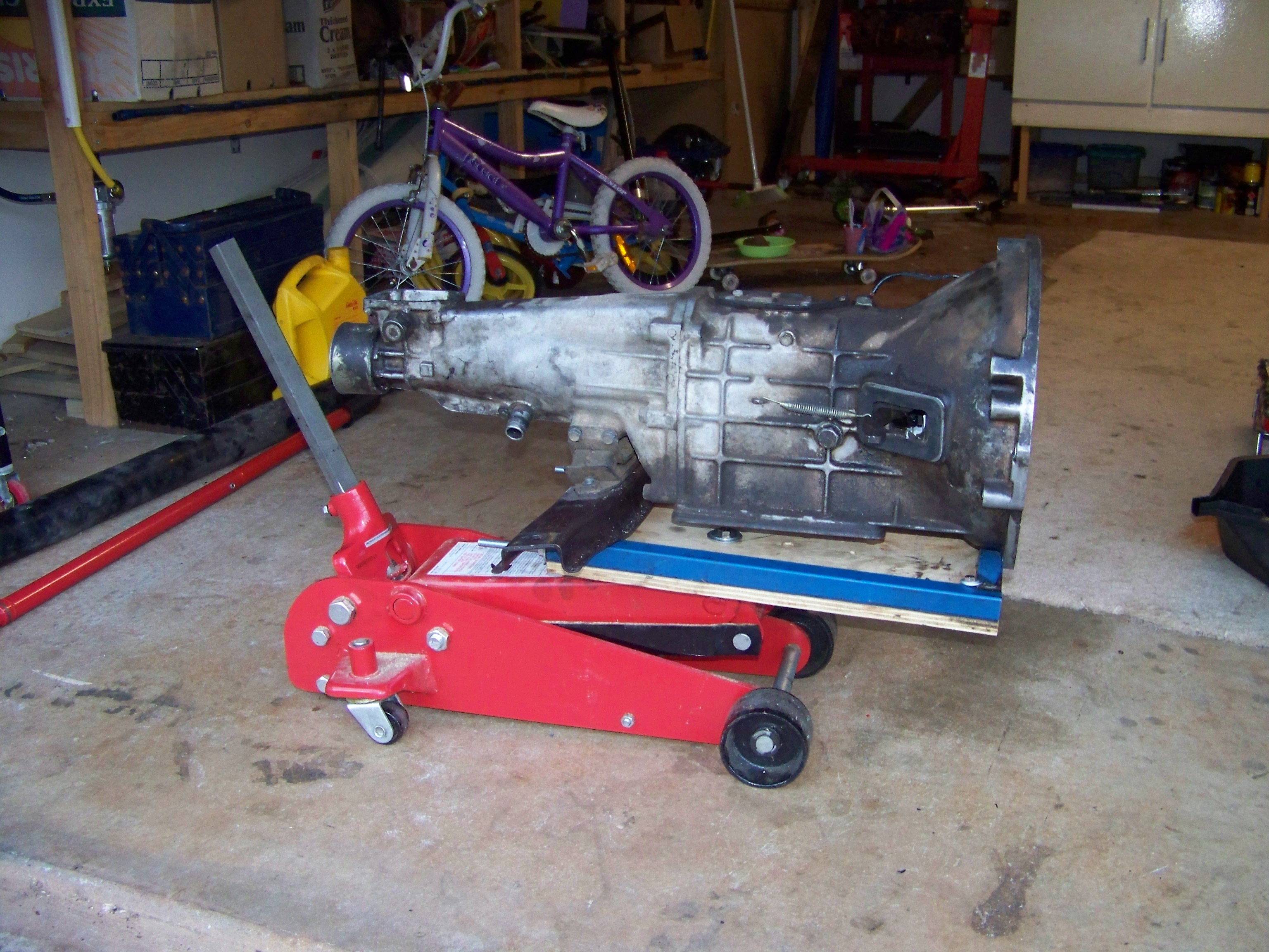

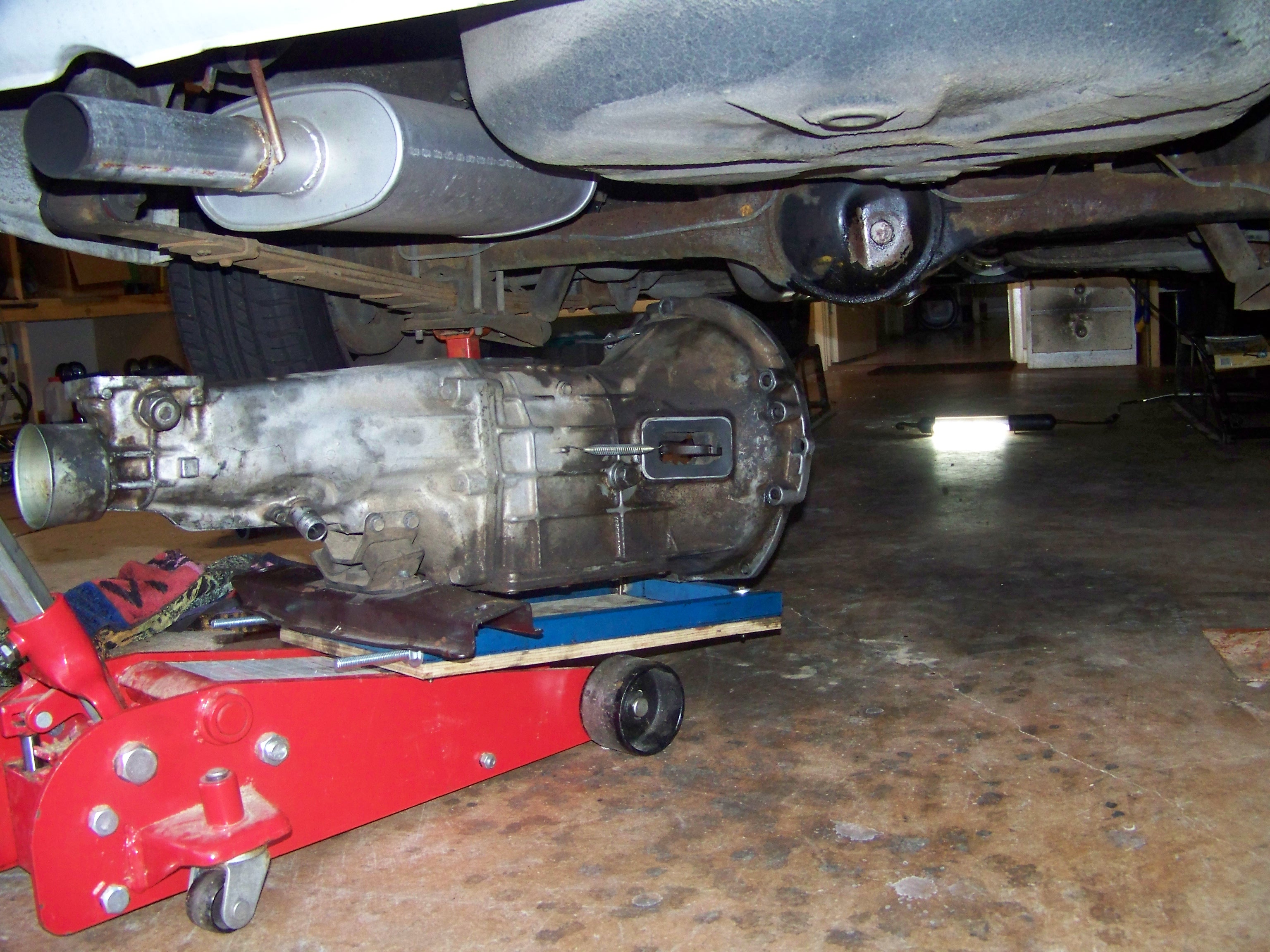

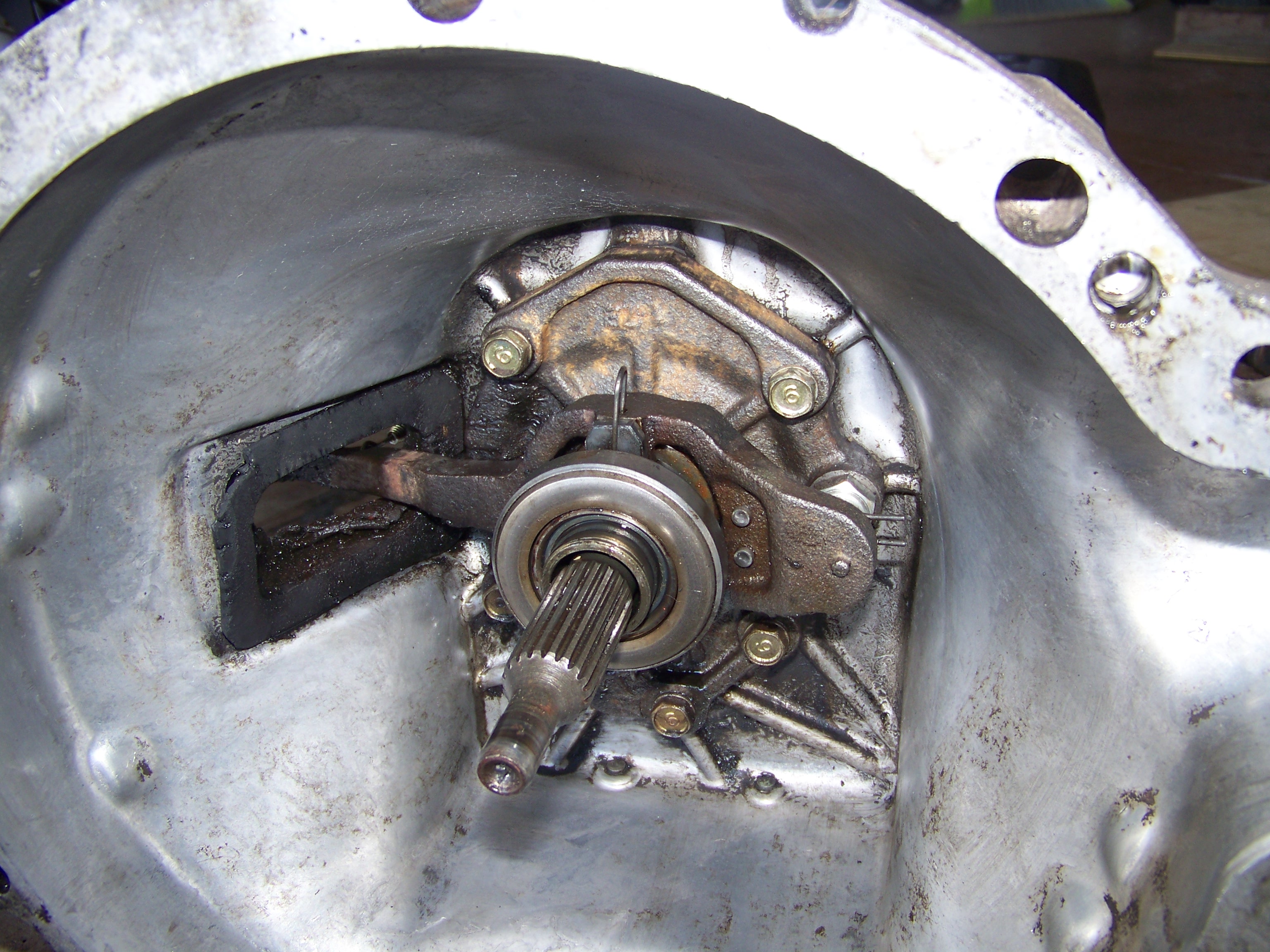

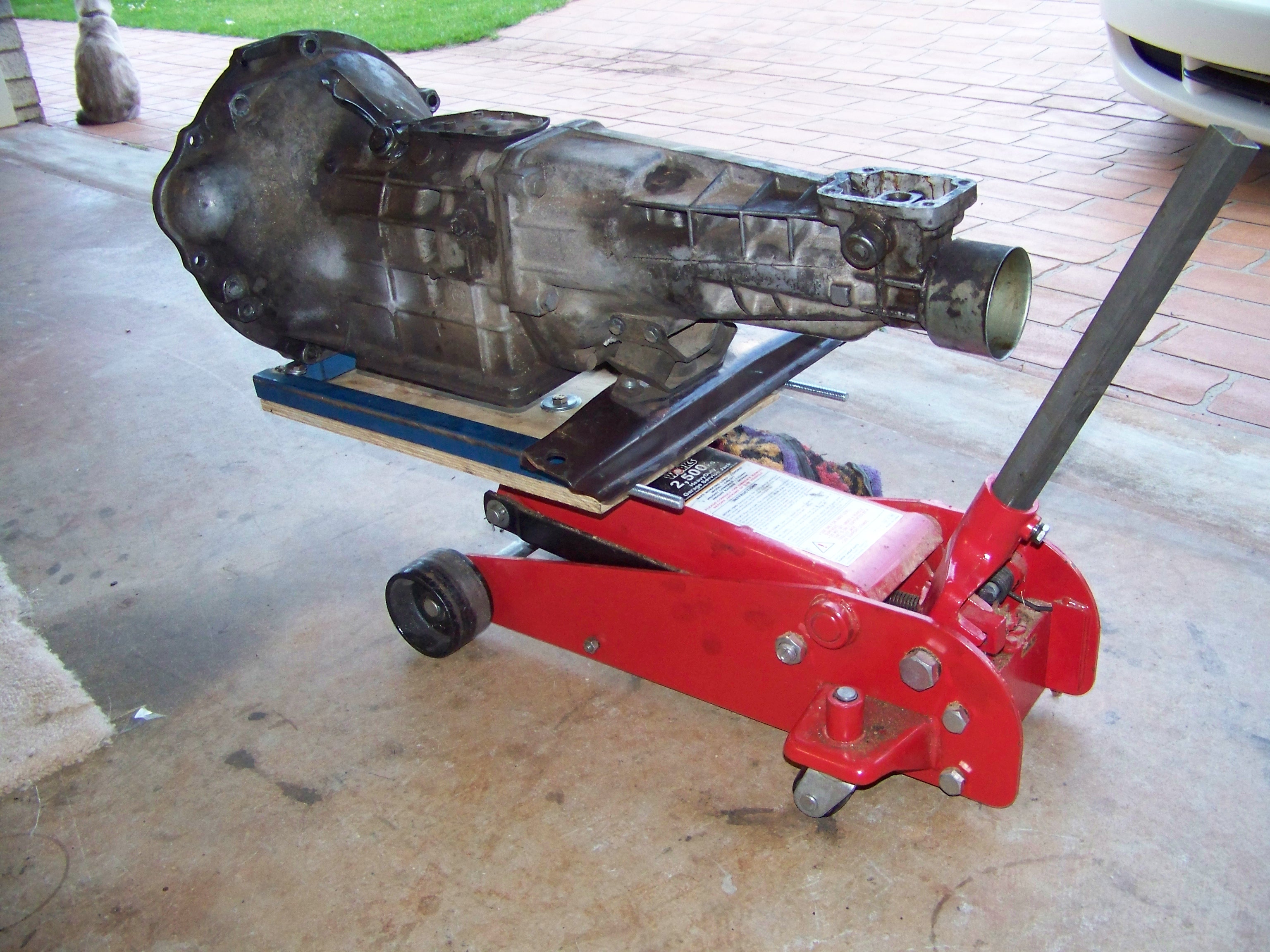

But this time today i had the fun of doing the job of taking it out myself. And with a DIY transmission jack that i made up i had the g'box out and pulled the clutch out.
post-1432-031915900 1303654277_thumb.jpg post-1432-093601900 1303654340_thumb.jpg
The g'box side of the clutch plate, pressure plate still had a bit of grease on it.
But since i was taking it kind of slow i give it all a good bath with three cans worth.
