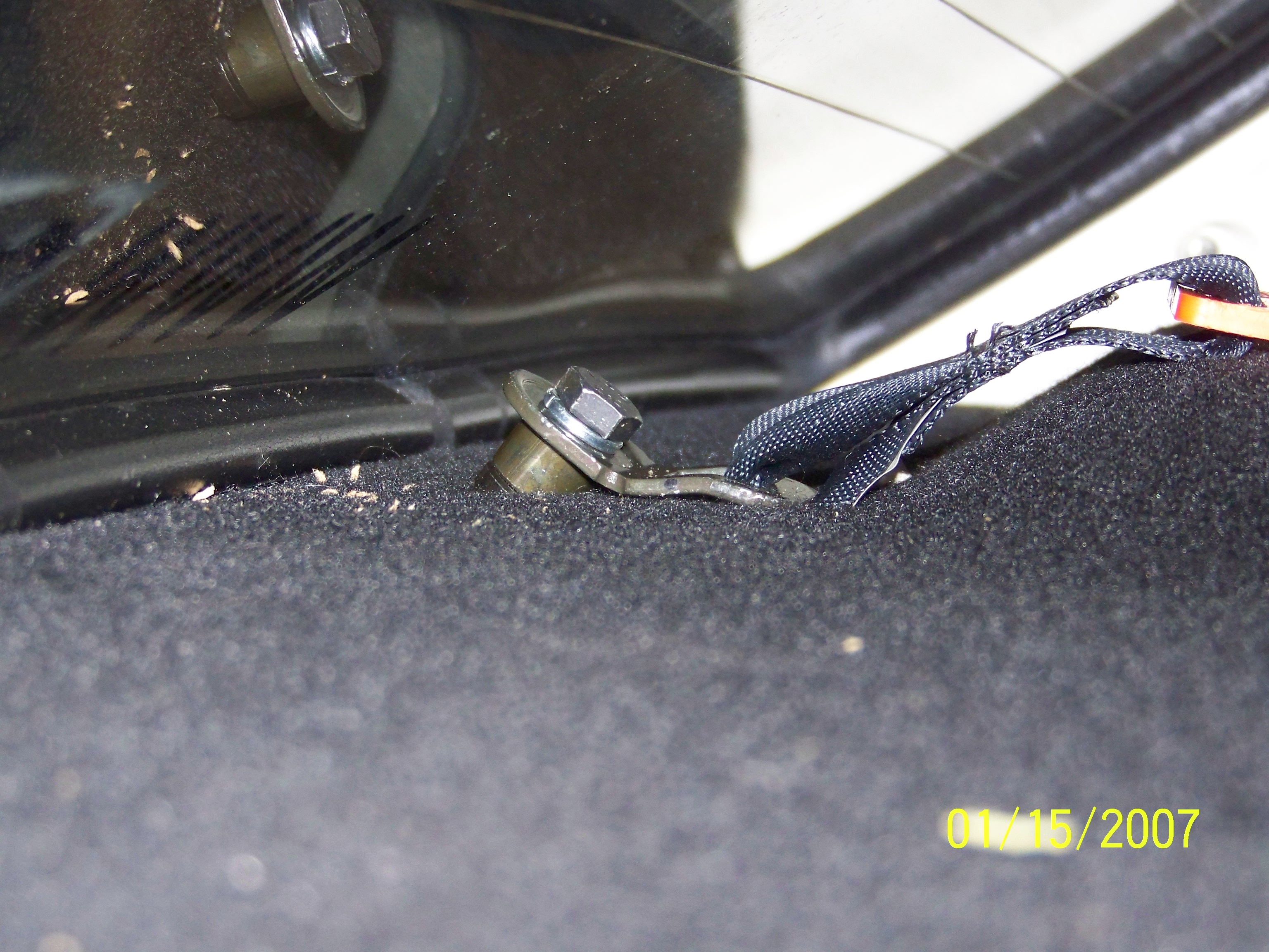

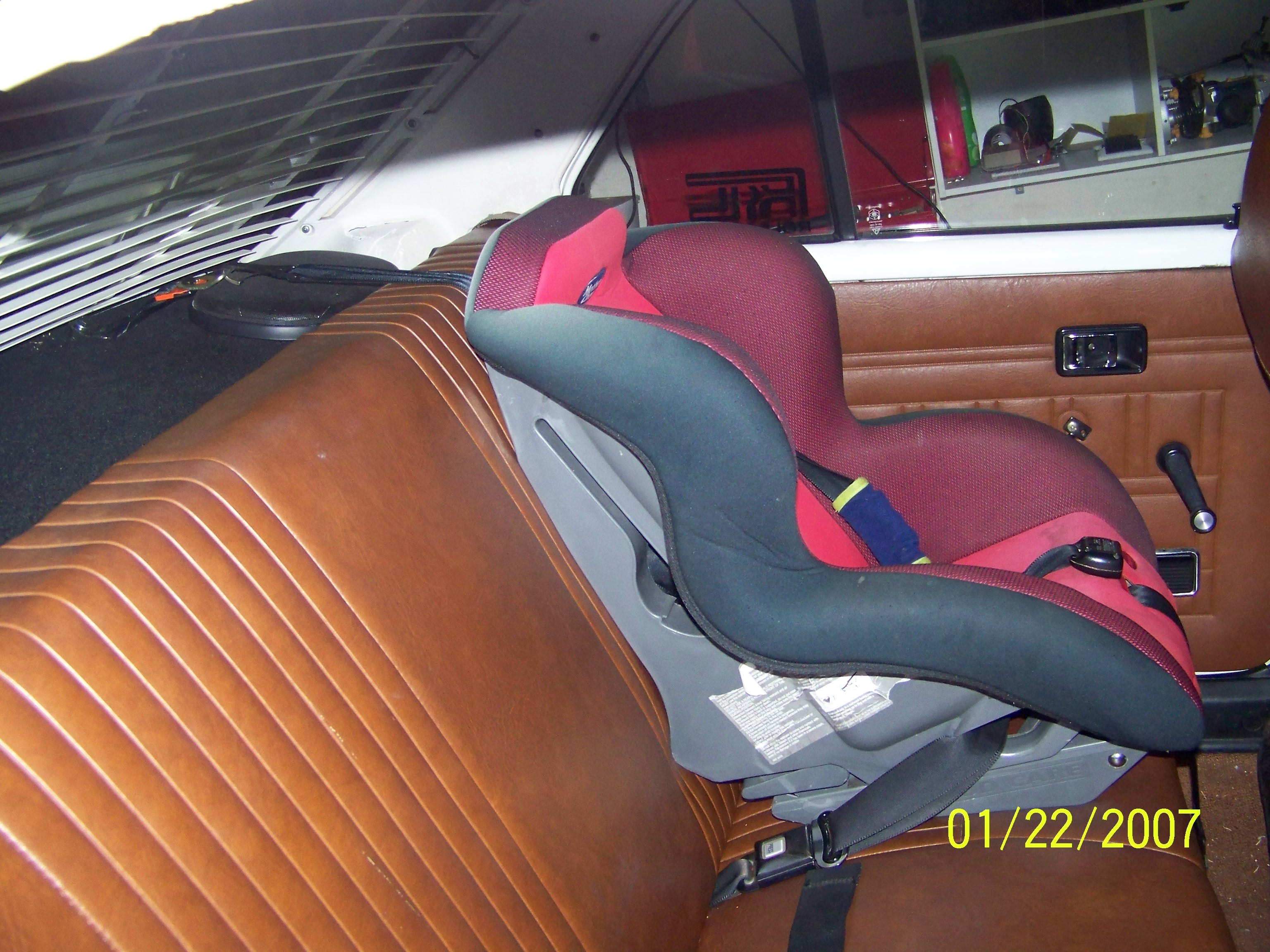

Oh yeah and the anchor restraint is in.

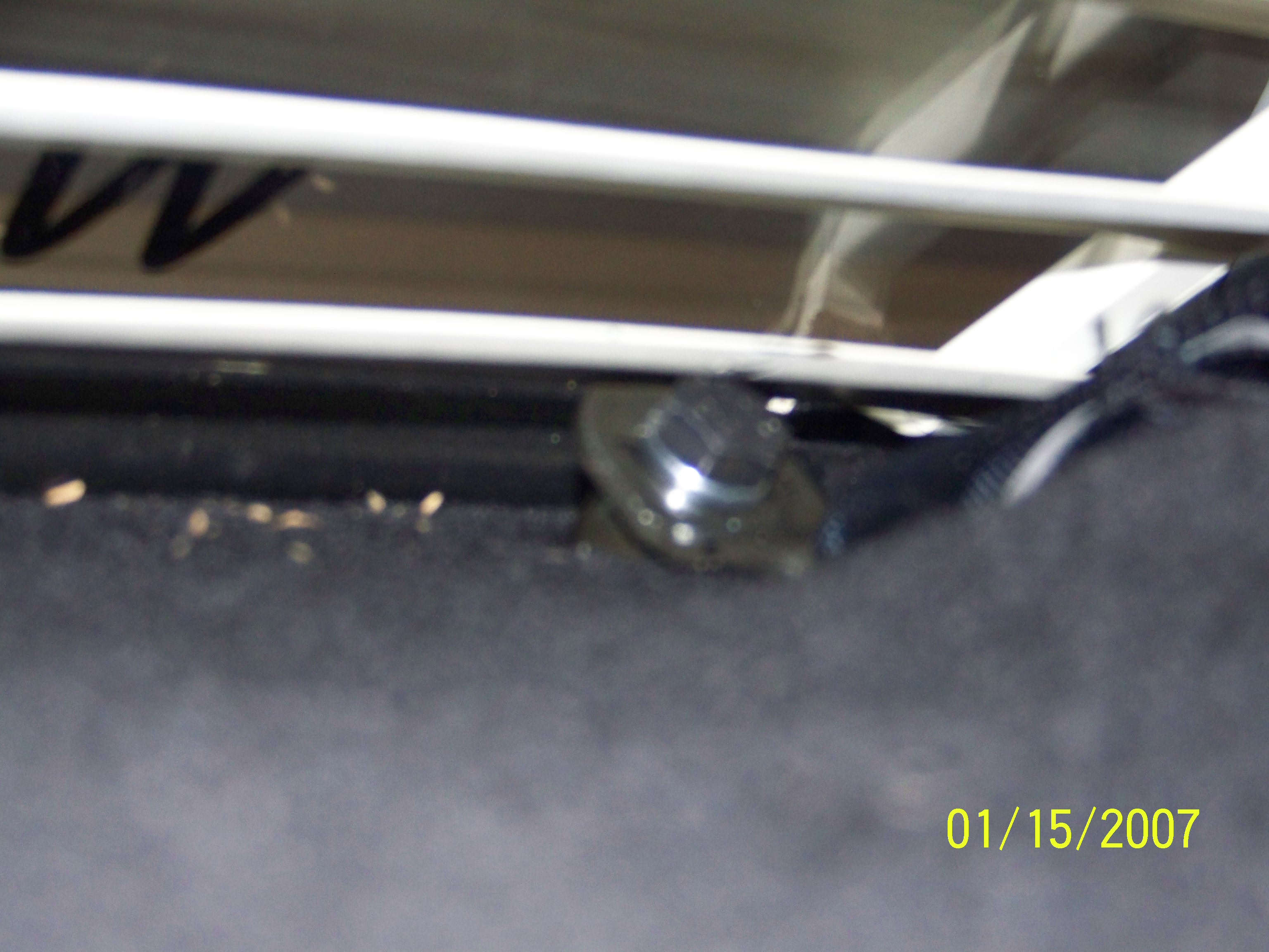

I think having it lifted a little bit would be good so that i can get the clip to fit straight on. Hate the strap
But i have this as a little problem - the bolt head is hitting on the bottom of the venetian. Which is going to make it a problem in lifting the tab up for the clip. I can either cut the venetian a bit or what might be a better idea is to cut a hole up through the board and hope i don't wind up cutting the carpet.
The next step is to get it ok'd for use.
And then its off to find a seat my boy can use, the one in the lancer is miles too big - can, after a fight, get it in the left hand door but to clip it in i have to go in through the right hand door.

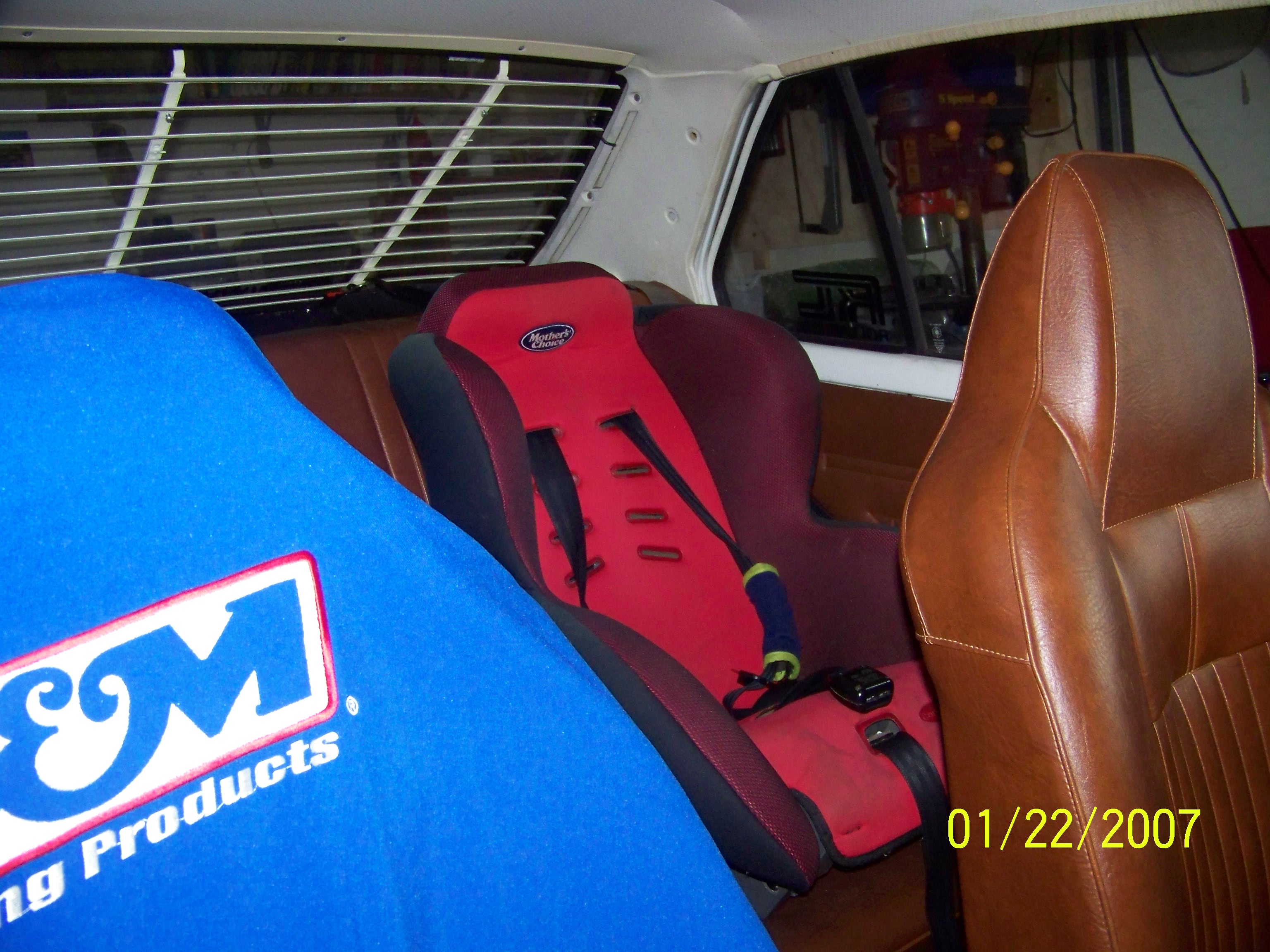

  • Starting to throw the idea around of turning the thing into a speedway car. Just have to find out if we can run an auto in it or if it has to be a manual.
Jacobs old seat, he still fits ok
so i might use it for a bit till we can get something better

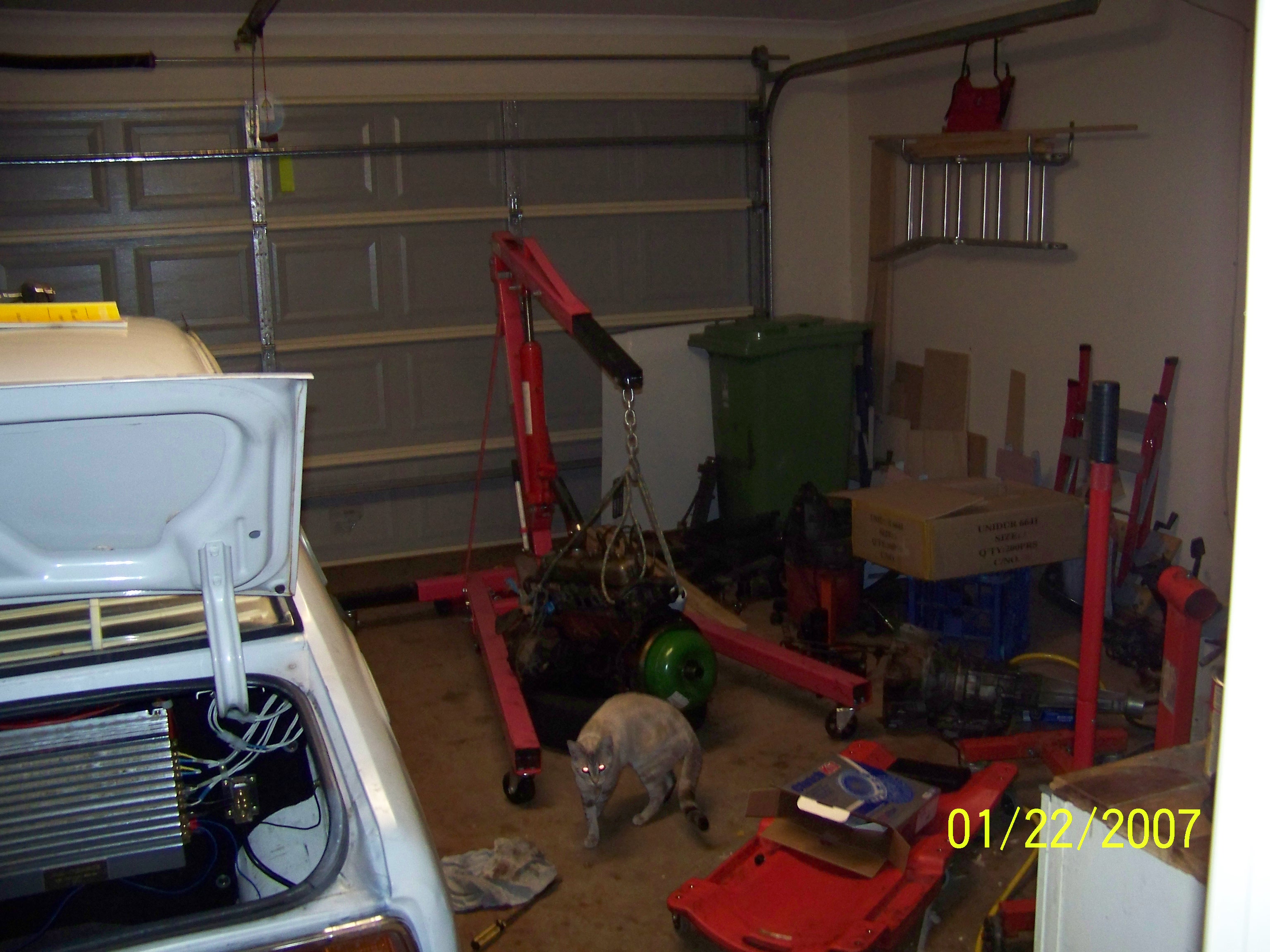

5K in and sitting on the Liteace engine mounts
3K out and sitting in the war zone

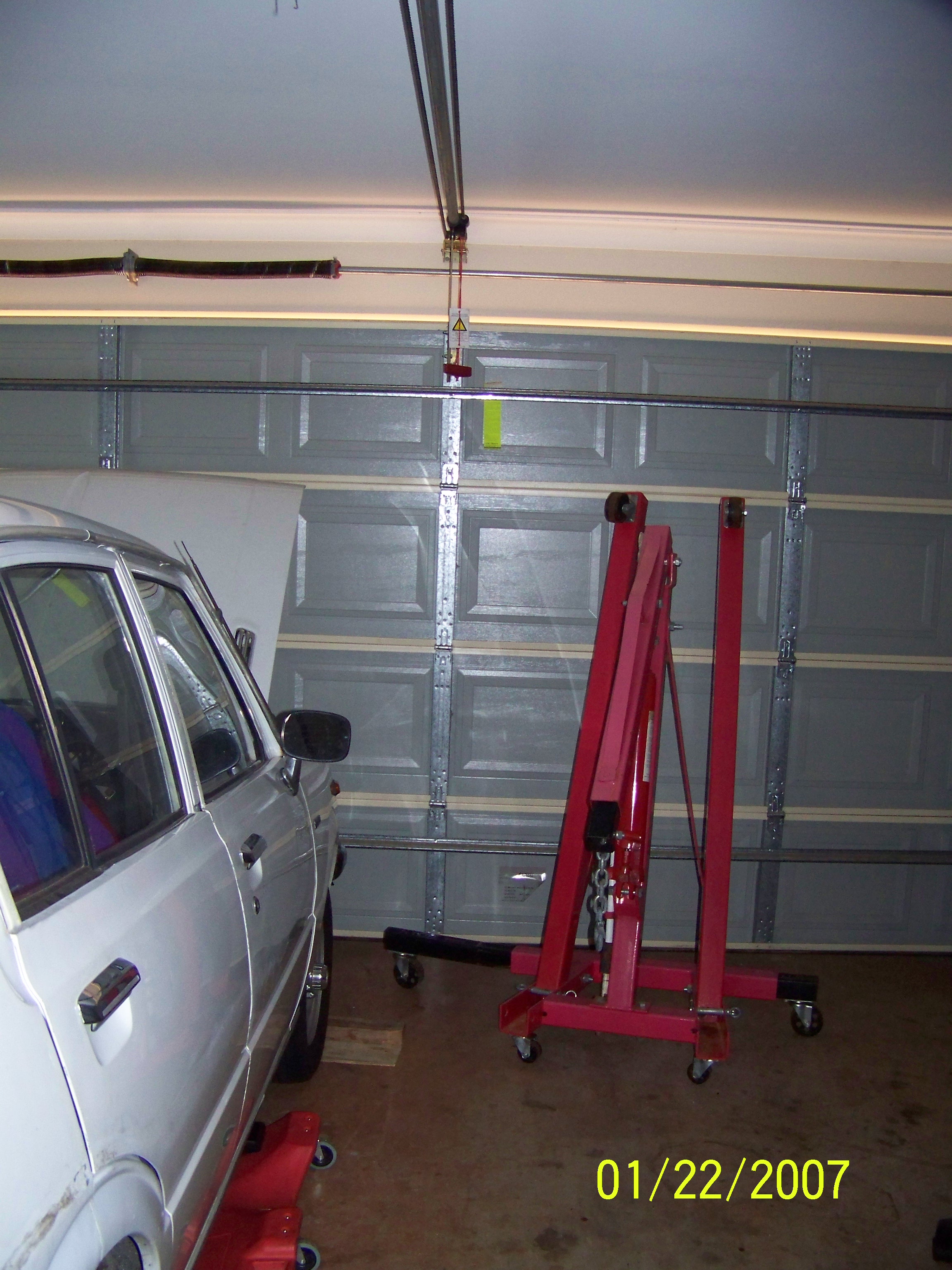

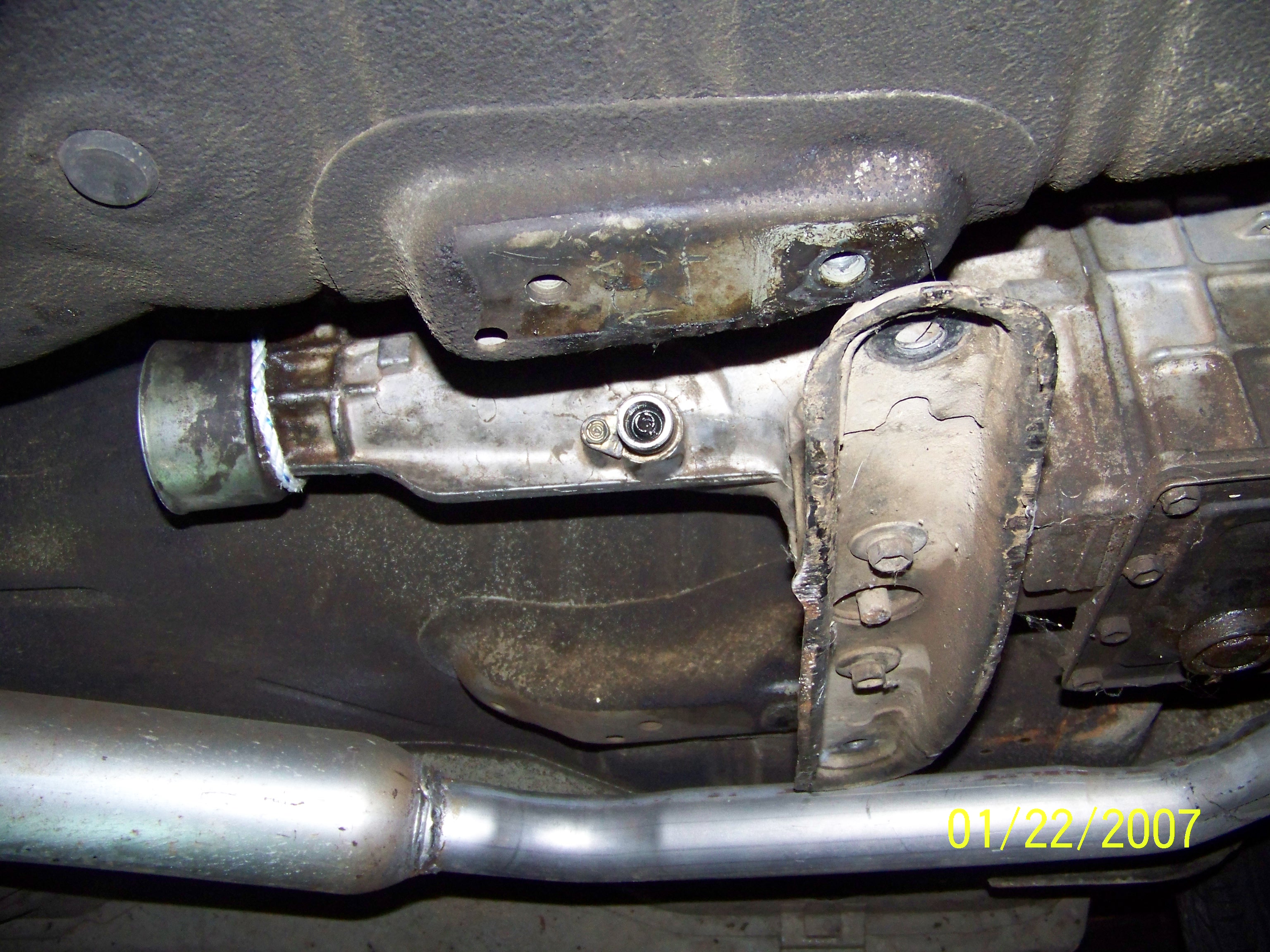

k50 five speed from a ke70 lines up in the hole
but after dinner and after i jack the car up i'll post a pix of the little problem i have with the gearbox mounts
And of everything that i knew about going from the auto to the manual has gone out the window.
The manual box is just a touch in front of the bolt holes for the auto mount.
From everything i knew, the x-member for the manual used the bolt holes further back, not the same ones as the auto.
What a bummer :P
Can you just redrill some holes on the bracket and bolt it up there?
Should line up if you use the 3k engine mounts. T50 crossmembers use those rear holes..

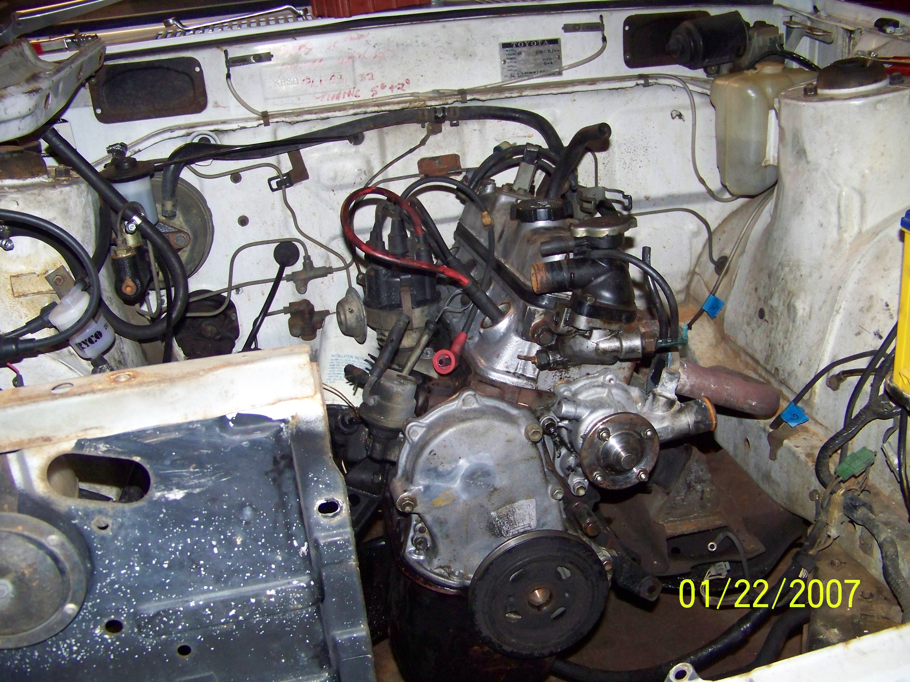

I started thinking that it could have been the liteace engine mounts so i swapped them over to the ke30 ones. But nooo it's still the same. Had it all kind of lined up with the re-drilled x-member from the auto, but then i noticed the engine and exhaust manifold had a really nice gap at the rear end of the head and then i remembered about this post Auto To Man, Ke30 Advice - post #3 and so i dropped the box down and low and behold the manifold lined up :P
But now i can't use either x-member cause the phuckin exhaust is in the road and i can't take the thing out and bend or dimple it cause it's all one piece.
But i'm thinking outside the box of the auto x-member clears the exhaust nicely but doesn't really work with the g'box, but the manual x-member works on the g'box. So with a bit of cutting and a spacer plate thing i should be able to have something that works.

Yea ,5k blocks are taller than 3ks so exhaust manifolds end up higher and exhaust pipe closer to the floor
Yeah thanks for that :bash: :P something i completely forgot about
Have been wondering about that if the pipe is up a little higher. Cause i get the g'box up somewhere close to where i think it should sit and the exhaust gets a bit too close to the floor pan for my liking. Hmm, i think i'll finish off that mount then drop it down with some washers or something till i can get the exhaust fixed.

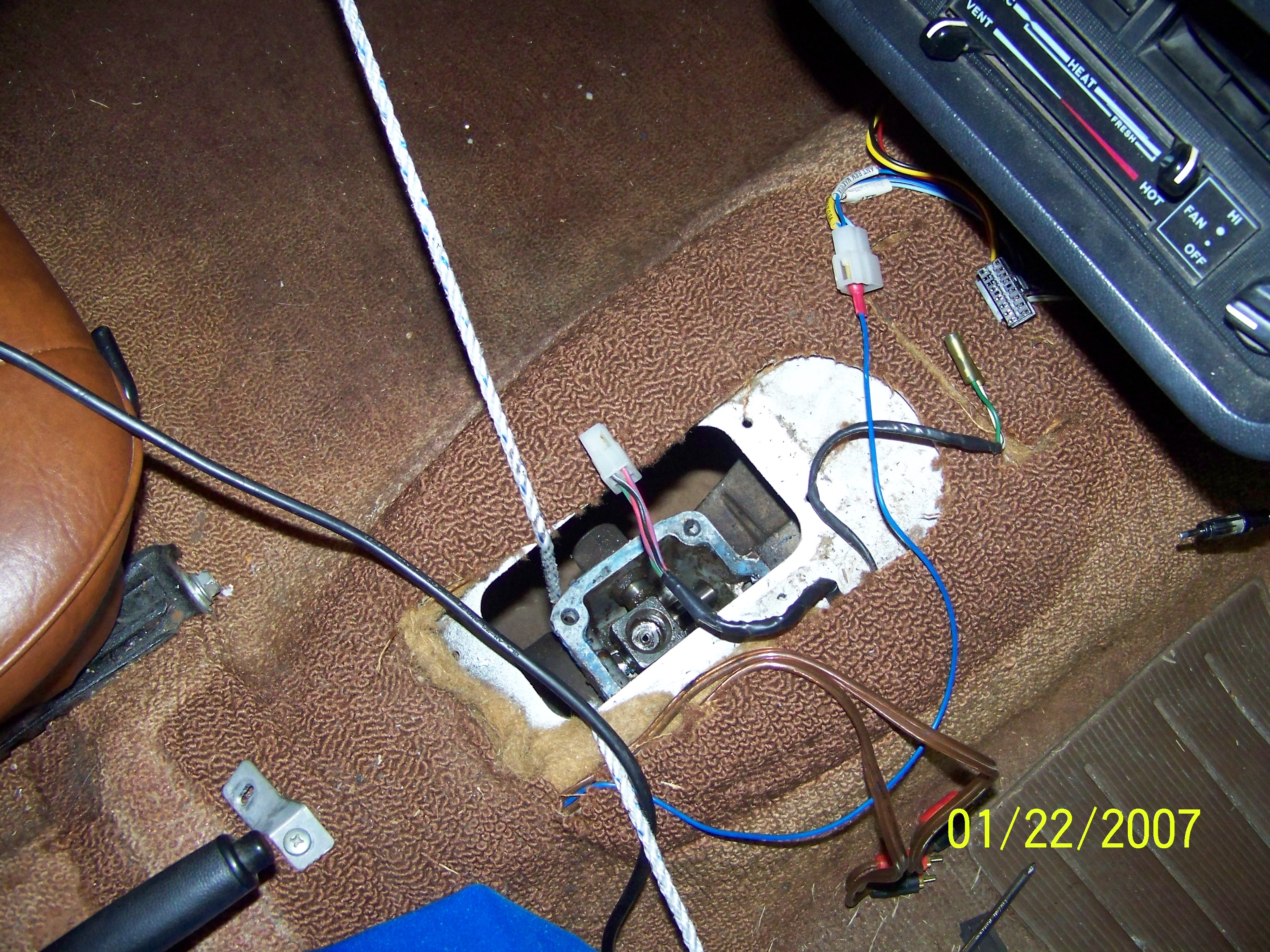

I don't have the wiring connection under the brake master cylinder for the reverse switch on the g'box so i had to make up a length of wire from the plug on the box up though the hole for the shifter to the plug for the auto.
All went well till i tried reverse.... no lights. The damn switch is phucked :yes:
Got the rest of the odds and sods done last night - toggle switch for the reversing lights (not overly happy with the idea but it'll have to do till i get something) and a few other bits.

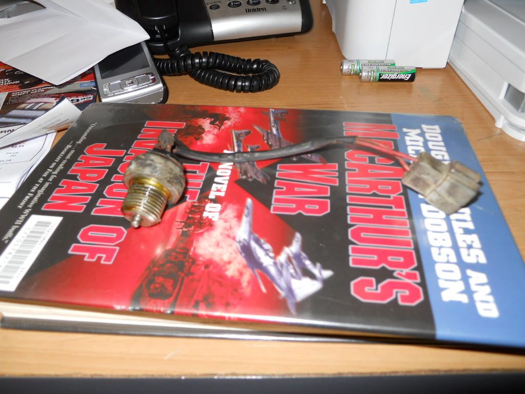

i had no reverse lights. unplugged the switch and plug it back in, then it worked LOL? did you try that? if you bridge the connector do the lights come on?
Yeah i was thinking that i might have mucked something up with the wiring so i traced it from the connector where the auto shifter was and down to the gearbox switch but it was all no go, so i pulled the switch out (27mm spanner) and tested that and it was stuffed.
Had a look on the Tridon site and downloaded their switches catalogue (http://www.tridon.com.au/downloads.aspx). Nothing for the KE series corolla but after a little searching the liteace k-series uses a TRS007 switch (along with a quite a few others uses the same switch) and the other but is that it has a different connector style (its on the switch not a flying lead) so it'd have to be modified or find a plug for it.
