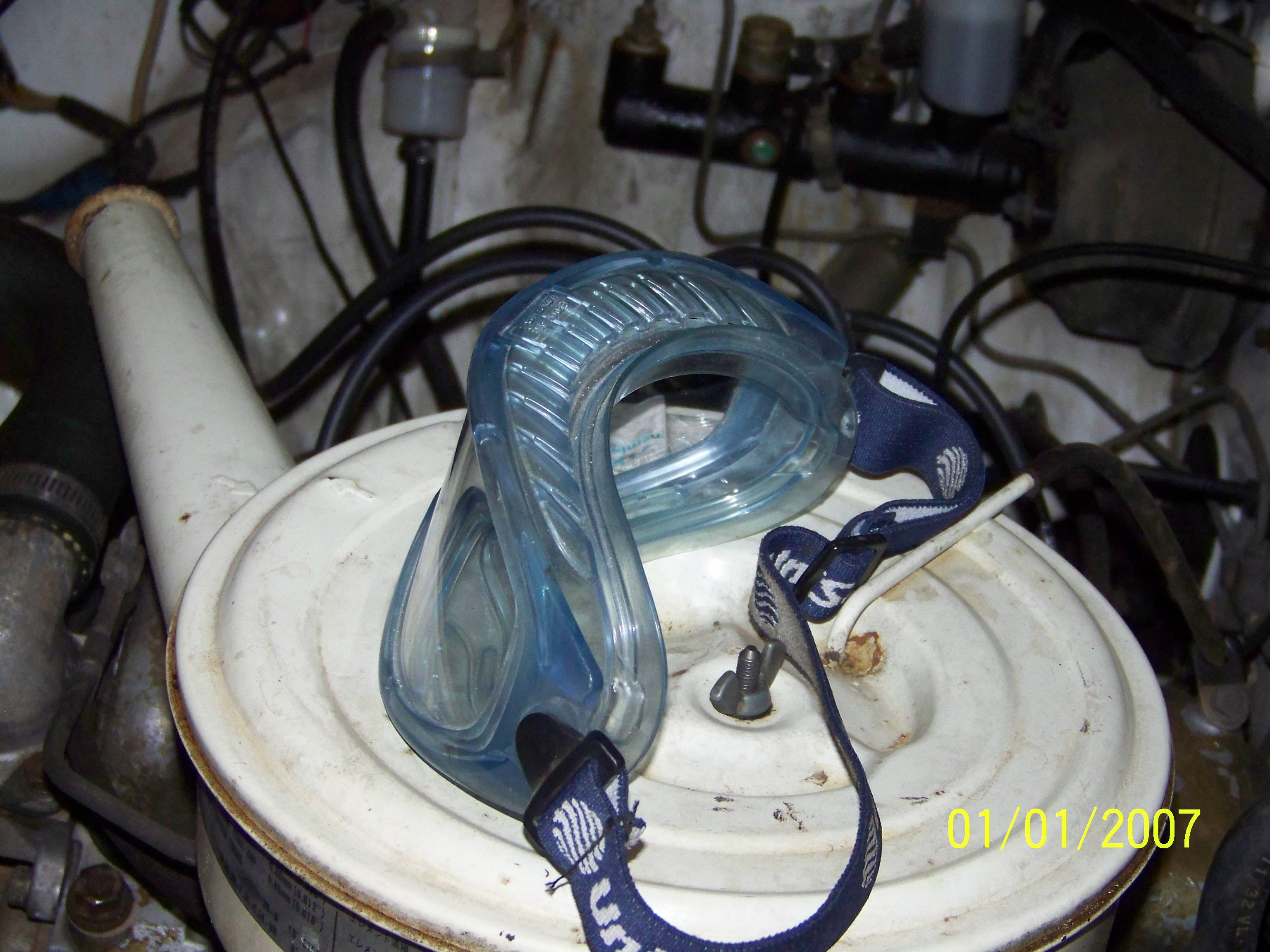

I just wish the stoopid thing would stop fogging up after about 10 minutes of laying on my back looking up at the cars junk.

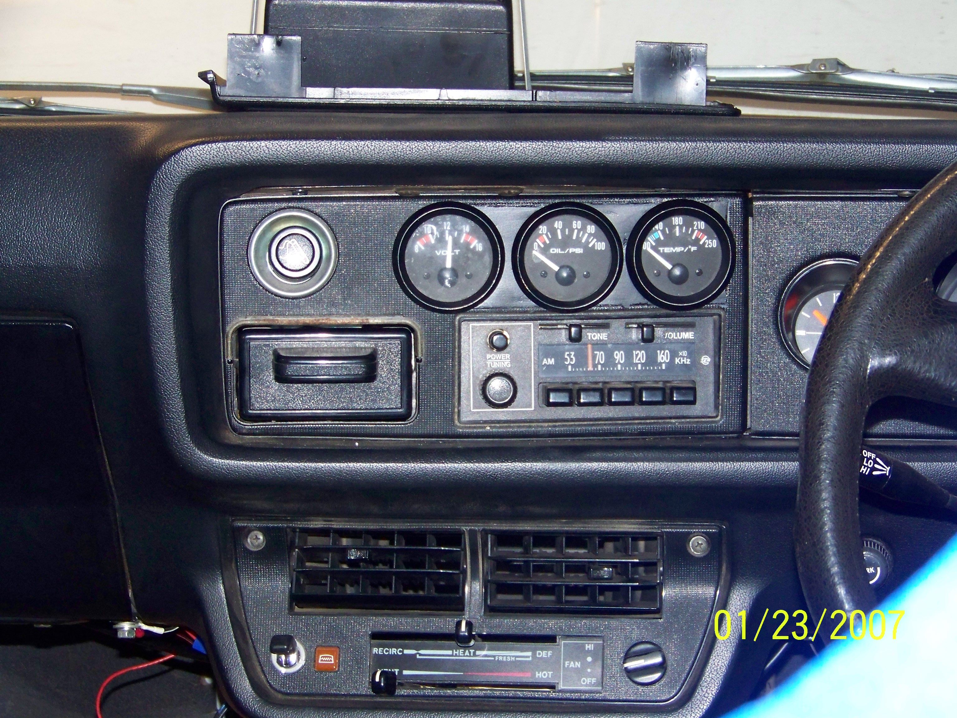

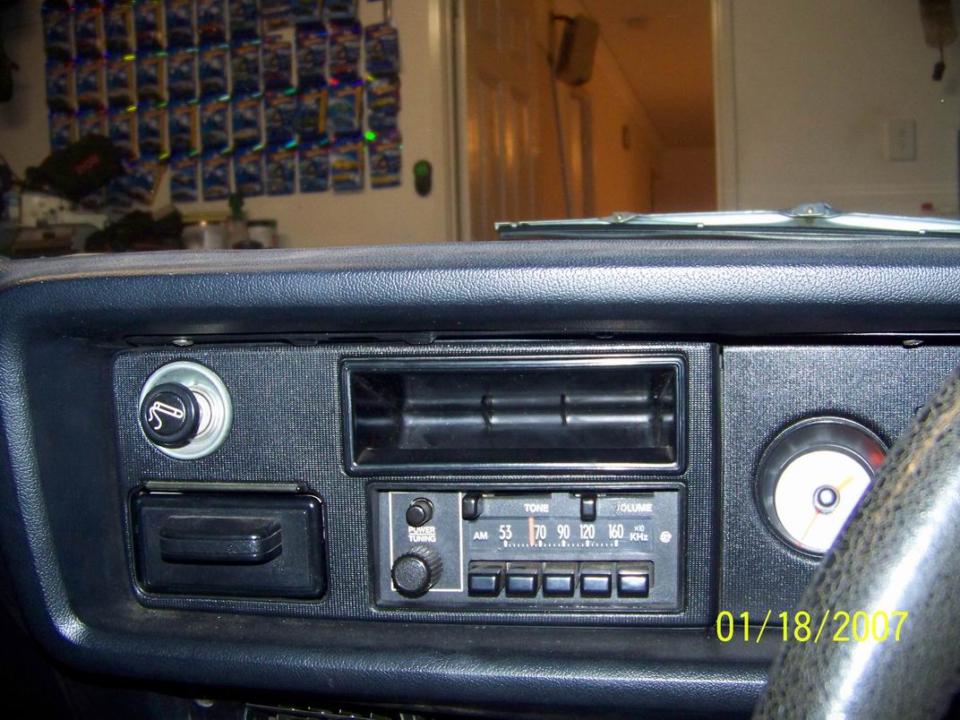

Been toying with the idea of a couple of gauges where the pocket is above the radio. Like the TE37 style
Done

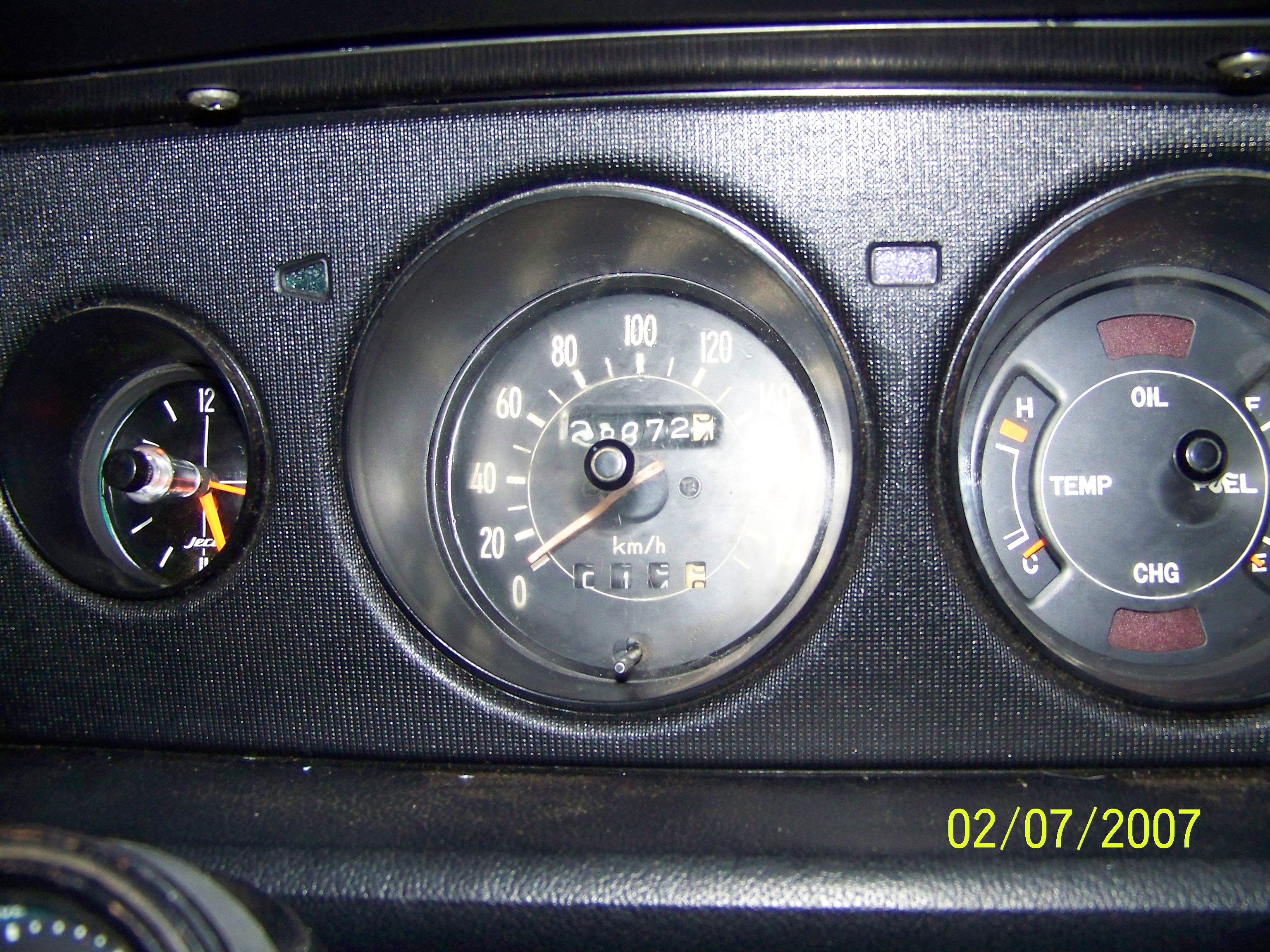

For some reason the volt gauge has clouded up. So i might have to get a new one and i want to swap the temp gauge for one in celsius.
Next on the list is tacho and vacuum gauge. Toying with the idea of an aftermarket fuel gauge where the clock is and the tacho where the fuel/temp combo is, just would have to figure out with the warning lights and where to place them.

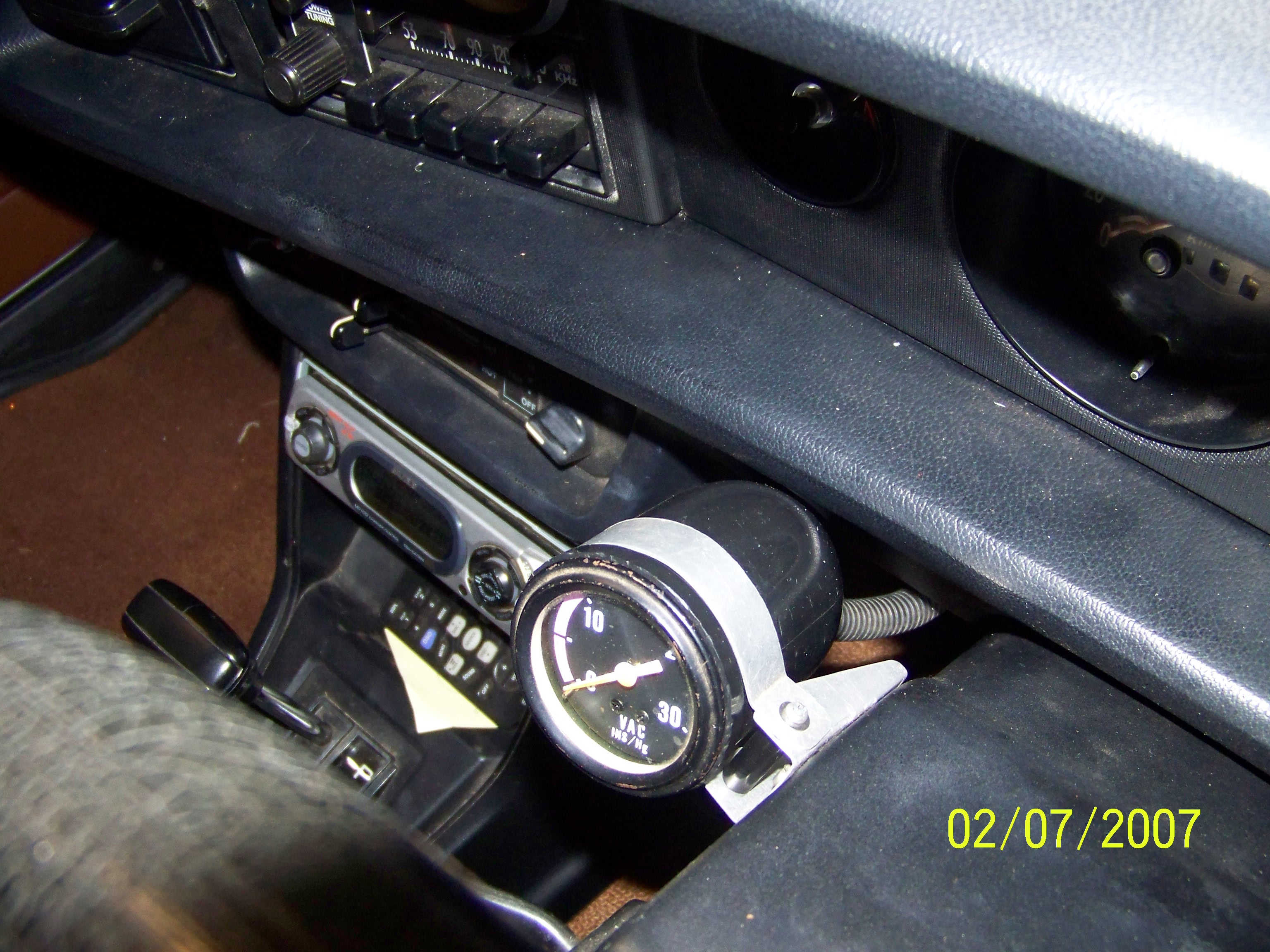

Installed a vacuum gauge over the weekend.

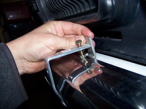

Tow ball cover and a bit of aluminium
And fitted the speedo from a ke50

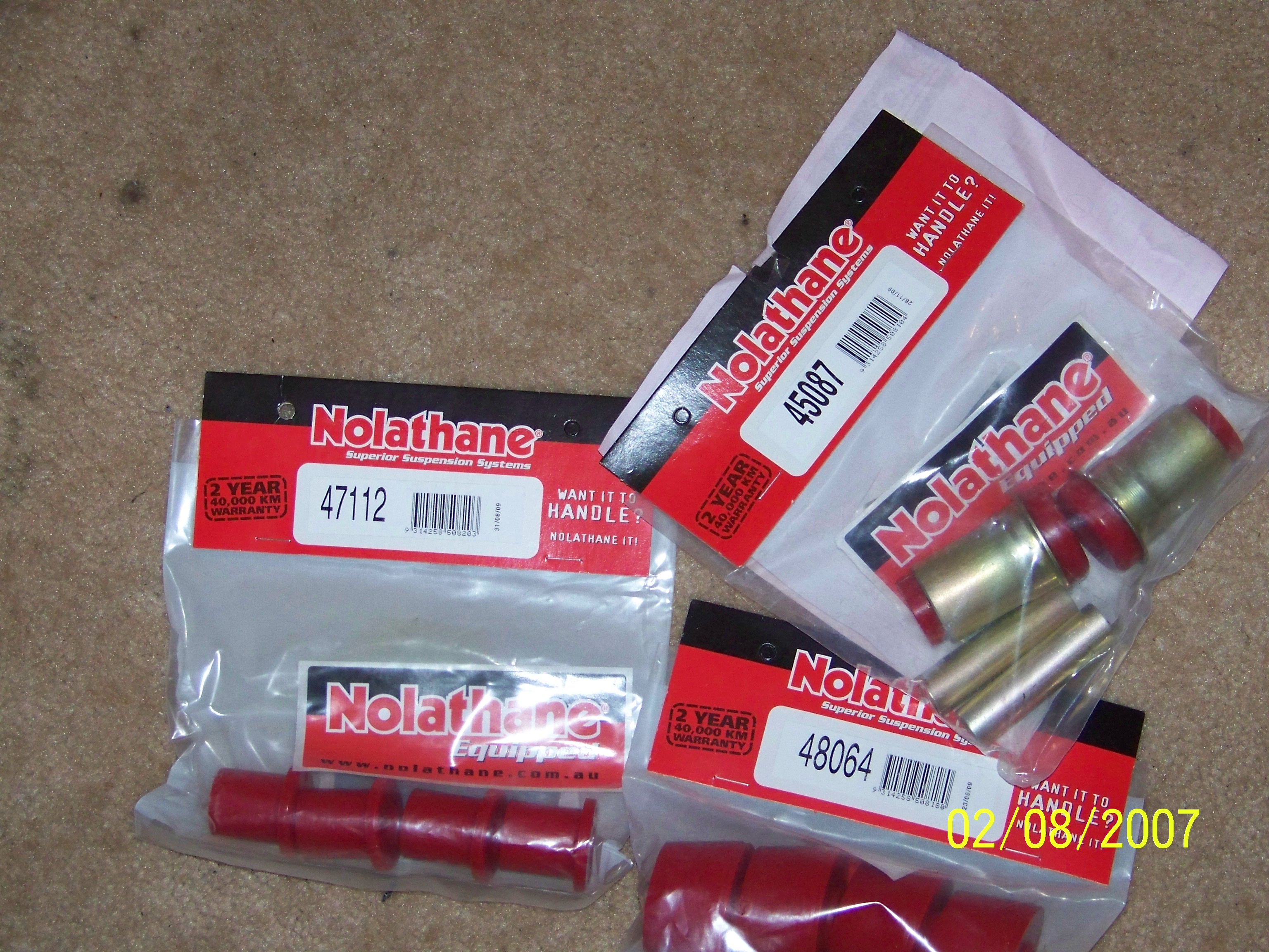

Next instalment will be tacho and hopefully some nolathane bushes. If the f@$kers ever leave brisbane. Went into autobarn on saturday to see if they were in and found out they've been sitting at the brisbane depot for about a week or so....
Nar, i think it might have been cause i got stuffed around a little bit with it all. They've done it a couple of other times but haven't been all that worried about.
But any ways, Amber (the other half) went into autobarn today to check up on how it was all going and about an hour or so later got a call to say they've come in.
The kit "47112" i almost felt like having an argument over. Tried telling the guy i needed two (2) kits, "but in the book it only says one kit is needed". So now i'm right and it looks like a trip back to the 'barn to order the second kit.

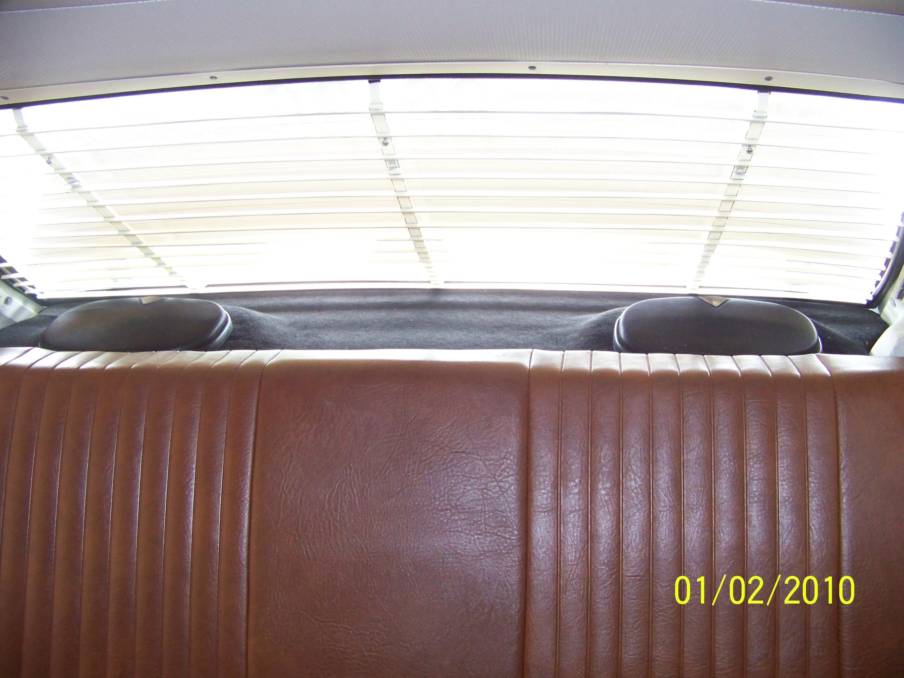

I like the work you did on the rear parcel shelf, looks real neat :happy:
