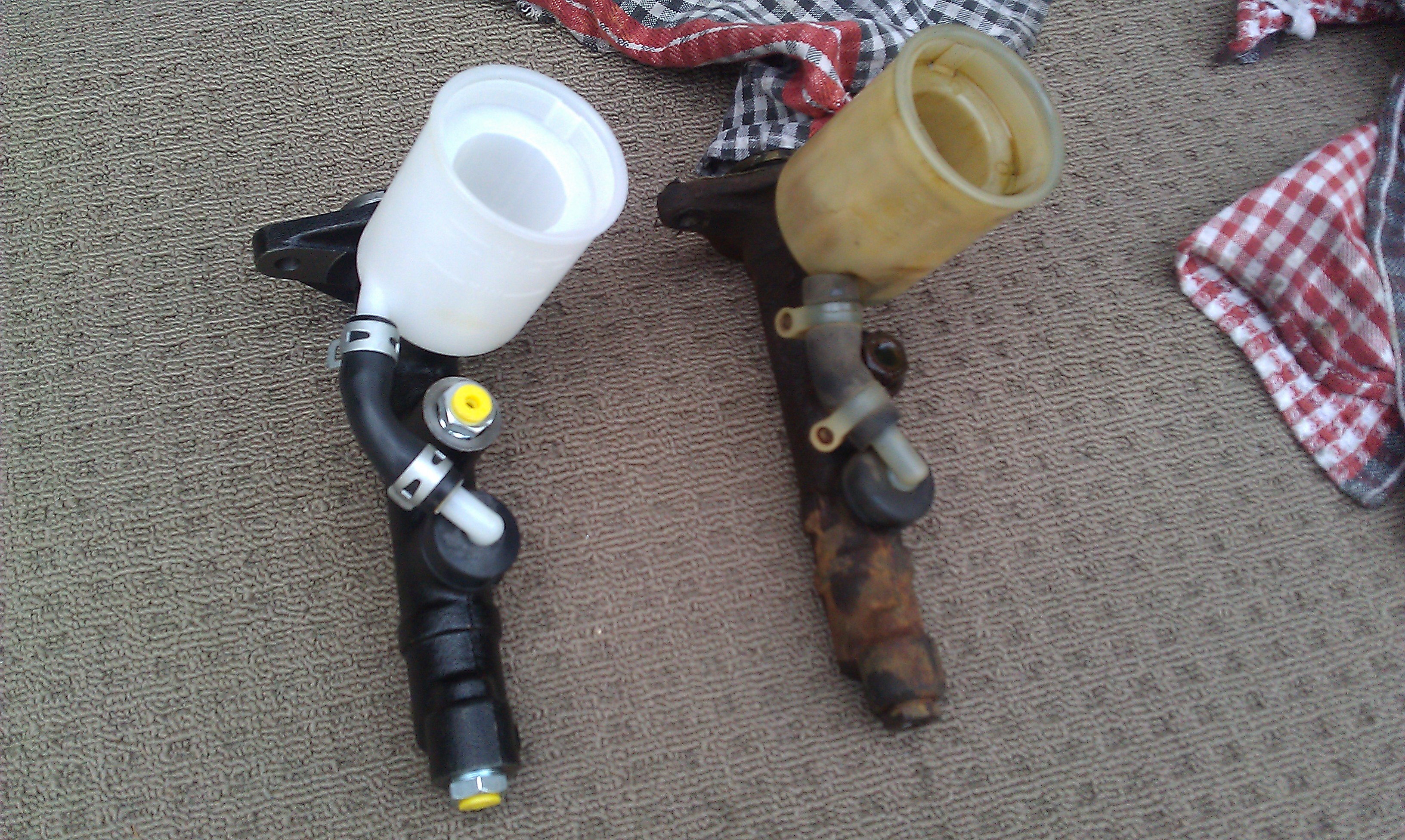

My few days of Fails and learning curves
Ok so here goes.
Bought new master on Friday.
Ella came up Sat morning to help install and bleed.
Installed fine, everything tight.
Problem 1: Air kept creeping in somewhere
Problem 2: Pedal travel too short for some reason.
Luke and Reed bleed brakes for hours to no avail, finally give up before smashing things.
Sunday Reed decides to have another go.
Opens bleeder nipple on RL drum and cannot close it, its stripped. Need new slave
Has to wait till the missus gets home before I can get a new one, last shop I went to.
Get home and install slave, would of done both but they only had 1.
Gravity bleed brakes as missus is busy looking after our kid.
NO AIR IN LINES WHATSOEVER.<br><br>Push brake pedal and nothing.
Decide to remove master and check, can't find a 10mm, decide to buy flare nut spanner to save stripping bolts
Give up for Sunday.<
Monday, buy spanners.
Get home and begin to remove master.
Even with spanner manage to strip a bolt, but its on the short line so undo it from splitter.
Bench bleed MC with out a bench, get covered in brake fluid.
Install and bleed system again.
Still nothing. Starting to get REALLY MAD.
Sit in drivers seat in anger and STOMP on pedal, feel something give in MC and finally get proper pedal movement.
>Bleed system AGAIN
NO bubbles, hit pedal, goes to the floor.
Disillusion sets in. Drink beer.
Check everything, RL drum cover is still off so slave is blowing fluid everywhere.
Feel like a dick for a bit.<
Replace drum cover.
Get missus to help bleed AGAIN during the ads while she is watching Glee.
BRAKES MOTHER F**KER
Test drive and forget to tighten wheel nuts.
Tighten wheel nuts.
Accelerate and come to a stop.
Drink more beer and update thread.
:laff:

When I tested it, it was wet and couldnt feel it properly.
On the way to work it was a bit too spongy and pulled to the right.
Bleed it again you ask? Why not says Reed.
Front left line STILL had air in it. :bash:
Please Rolla gods, enough!
