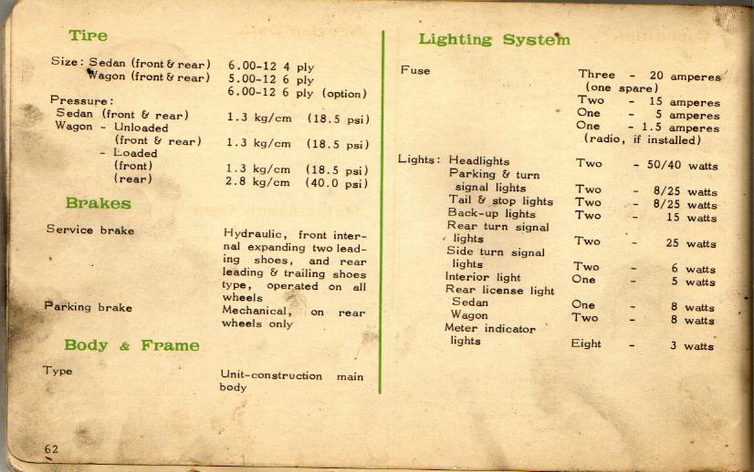

The original ke10 tyres were 6.00-12 which equates to 155/80/12. A 185/60/13 has an identical rolling diameter.
Page from ke10 driver handbook:
really? if so that's good because I might be able to get away with 205/60r13 tyres on my 13x7 wheels.
205/60R13 is higher rolling diameter than 155/80R12, off the top of my head, could be late-night syndrome.
