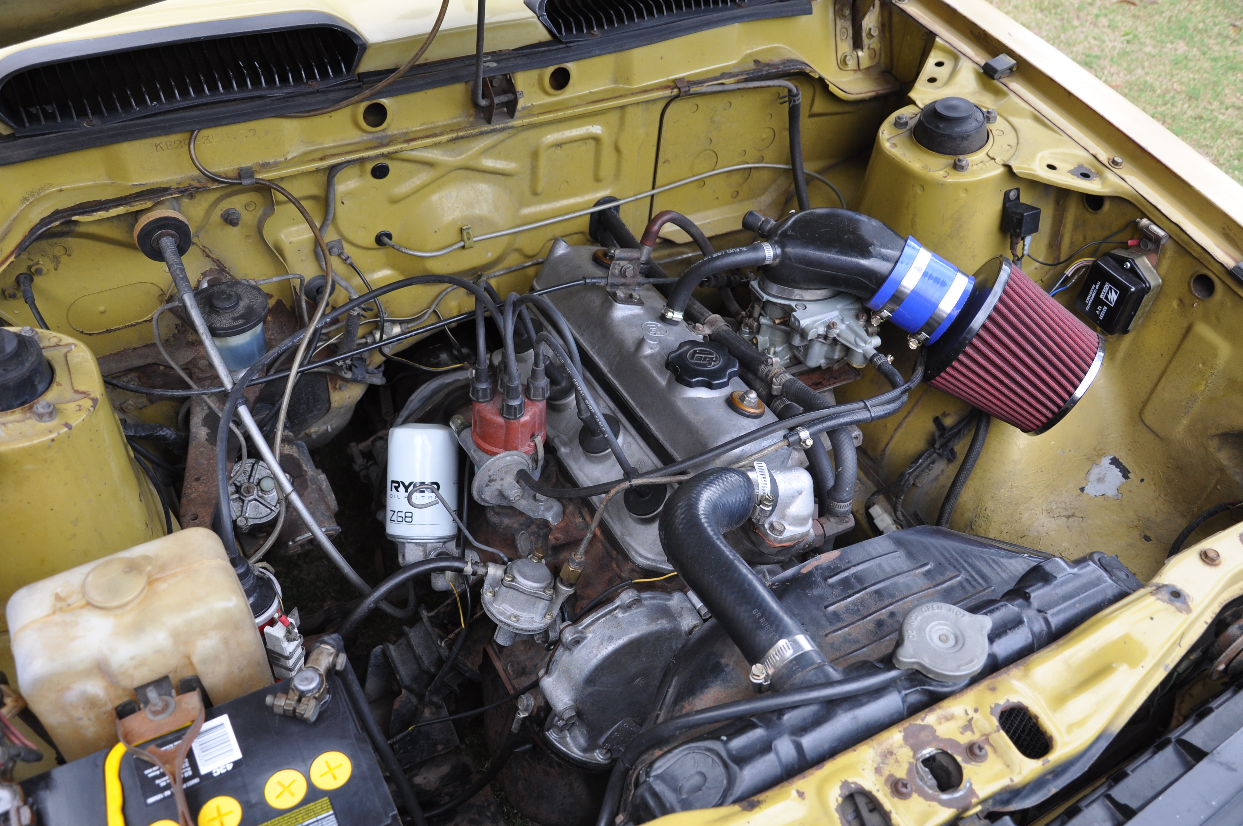

finally got my ke25 :laff:
heres some pics
it has a lot of slack at neutral in the steering box, has anybody done a recondition or replacement of steering boxes how much work is it and how much does it cost?
