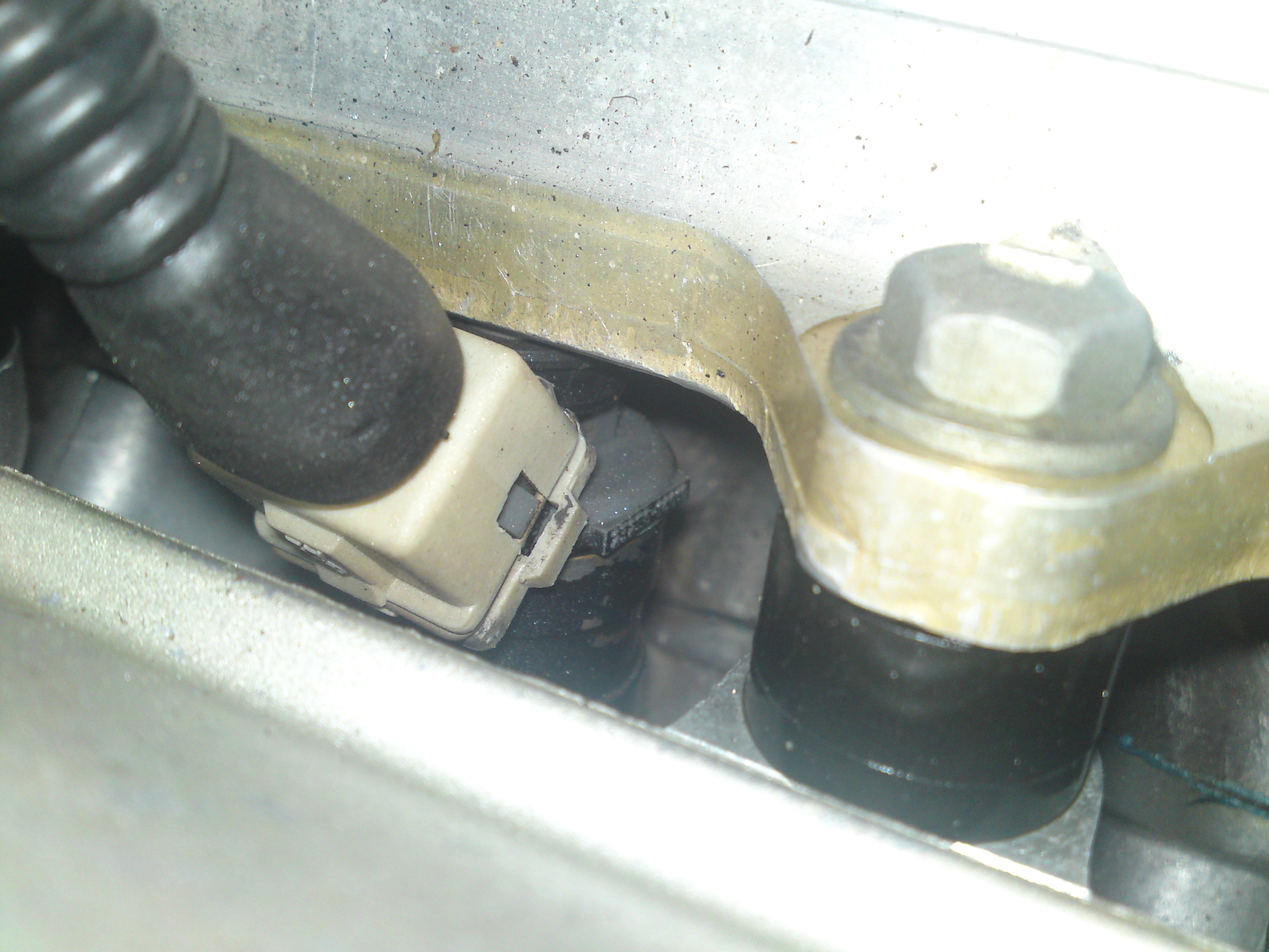

They're definitely grey injectors, just go off the top part. The pink ones have a round type denso plug not a bosch one like those.
Ok, just done a little more research on injectors. If the pink ones are a different plug, what about the blue ones? They are only slightly higer impeadence, 2.4 ohm and 210 cc. and they have the same plug that i already have. I guess it would only be as good as what the ECU is sending out though
I keep forgetting they are grey on top, Might start calling the pink tops in the mrs car chrome injectors.
See how you go finding those injectors. I wonder if the 3SFE camry ones might be worth a look. It isn't much of a drama swapping plugs either. You can also get short plugs that adapt the connector too.

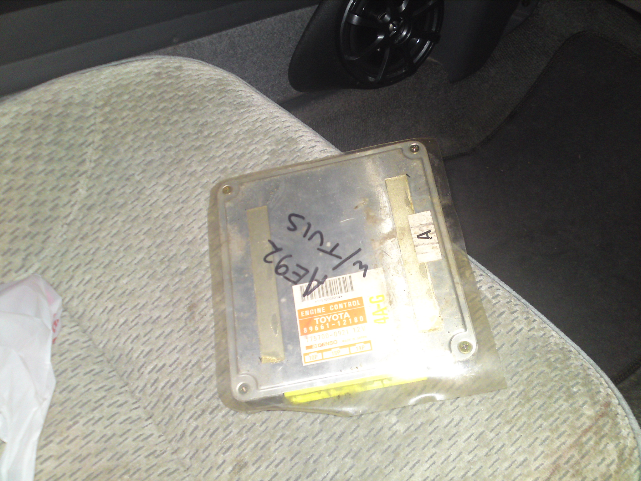

Well, look what i bought today :)
Bought it from a toyota wrecker that deals with a fair few JDM cars
He didn't have a ae82 one but one from a ae92, He said its was still a 4age 16v Bigport with TVIS so hopefully all good :)
He said it shouldn't be a prob but just incase, open the top of both ecu's and check the pin out connectors :P

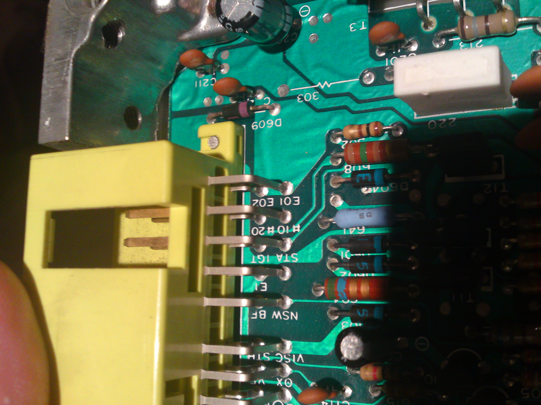

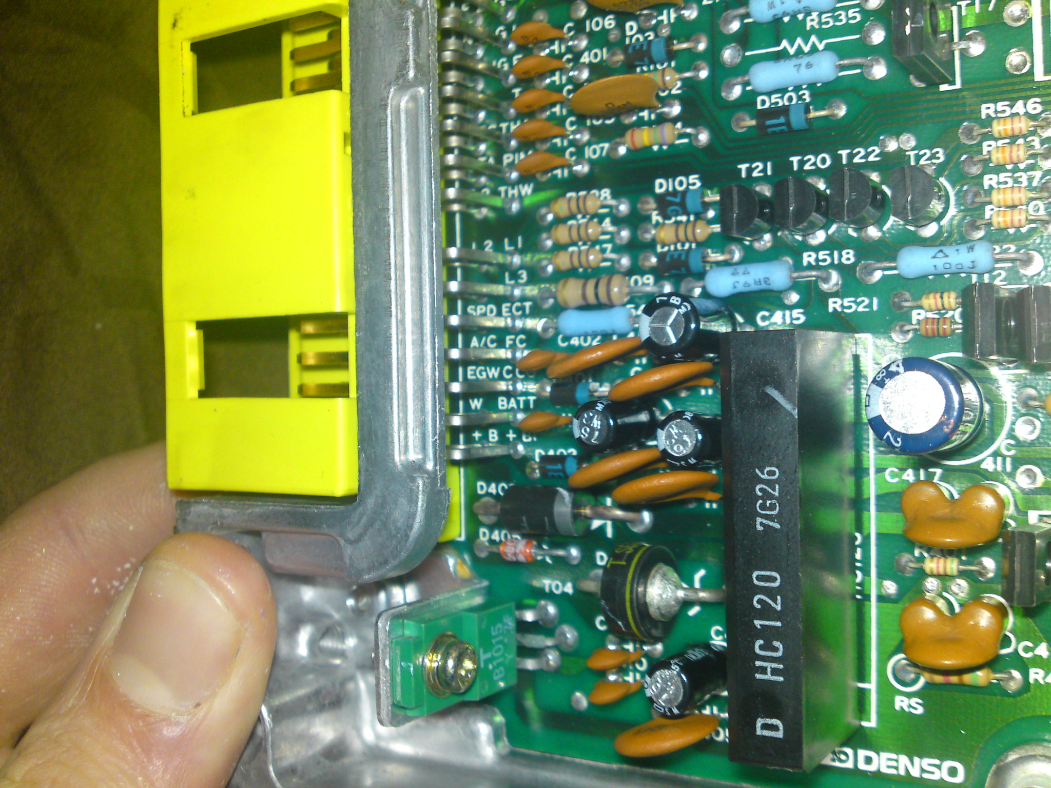

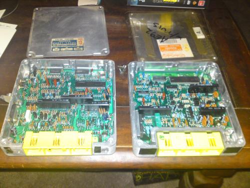

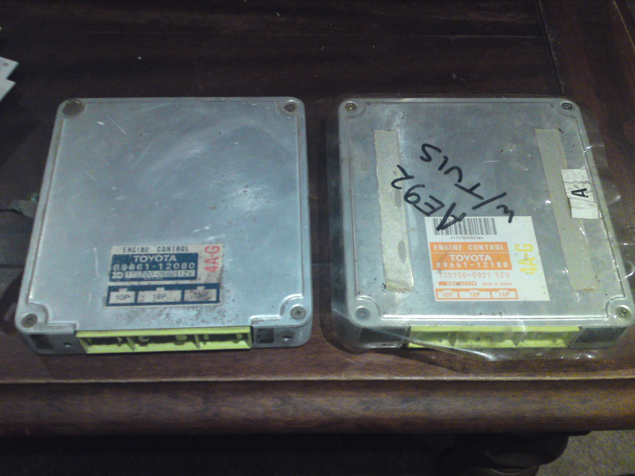

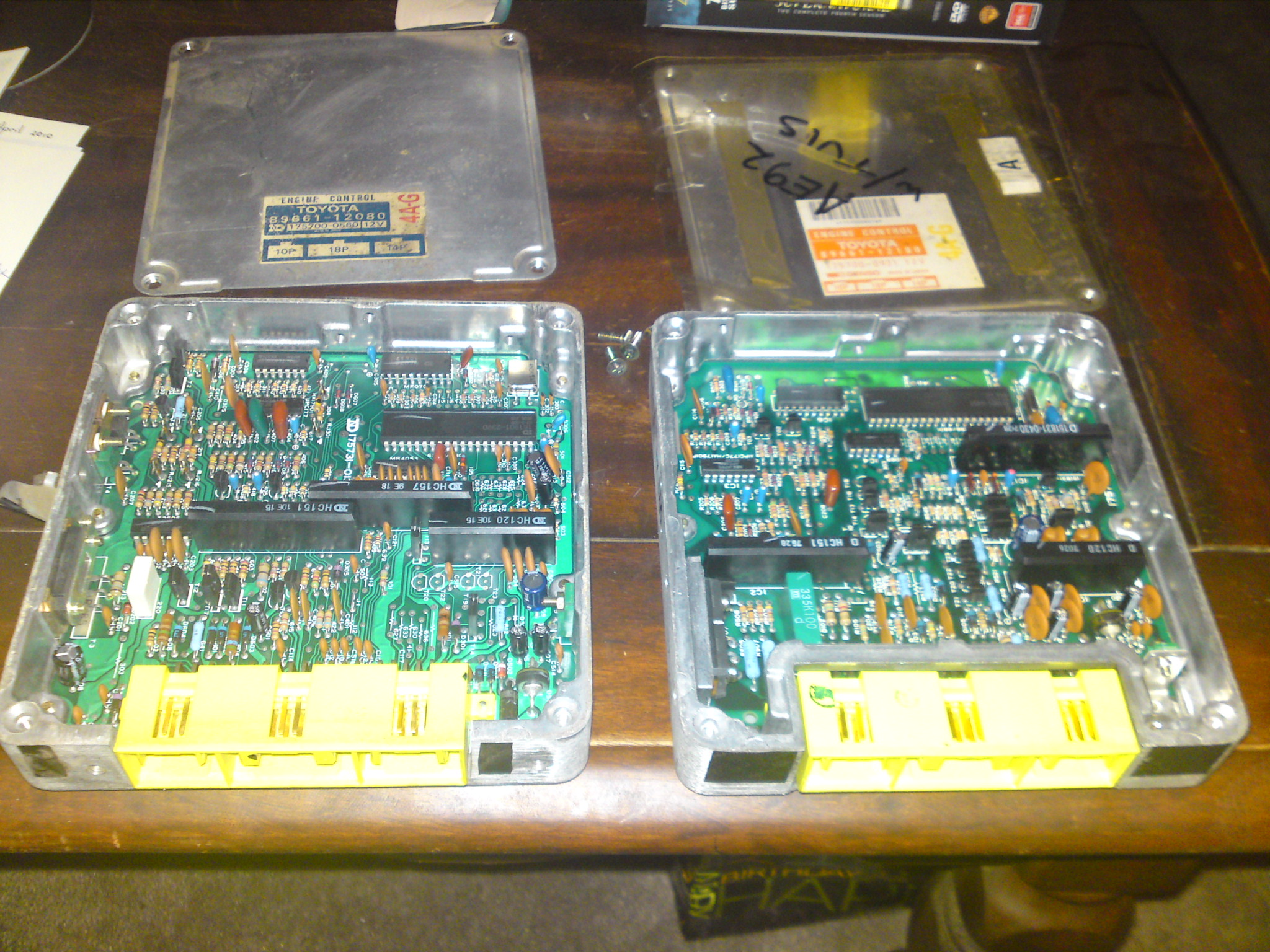

Ok, Here they are, the side by side, ADM vs JDM ecu pics
ADM is Left - JDM is right

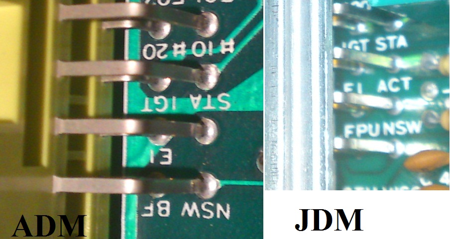

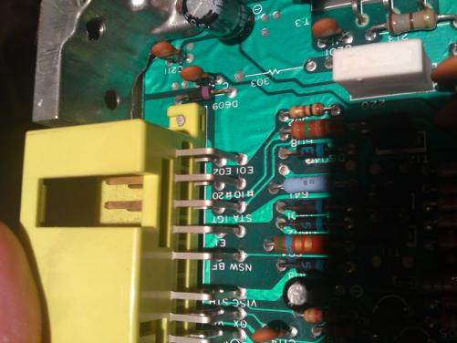

Here's a close up of the 10p pins that don't match up, only 2 out of all
This is the ADM one

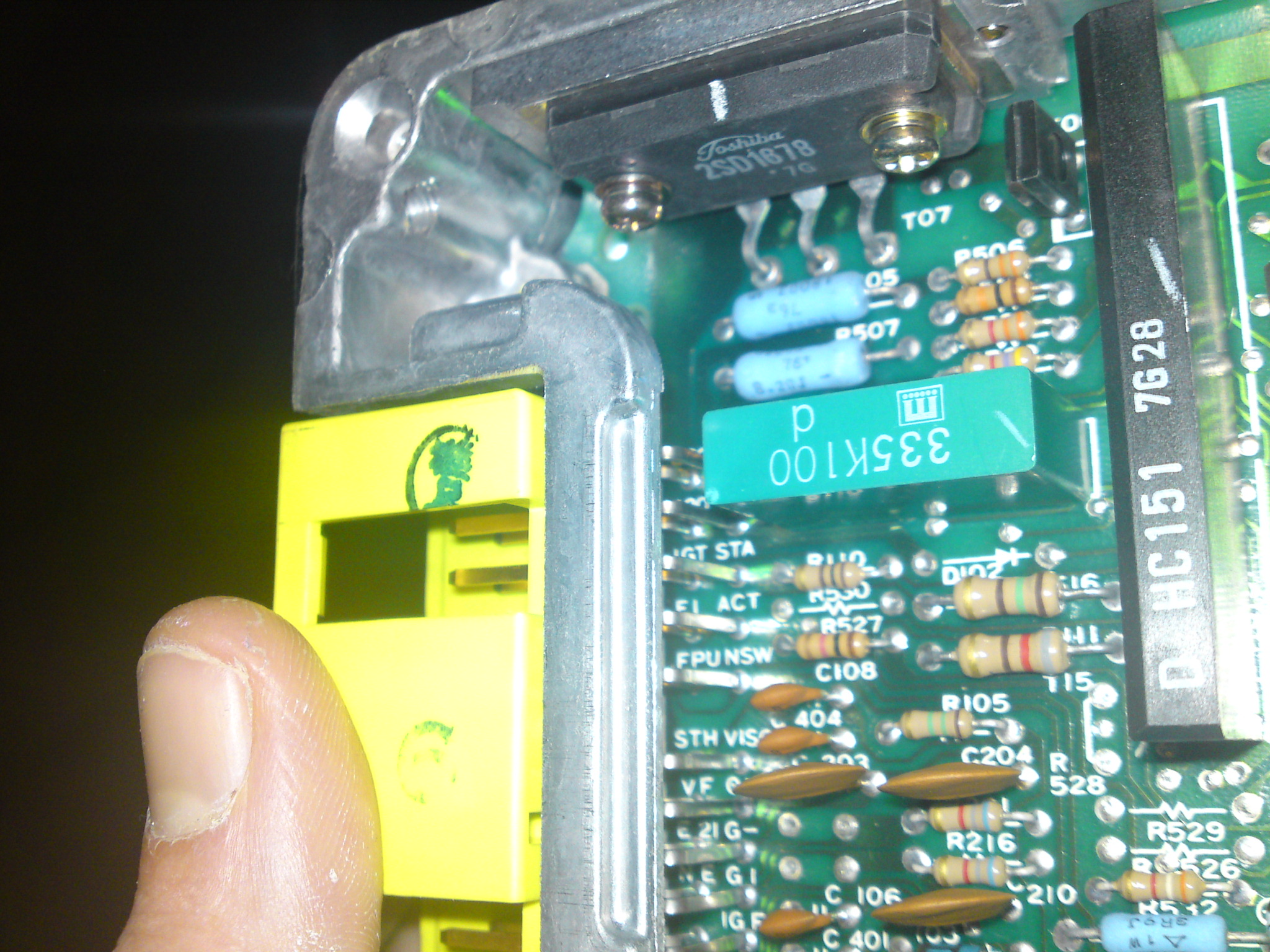

this is the JDM one
So heres the problem,
The adm ecu has nothing writen on there while the jdm ecu has "ACT" and also where adm says "BF" the jdm says "FPU" Does anyone think this would be a problem? I wouldn't mind just plugging it in and go for a spin but you you recon i would do any damage? Sorry, I'm a noob when it comes to this kinda thing :)
Edited by Johno
BF is Injector +B
FPU is fuel pressure reg control.
You really needed to get an 86 ecu.

You need an AE86 JDM sprinter ECU for the uprated KW and rev cut, I'm honestly not sure if the AE92 one you have there is the same deal. Plug it in and see how it goes.
BTW I think the pins will match up, they're just printed underneath on one and on top on the other
