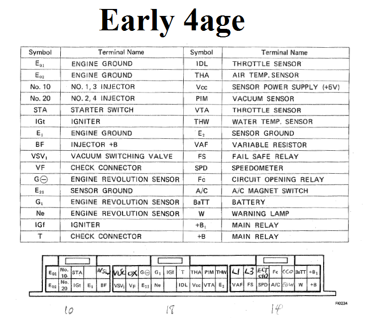

The smallport has a different ecu, a 28pin plug one, I got the bigport one.. 48 pin one Edit 42 pin
I had a small discussion about the ecu to the bloke who sold it to me and he said this is the exact same one that came out of late ae86 jdm corollas

I also checked, Your ECU is certainly a JDM AE92 unit:
http://www.romut-radalle.com/toyecu.php
89661-12180 AE92 JAP
Edited by Trev
:jamie: ok, at least we know what sort of ECU it is now, and its not matching a ae86 ecu so it's NOT a ae86 jdm ecu.
