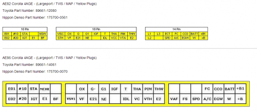

  • If you are talking about this one: AE86 Corolla 4AGE - (Largeport / TVIS / MAP / Yellow Plugs) Toyota Part Number: 89661-14061   That part number is definitely wrong. I checked on a certain unnam
