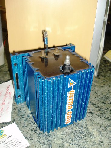

have you heard of the ultra coil by jacobs electronics as I've been given one and have never heard of it before, the car runs well and didn't want to disturb anything as I've only just got it back on the road and enjoying it, have a MSD 6al to go with it, its just the wiring but is it really going to be worth the hassle in gains over the electronic system now in use.

wow, thanks :bash: :bash: but has anyone tried or heard of the ultra coil by Jacobs electronics

If you read the specs....
.....and are capable of being driven by an inductive or capacitive discharge
ignition system....
This mean that they are not an equivalent of an MSD 6a or Crane Hi-6, but they can be used in conjuction with one.
Basically it just a high output coil.
I'll give it a whirl and see how they go together, thanks everyone, the information was extremely useful and helpful. :bash: :bash: :bash: :( :lolcry:
