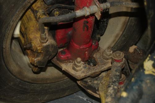

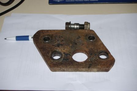

These are my camber tops. they didnt hit in the ke38 wagon they came out of, they hit in my ke30 but ive got em pretty close to the corner. The a noltec adjustable top.
Theres the springs, pretty sure there standard size. There ke55 struts with stiffer slightly lower springs in em.
And here they are in the car, sorry bou the tap over em, but you get you can see how far they get across.
