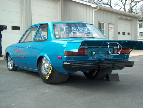

A little more than mini tubbed but you get the idea.
thanks mate just a little bigger than i was thinking. post-10770-1277615854.gif
