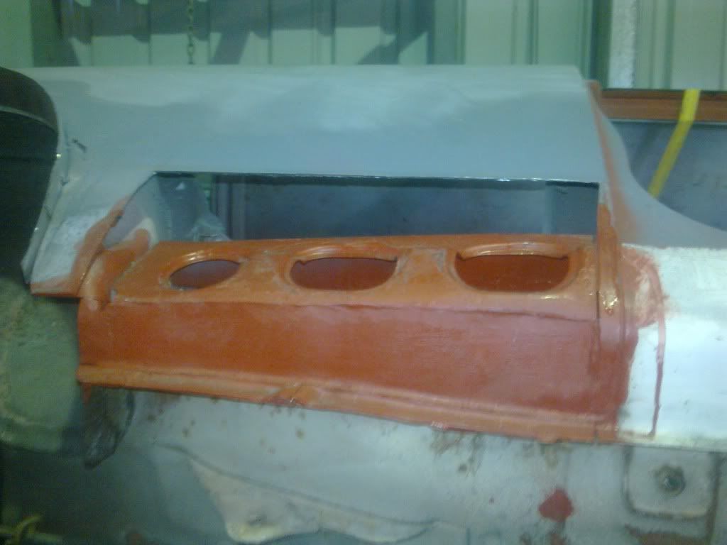

then on to the sill panel
rust..
and then since both layer were buggered i did the first inner layer.. rust conert and Red Brown primer..
as you can see the outer skin had rusted quite a ways up so to make things easier i cut it back to the body line.
and plated it back up.
still have to do the inner arche areas and the backing of the rear quarter.

protec red brown.. its an anti corrosion paint + adhesion promoter,, pretty sure the car is already coated with something similar from factory.
its so simple to use 1:1 with basecoat reducer and roll on.
