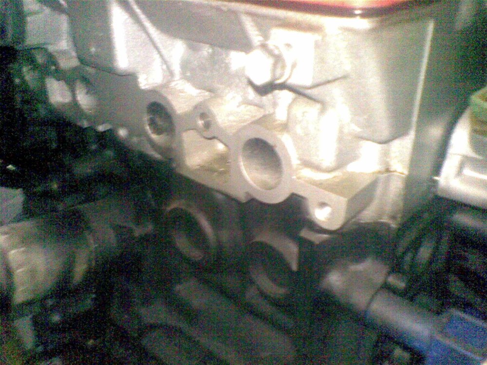

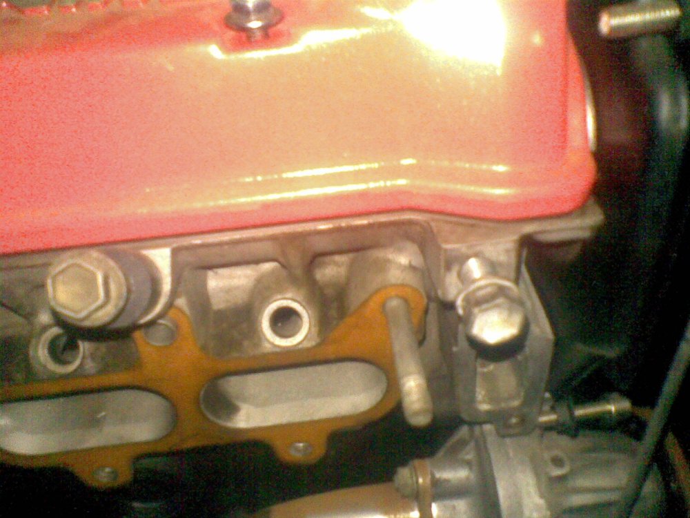

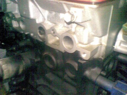

Trev Posted July 23, 2010 Author Report Share Posted July 23, 2010 Seems that you guys must be unaware of the 4age lifting hook spots so here are some pics... (where the bolts are) Quote Link to comment Share on other sites More sharing options...
cuzzo Posted July 23, 2010 Report Share Posted July 23, 2010 Yep and on my engine the previous owner decided the alloy section was to heavy and removed it by the methods suggested. Quote Link to comment Share on other sites More sharing options...
