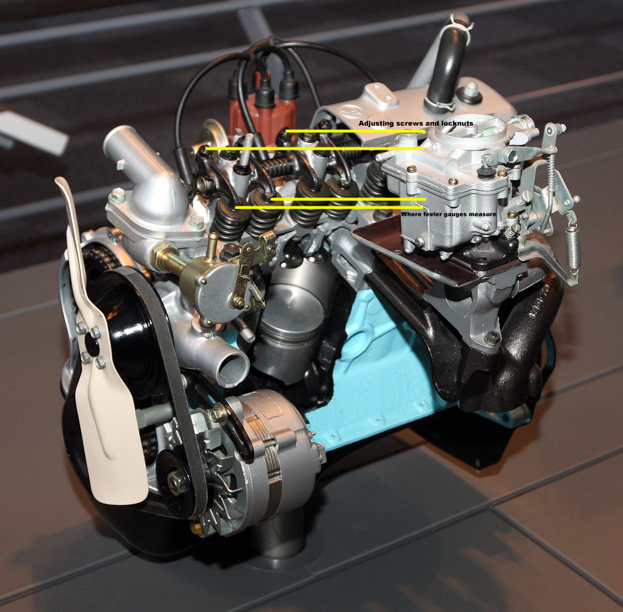

Here, this is a cutaway courtesy of Wiki, and I assume it came from the Toyota Museum.
You can see that the tappet cover on top of the motor has been cut away, but if you unbolted yours and lifted it off you would see the rocker shaft and all the rockers on it.
The feeler gauges measure the gap between the valve top by its valve spring, and the rocker that pushes it down. The adjustment is made by undoing the locknut and srewing the screw up or down a fraction.
I'll bet yours all need adjusting. If you don't try it yourself, have the mech check them after a compression test and before he does anything else.
