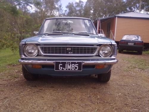

Corolla is home now and awaiting to roady and rego. Dad is thankful he's got his garage back after 16 months, so he can start his 1j-z powered '28 Ford. Cheers pa!
