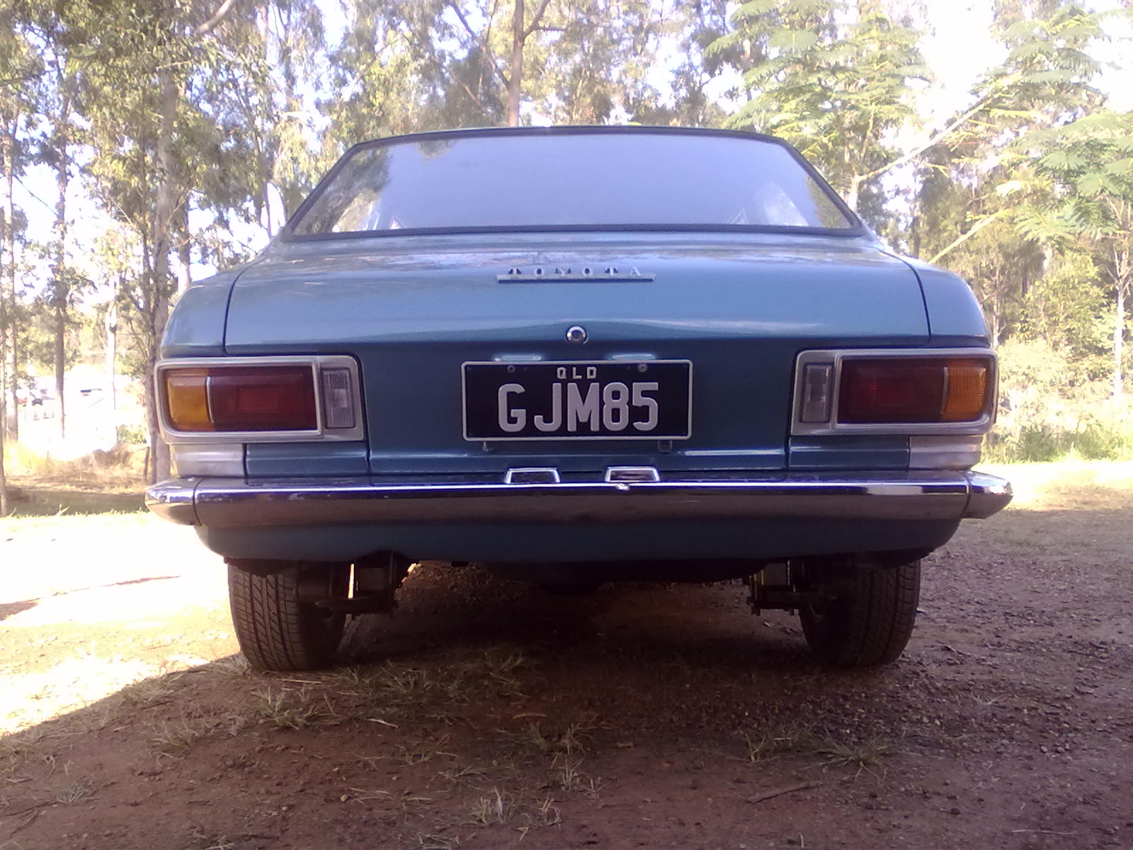

Today I tiedied up some wires and cables under the hood. Fitted a pcv setup, running into cylinder 1. Hooked up the old school Stewart and Warner 4" tacho. Battery clamp and squirty bottle. Customized the fuel breather. Centre console. Fitted the Toyota badge on the boot. Prepped the door cards so I just need some clips and then they can be trimmed. I painted a few things here and there. The wipers are ready as soon as I get blades. I want to make up a stainless steel heat shield for the sidedrafts, though.
Few more pics...

Not a great deal yet. Waiting on the tax return so I can finish this thing off. Otherwise just a few small things. I got a new indicator regulator. The steel brick one must have f@$ked out because I wasn't getting any flash. So a $12 Narva 2 pronged unit should hopefully fix that up.
I've decided to run with the Cheviot meshies from here on, purely because the 55 diff in the rear is 35mm wider than the standard ke20 diff. Couple that with the offset of the Superlites, my rear track hangs an inch out of the rear wheel arches and I know that will give me problem when it comes to road worthy and rego. So unless something changed the superlites will go up for sale soon maybe.
